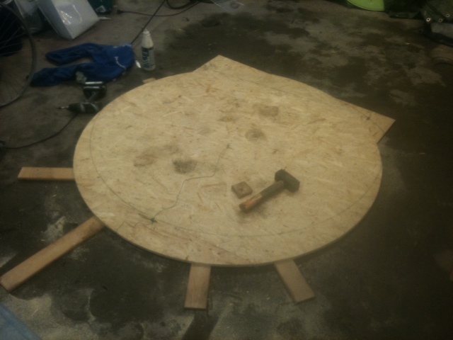

      Finally getting started .... just before i have to go offshore for work for 14 days
      I'm going for a almost 5 footer, or exactly 150 cm to be presice.
      2 of these with some spacing of wood. 150 cm should make a distance between magnets of 29,43 cm center-center. That should make some room for playing with different kind of spools, i hope.
      Erik

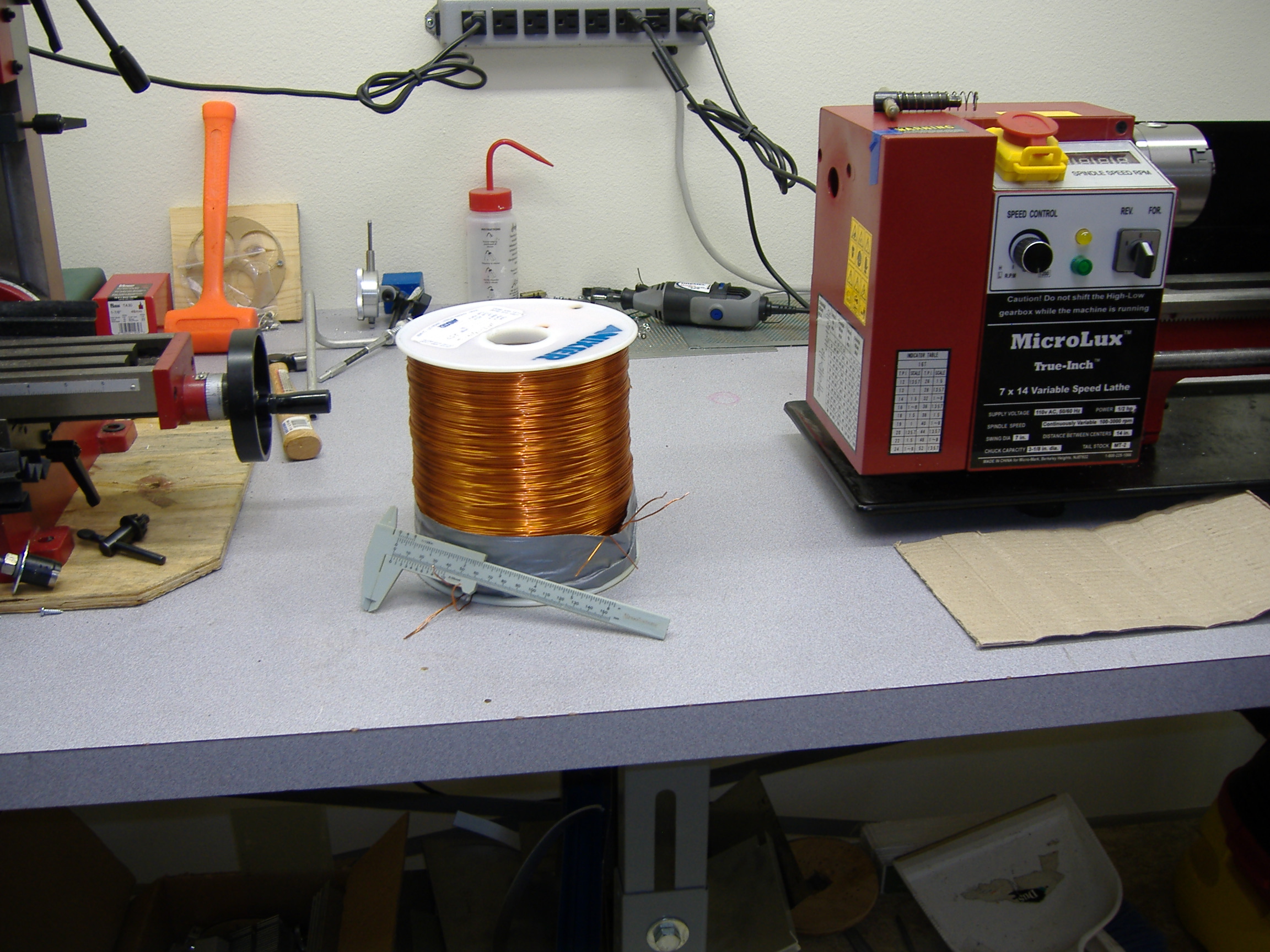

                                All windings in parallel = 2.0 ohms.
                                I found it convenient for winding to purchase 2 11 lb. reels of 18 Awg. and 2 11 lb. reels of 21 Awg.
                                Center coil reel measures 6.25" tall x 6.25" wide
                                Slave coil reels measure 3" tall x 6.25" wide.
                                I enlarged the center hole of the reels to 1 11/16" (43mm) diameter for the R60 welding rod core.
                                Hope this is useful. Ron.
