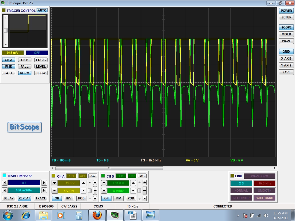

                          • Scaler Switching
                            the big difference I see in this scope shot is that the coils are now shooting up much higher when fired. No Idea why that would be.
                            Also I tried an experiment:
                            I wasn't sure the neos I eas using on the back of the ceramics were strong enough so I added another small neo on top of the neo on top of the ceramic...
                            Anyway the input current draw went up quite a bit. It seems like JB said if you pull the north's to much then you will begin to draw to much current.
                            anyway that's where I am at until I get more parts. Hope it is helpful.
                            Les
                            • Sorry was out of bandwidth so I deleted an older picture of my machine.
                              Here is the scope shot...
                              Les

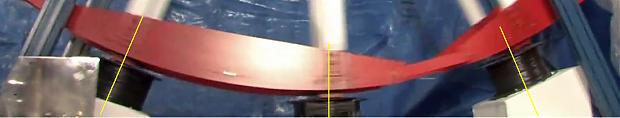

                              • Coil location
                                Thanks Les!
                                I have been analyzing his drawing, other posts and the video and I hate to say it, but I am still confused. Jerdee also has a drawing on post 198. In JB's DVD of the behind the scenes before the conference, he explicitly says that the left coil is closer to the main coil than the right coil. All the posts suggest the opposite. I have attached a picture of a still shot from a video clip that was posted on YouTube from the DVD. The perspective is not straight on, but to me, it appears that when the left coil is TDC, the main coil is is left of TDC and the right coil is right of TDC (although 2-dimensionally it looks like the right coil is left of TDC), which would coincide with what JB tells the lady about the left coil being closer to the main coil than the right coil. I realize it's not that big of a deal and our "sweet spot" probably won't be the same anyway, but it would be really nice to be able to match JB's setup (and performance)!
                                Thanks,
                                Scott
                                EDIT: Forum resized the picture. Here is the link to the full size image: Coil Lineup
                                Originally posted by Les_K View Post
                                Scott,
                                In post #68 on page 3 is a picture Jerdee drew of the alighnment.
                                1/8th on the right 1/2 on center and 1/4 left. all referenced to the same side of the magnets. the picture says it better..... Thanks Jerdee!
                                For when you are ready. That is what I used.
                                Les
