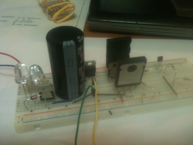

Scott,
Put a NE2 neon on the collector of the 94, then to a 5.6K resistor to Gnd
Put a NE2 neon on the collector of the 93, then to a 5.6K resistor to Pos
This will help keep the spike from killing the trannys, the same way you do with a Large SSG using the 94's...........
when you get them installed, and they glow or blink while running, than you are saving your Trannys........
It may be time to abandon the Bread Board and do a hard soldered up circuit, so that the connections between the Transistors and FWBR or Diodes is shortest, and fat.....
RS
RS
