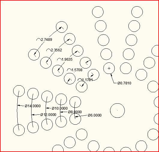

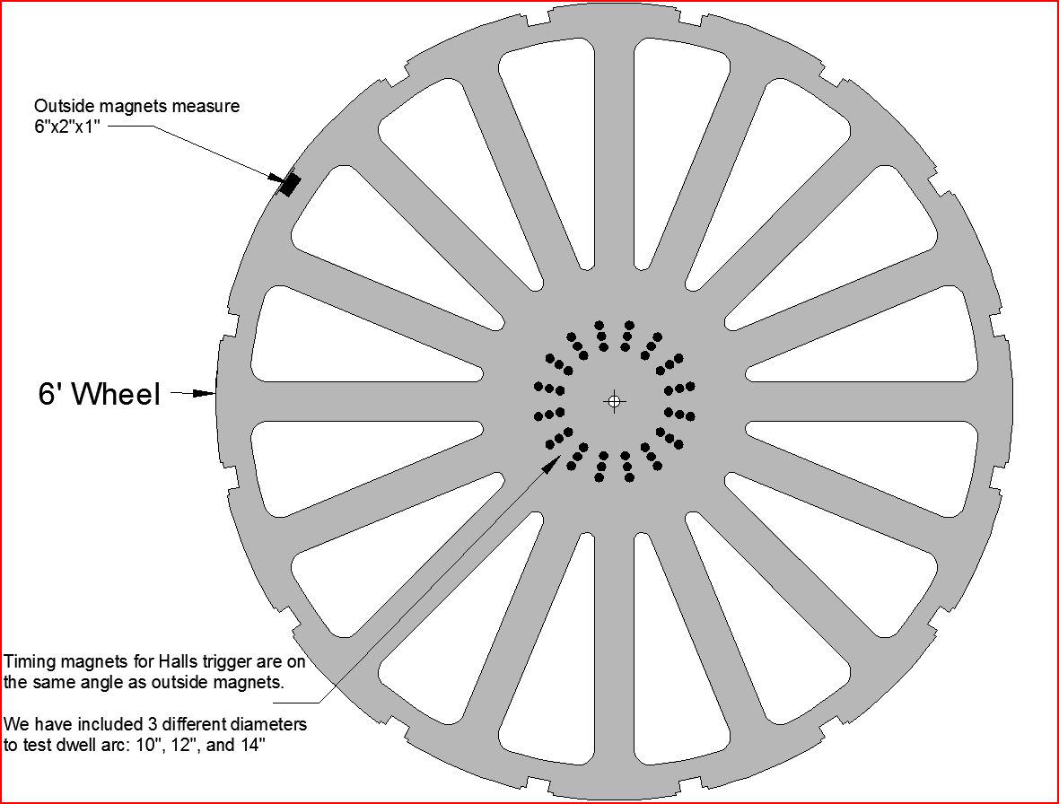

    Hello All!
    First time poster, long time lurker. Went to the conference in Nov and was blown away. I am anxious for July, but have a lot to do before then. I have thoroughly enjoyed this thread and am learning a lot. My friend, Brent, and I have started engineering our mini BFW and I just had a few questions. We are finishing up some CAD work on the wheel design and wanted to incorporate the magnet placement for the Halls timing onto the one of the main wheels. We are unsure about the dwell arc for the timing. It's a 6 foot wheel and have designed three different diameters for the timing magnets placement: 10", 12" and 14". The magnets we are going to use are about .78" in diameter
    @ John Bedini
    Is there a certain size ratio or is the dwell arc dependent on the rest of the system?
    Just wanted to see if I could get any clarity before we send the acrylic to get cut. I guess if it isn't perfect, we can always add a separate timing wheel to the shaft. We are eager to "just build it"!
    Thanks,
    Scott
    Edit: I have added a picture which includes two more diameters for the timing magnets. The picture shows the diameters for the timing magnets and their corresponding "dwell arc" distance between each magnet (all measurements are in inches). Obviously, I don't want to lose any structural integrity on the wheel, so I would prefer not to machine all of these. Based on the picture, is there any diameter which could be preferable to another?

              • Hi Scott,
                Nice drawings!
                I haven't figured out the timing properly yet, but I would pay close attention of the pictures that have been posted of John B's timing wheel.
                The way I understand it, John B said the the fields overlap on the timing wheel. I have used 15mm diameter timing wheel magnets that are spaced 12mm apart. I feel that these are probably too big for a 4 foot wheel as I have had to adjust the hall switch so the dwell is very small, meaning only the bottom part of the magnet passes the hall.
                John K.

                    • @ John K.
                      Thanks John! I appreciate your assistance and input!
                      We are planning to get everything cut with a CNC machine so that we know all the angles and rotor magnet spacings are perfect. I was hoping to do the same for the timing wheel by incorporating it directly into the big rotor (It also saves some money for not having to pay for extra machining and material for a separate timing wheel!), but from your last post, I am beginning to think that I should leave all the holes to test, with the hopes that one of them will work out nicely. Our timing wheel magnets are about 20mm and we have 5 options for spacing: 30mm, 40mm, 50mm, 60mm, and 70mm (center to center on the arc).
                      I am glad to see you got your timing better! Loved your video and hoping to see your S1GT in action some more. If you have any more tips on the timing wheel, I would love to hear them. Chances of us getting the machining done before the new year is slim, but we are excited the ball is rolling!
                      Thanks,
                      Scott
                      @ LutherG - I read your PM and have responded to you
