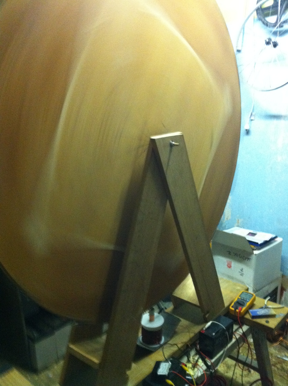

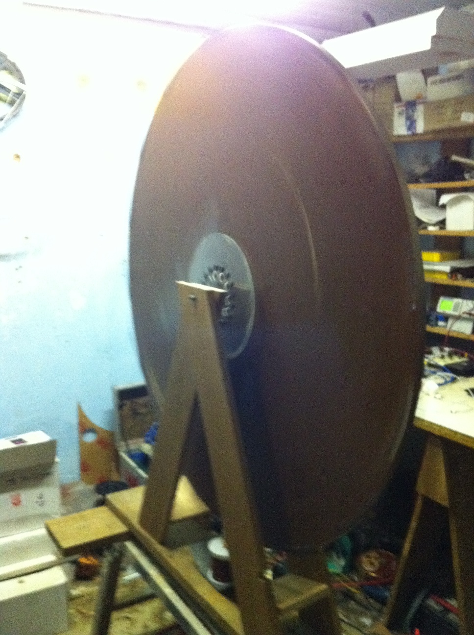

    Hi All,
    Well, I have my 4' "S1GT" running.
    It is only running off a 12V 7Ah gel "lab rat", draws about 750mA and speeds along at 34RPM.
    I couldn't get it to run off hall switching yet as the halls I bought were no good, so it's using the thinner windings on the main coil in series as a trigger. Luckily, some nice chap has posted some halls to me which should arrive before the weekend. (thanks ren )
    Not pulsing the cap yet either, just charging a secondary battery. It's another 12V 7Ah "lab rat", but it started at ~12.5V and is up to 14.2V after about 30 minutes.
    The rotor is a bit wonky and out of balance a bit, so it needs some work.
    Lots of work still to do, but at least it is a start. A couple of pics attached...
    John K.

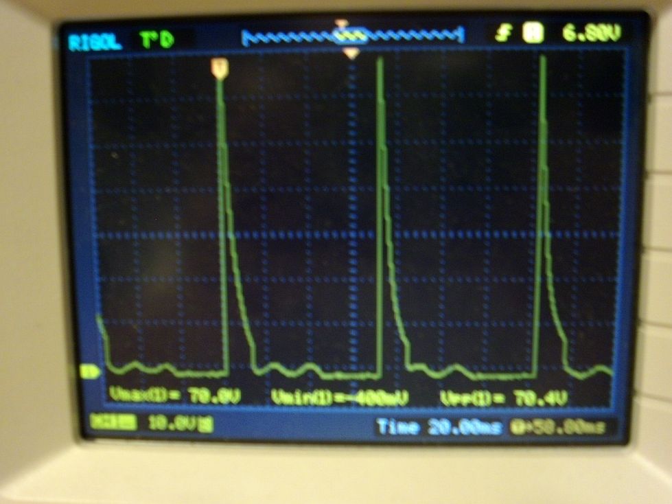

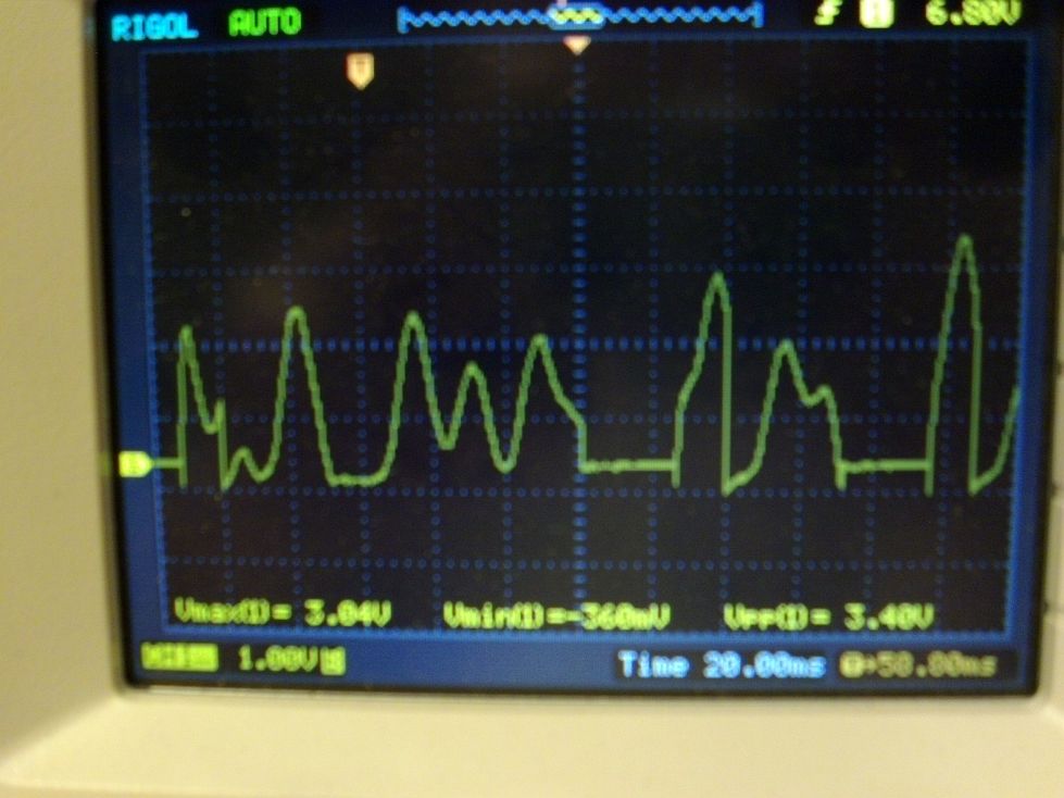

            • Interesting Observation
              I first got this new monopole running on a SG circuit with the trigger winding. The axle is north and south. The center axle showed a strong south pole, a compass would spin around and point to it from aprox 16" away.
              With the B/C circuit the compass has to be right up to it to get a small deflection and will not point to it even when right next to it.
              Scope shots across c-e of the upper and lower transistors are very different.
              Upper has a spike larger than the input bat voltage and output bat volt combined.
              Lower quite different.
              Mike Klimesh
              Live to experiment, Experiment to live (+_+)

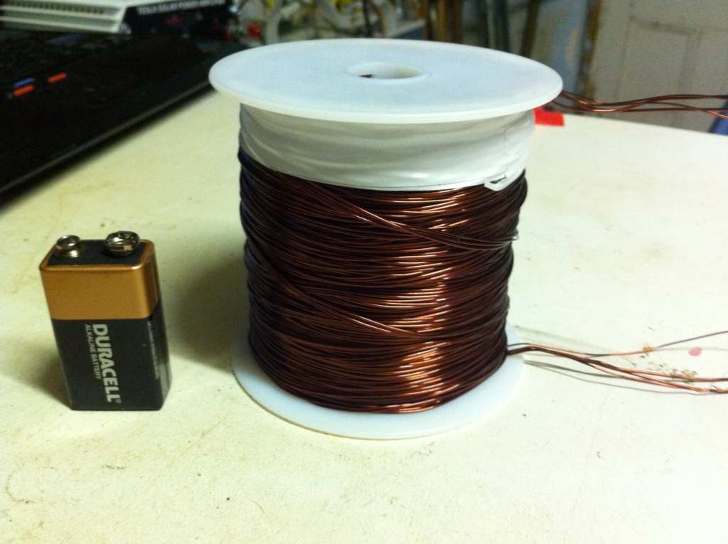

                  • Coil size
                    Originally posted by John_Bedini View Post
                    John K,
                    How big is your coil ? what is the Z in DC Ohms?
                    John B
                    Hi John B,
                    It's a standard 3" Pittsfiled spool from Rick. (pic attached)
                    It has 2 x #21 and 2 x #24. From memory, it was 4.6 ohms and 6.5 ohms but I will measure the Z when I get home tonight to be sure and let you know.
                    John K.
                    http://teslagenx.com

                      • Bedini GT3
                        Mike,
                        Explain a little more of what your doing here, Let me see across the switch where you should have put the diode bridge. Or if you did not hook it up and run the wires back to the primary battery and lets see the scope shot, that will tell everything. I'm looking for a different wave form then what your showing. It looks like your overshooting the devices.
                        John B
