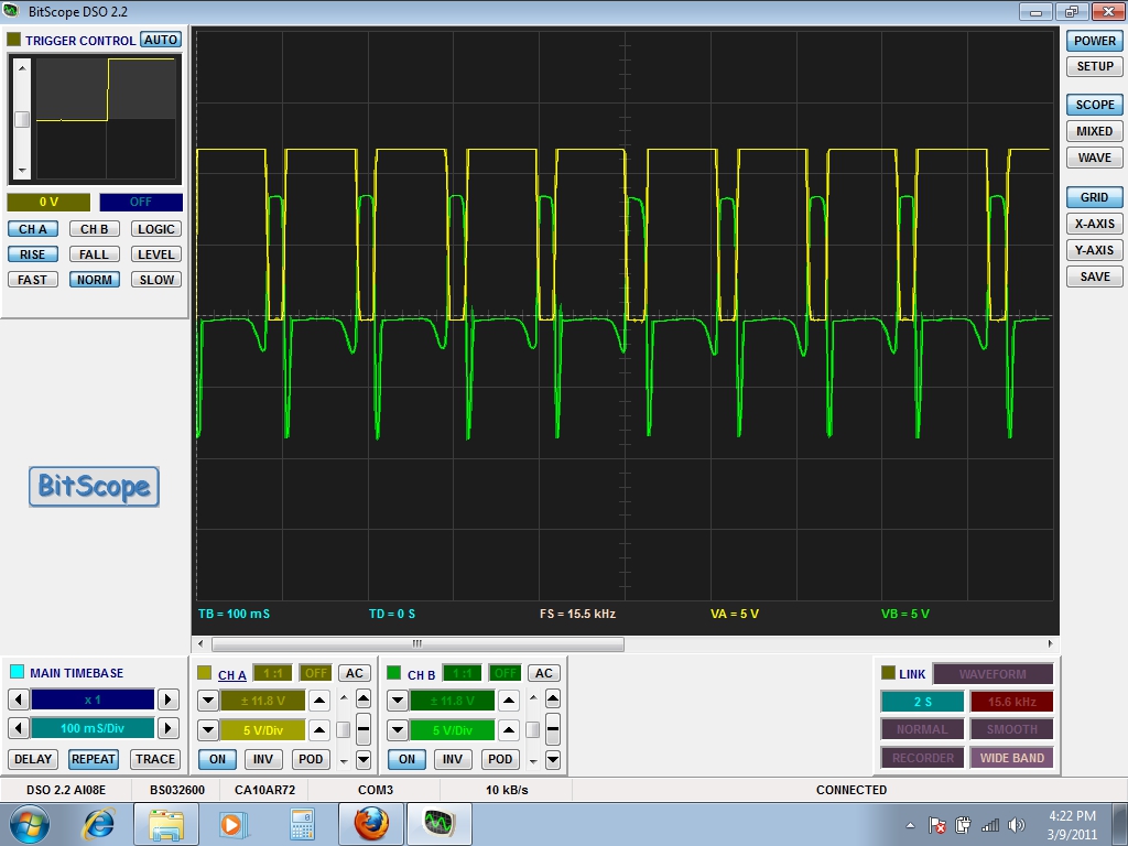

            Here is my latest change.
            I removed the timing wheel with the magnets and replaced it with an optical switch.
            I did not change anything to the circuit, but I think I will replace the 15v zener and
            resistor to a better match for the switch.
            The timing wheel has a 1/8 inch gap and you can see the scope shot and the milli
            amps in the videos.
            This has worked well for my set up because the wheel is slighty out of round.
            Very slighty, but since the halls are so sensitive to any miss-alignment it caused
            a fluctuation in the out put.
            I will also play with the gap of the timing wheel. I think I will try a 1/16 inch gap next.
            Also a note that I can not get this to self start with 12v. Only when at 24v.
            Mark
            YouTube - GT3 v2 22.2gp
            YouTube - GT3 v2 23.3gp

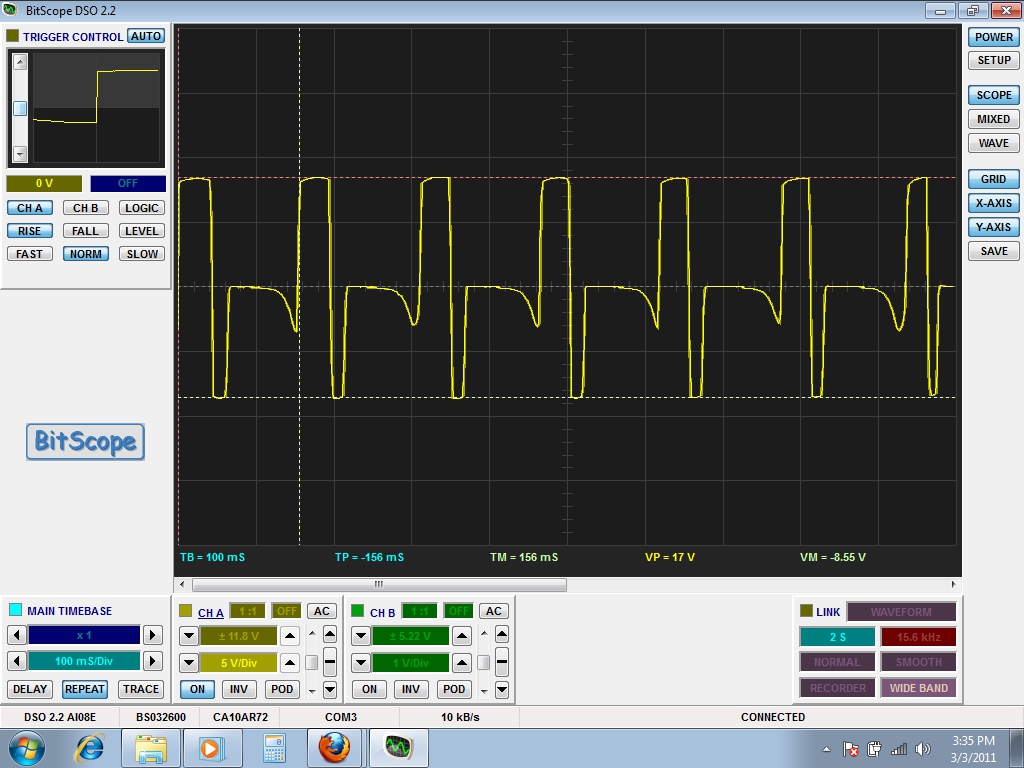

                    Finally got all my coils on and have been playing with timing.
                    Haven't got the cap pulser to work yet so still just running some lights..
                    But here is a scope shot of the timing. you can see the magnet pass (green) and then just as it is going down the circuit is fired. It shoots up and then you can see the spike coming off the back. The yellow is the hall switch. in relation to the circuit.
                    It self starts, rolls back a few inches and then kicks forward very nicely. I am only running at 12 volts for now until I can get some more MJL's in to match beta. I have tried changing the 220 resistor to 680 but it still warms up after a few minutes. since both transistors warm up the same they are a pretty good match.
                    Les
                    • Hi Les,
                      Looks great on the scope. I think the timing is pretty close.

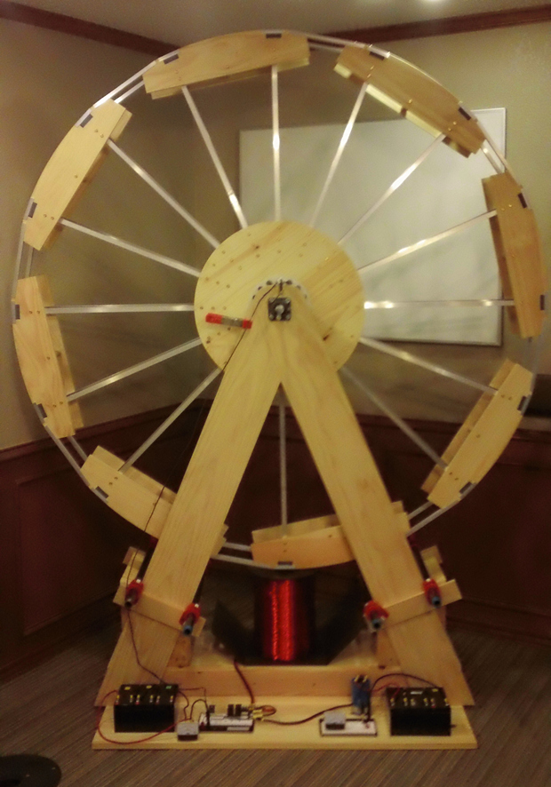

                            • "Junior" 1GT update
                              Hey Everyone!
                              Just wanted to post an update. We have separated the 3 circuits and gotten rid of the clip leads. We changes a few things as well and "think" we have it right. The paralleled transistors are still really cool, but we are having some timing issues and wanted to see if you guys had any ideas. The transistor for the hall is getting pretty warm. Not hot, but warm enough to warrant some questions. We have noticed that the timing of the hall is absolutely critical for everything. A couple of notes about that. We are using the south side of the magnets for the hall. I know we need to get some bigger timing magnets, maybe 1", and also have a bigger diameter. Any suggestions? It's taking roughly 15 seconds for the cap to charge up to about 77 V and dump, but it is dumping about 30 V. A far cry from from dumping 3 times per second. We are really eager to get the slaves done and finally get rid of those darn clamps.
                              Anyway, here is the video update!
                              If you guys have any suggestions, we are all ears! Thanks so much for all your help!
                              @John K,
                              Thanks for your suggestions. I am going to pick up some 10mm blue LEDS in the morning. We still have the circuit on breadboards, but I totally agree with everything you said! Once we have the circuit nailed down (We hope we don't have to wait until the conference), we will probably get a PCB done at PCBExpress.
                              Thanks,
                              Scott and Brent
                              EDIT: Wanted to post a picture of the setup.
