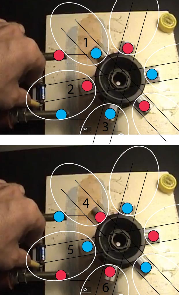

            The rotor turns ccw.There are 60 deg between magnets.The read switch is 23 deg after tdc from thr right side of the u coil.

            • Here is a breakdown of the video and magnet/switching as I understand it. I tried to show the flux as white ovals. The flux of 1 and 4 heading into the U and the flux of 2 and 5 heading out of the U and make the closest legs of the U opposite poles. At the same time the reed switch fires pulling 1, 2, 4, 5 to the U poles. The reed switch comes out of the 2 and 5 flux and turns off, killing the U pulling force and cogging. Then the next magnet comes into position 2 or 5 and we start all over again.
              rw

              • Visser, How do you get 60 degrees???
                There are 16 magnets on the big wheel, thats 22.5 degrees and as well on the
                timing wheel. There are ten poles on the small wheel with 5 timing magnets at
                72 degrees. If not I just built it wrong.
                I am just finishing the timing wheel and I made it to be able to time both in one wheel..

                      My answer was an attempt to answer the question (post 438) that John asked about the you tube video ,post 427.
