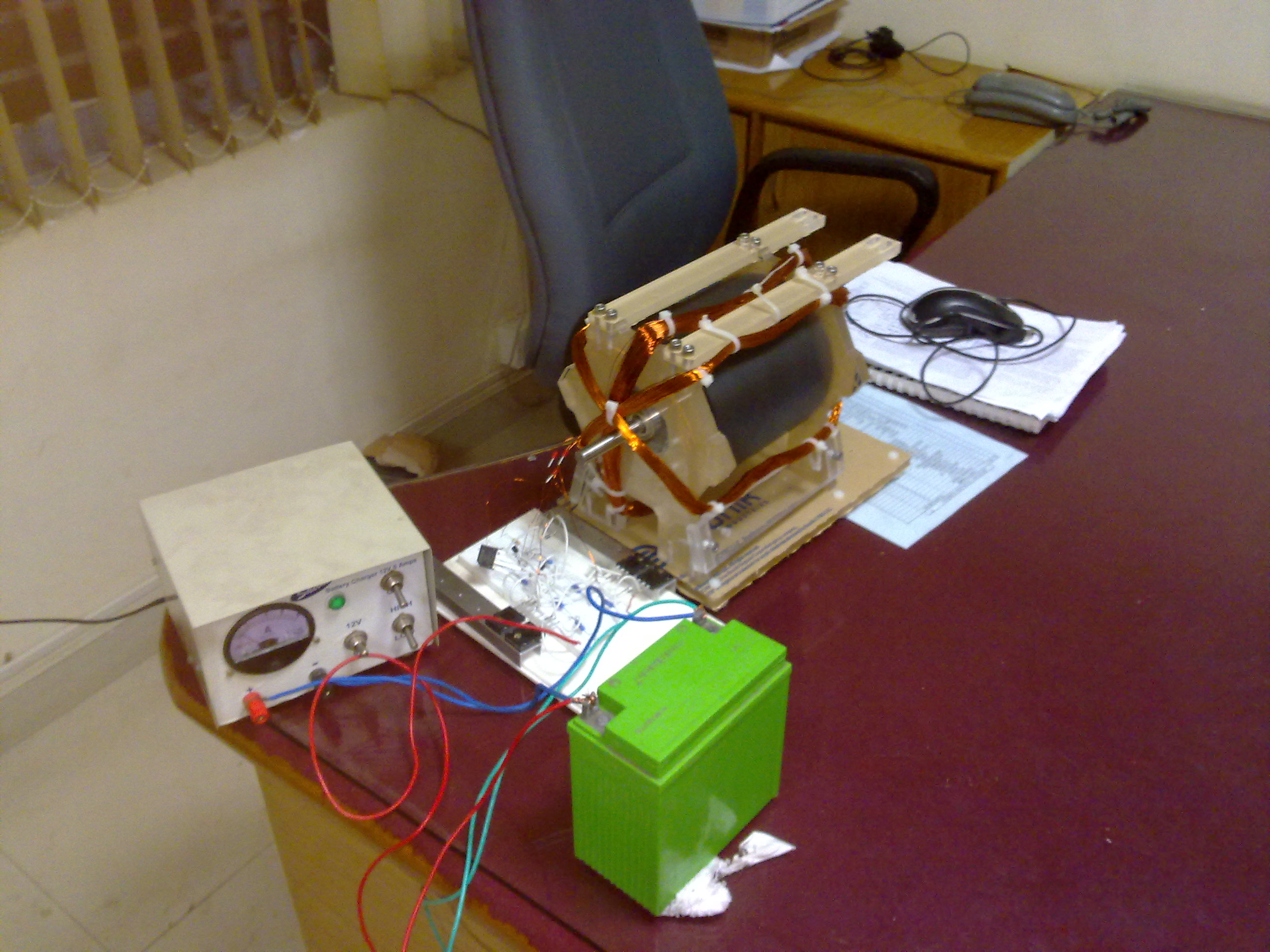

                    Got so inspired looking at your replications , i got myself the Window motor KitB to play with .Thanks for the tutorial !!! Got one full sequential bi-polar circuit connected to one motor winding ( has 2 small and one bigger wire ) going on 12V . Motor runs but can be stopped by hand on trying.
                    Now i have two more sets of windings ( secondary windings ) , but they seem to have only two ends each ie One secondary winding has 2 ends only .
                    I made my second full sequential bi polar circuit but cant figure out how to connect the 2 ends in a circuit which needs 6 ends .

                    I have attached a picture of my circuit replication running the motor ... I am just in process of putting a reed switch on the circuit and will post the pictures when i have them operational. I broke the one that came with the kit Damn them reed switches are fragile.

                    • Hi Bhargav,
                      Ok I see a problem with your setup.
                      Your coils arent aligned properly. You can see the recesses in the coil former where the wires should sit. I dont have one of these kits but from what I can see you should have all coils (stator) aligned to the magnets (rotor) at the same time. If this is the case then all coils can be timed to fire at the same time, thus only needing one set of trigger coils. By the look of it those coils could be wound a bit tighter too. This is the easiest method because it doesnt require a separate circuit for each power winding. You can join all coils together in parallel, as long as the polarity is correct. If it is not it will slow the rotor down. Each coil you connect should speed it up. You can parallel as many as you like within the same phase, within the ratings of the circuit.
                      If you want the coils to fire at different times (phasing) then each phase will need its own triggering method.

                        Secure those magnets now!
                        I can't tell from the picture, have you secured those magnets?
                        we thought we did a decent job for 5k RPM using wire and glue, ours flew off at 2k.
                        also, your motor will show nicely if you peal the paper off the Plexiglas
                        Patrick

                          Thanks for the alert .Have put in two part epoxy . Fairly confident on the epoxy to hold on but looking at the newer window motor video that surfaced a few days back on youtube , i will just put a 1.5 mm thk aluminium strap at the ends of magnets to be sure.
                          Well as you too have rick's kit , can you please point where to connect the trigger wires when using the reed switch/hall switch circuit . dont know if i can post the circuit here ??? The connection isnt shown in the circuit provided.
                          How do we effectively utilize the three circuits provided and the one primary coil ( has 6 ends ) and two secondary coils ( has 2 ends each ) ? My goal is to record the highest torque possible with the motor .Rick's instructions cd says we can utilize all three circuits for the coils provided but iam not able to understand how

                            • the reed and the hall do not require a trigger coil to work. they go in place of the trigger coil. you should have been sent a few extra small pnp's. use the 12volts from primary some resistors and the reed or hall to trigger the small pnp that will trigger the mpsA06 which will in turn trigger the mjl's. just as it shows in the schematic that was included in the kit labeled "pnp for hall/reed". I see you uploaded it to the Monopolemotor group.
                              seems complicated at first at least it did to us. I think we have the hang of it now.
                              try it out w/ one - half bi-polar ckt first.
                              we did not have epoxy, we used super glue and picture frame hanging wire. this all came apart at what we guess was somewhere between 2 and 4 K rpm .
                              Patrick
                              • you need a way to retain the magnets if you want to push it hard. It needs to be next to bulletproof, tapes or glues can only go so far. JB showed a window motorB, with stainless retaining plates I believe, that were bolted in. You could achieve a similar purpose with a stainless strap, or tube. The large square edge of the magnet will make things a little difficult for some approaches.
                                P'nS is on the money for the hall/reed thing. Check the schematic you've been given. The halls (and maybe the reed too?) require a pnp signal transistor in place of the mpsa06. Its easy to muddle up the configurations first time so do what Minoly says and build a half circuit (with the full circuit in mind eventually).
                                Trade the pnp, note some of the connections and resistance values may be different so trace every line. You probably need the right polarity of a passing magnet to trigger the hall, you will have to check the documentation. You could trigger it off the rotor itself, but a timing disc would be ideal. The Reed could be used in place of everything really, but it wouldnt last long. Im guessing that the reed could be placed in the trigger circuit directly, maybe even replacing the pnp/npn signal altogether. Or you could use it to trigger the pnp/npn signal transistor.
