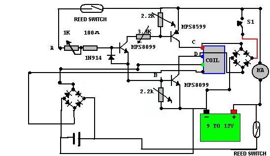

      @ Mart. The schematic is the half circuit that I was reffering to. You can find it here http://f1.grp.yahoofs.com/v1/YCuzSCV...iles/mcct1.jpg
      The 3k resistor is the one I am reffering to. Make it 220 ohms with a 2k pot to start with. If its too high you cant get it up to speed.
      Let me know if you need more info.

          With 3.3k the motor doesn't run but i put a 2k potentiometer here and i could regulate the trigger current in order to switch on PNP and NPN.
          I use an ST ELECTRONICS PNP MJ2955, and two motorola NPN 2N3055 , first i put mjl 21194 here but 2n3055 "junk" run better. I don't know why, but junkyard 2n3055 bipolar transistor performs better on my circuit.

                  Build a sg circuit with the mpsao6. Dont attach any coils. Make sure you check the pins, the middle one is the base! Be careful when soldering, its very small and easy to damage. Use 1n914 for the E-B diode and dont put any output diode on it. 100-500 ohm fixed resistor and a 1-5k pot
                  Next get a PNP (Darkwizard I used the same ones as you ) and wire the emitter to your positive power supply and or Cap. Also wire 470 ohm resistor between Emitter and base. For these T03 style casings its as simple as 470ohms across the two pins. You can experiment with different resistances here, but this will get it running. Now here comes the part that we are talking about which can alter your amperage up and down really well.
                  Wire a 220ohms resistor off the base of the PNP (you can add a 1-2k pot here for tweaking, but start it with low resistance) and then connect that to the COLLECTOR of the MPSAO6. The emitter of that then goes to the base of the complimentary NPN, no resistance necessary (though I have never tested anything here??).
                  Whatever configuration you have used for your PNP use also for the NPN. That is, 470 ohms on the PNP equals 470 ohms on the NPN. This is easy again for the T03, just wire it across the pins. The emitter goes to the negative of your circuits source.
                  The drive/power coil/s go between the collectors of the NPN and PNP, the signal MPS has the trigger coil hooked to the base/emitter in SG fashion. If you are using a superpole rotor (souths and norths) one polarity will pick up and fire on the norths, the other polarity will pick up and fire on the souths. You will need to inverse the power coil to match the trigger coil if you arent using the full circuit.
                  Bridge comes off the power coil, in this case just use one of the other collector terminals on your TO3's.
                  Im pretty confident you know how to build it Mart, so this is for anyone else who may be struggling to comprehend it.
