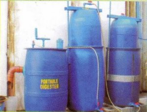

  • Animation of a simple telescoping biogas digester - YouTube
    Floating Drum Anaerobic Digester - YouTube
    I try to attach a photo of two telescopic drums for CH4 connected after the biodigester.
