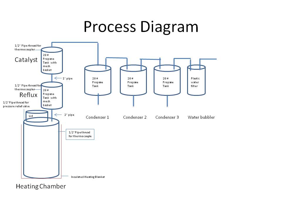

            • Reactor design questions
              Hello everyone. I have been following this thread for quite some time and I didn't want to post anything until I was about ready to build something. I just dropped all the supplies off at a local machine shop, but I am hoping someone can review my design and offer advice.
              Specifically, is the groove in the reactor lid necessary if I have proper gaskets? Graphite gaskets are supposed to be able to handle the high heats and I had success using a graphite gasket on a pressure cooker test.
              Also, as you can see in the diagram I attached, I have my lid on my cracking tank offset so that I don't have to remove pipes or anything to refill the reactor. The diameter of the cracking tank is 48 cm by 1 meter tall. The lid is going to be 25 cm in diameter. Is there an issue with that design?
              The cracking tank will be heated with a cloth heating jacket, everything else with band heaters. The reflux and catalyst tanks will have removable lids as well for access to the mesh baskets inside.
              This forum has been very informative and I appreciate any help you can provide! Thanks!
