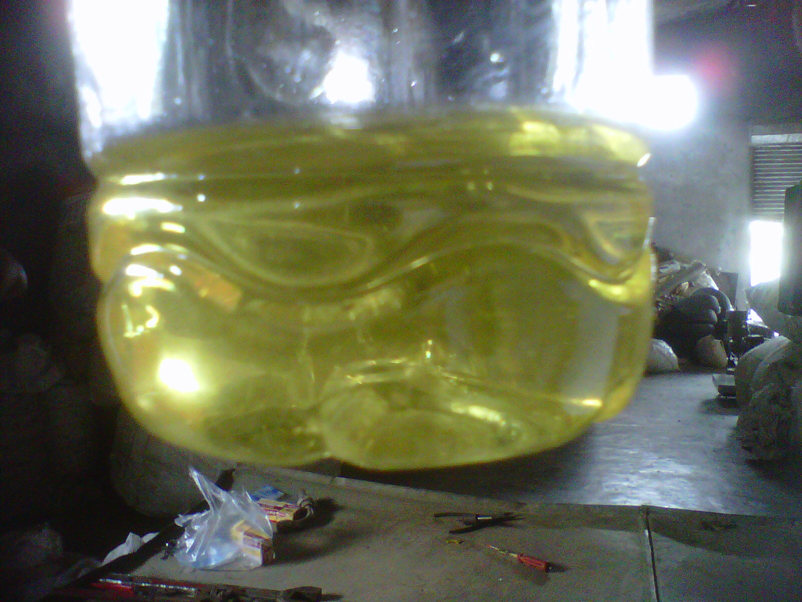

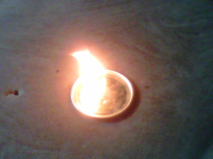

        • Sorry for the delay
          Actually I could not take any more trial with My Baby due to some problems, I have to move same day.
          My frnd informed they along with pale yellow gasoline there was deep wine color oil got collected in condensor vessel with was about half liter and about 1.5 kgs of material was left inside the reactor as I swicthed it off.
          so result are:
          about 1 lit of Gasoline (Pale Yellow) see Photo
          about 0.5 lit of Furnace Oil (Dep Wine Color)
          about 1.5 Kgs of material left behind.
          total feed material was about 5 kgs.
          total heating time about 8 hrs.
          max temp reached about 270 deg.
          material feed was PP-HDPE mix I dont know the ratio as it was scrap which was grinded.

              • Kris3033, it looks like you did not get to a high enough temperature. At 270C only the lightest most volatile vapours would make it to the condenser, hence the amount left in the reactor. try again at 380C and you will get higher yield and better fuel,

                  Thanks for the comment
                  yes I colud not reach the 380 temp as I didnt have time to insulate it properly and more over I thing my Heater rating was also low I used about 2 heaters of 1KW each. and Reflector chember was completly empty with out heating.
                  Next time I will try with all Insulations and good condensor set up.
