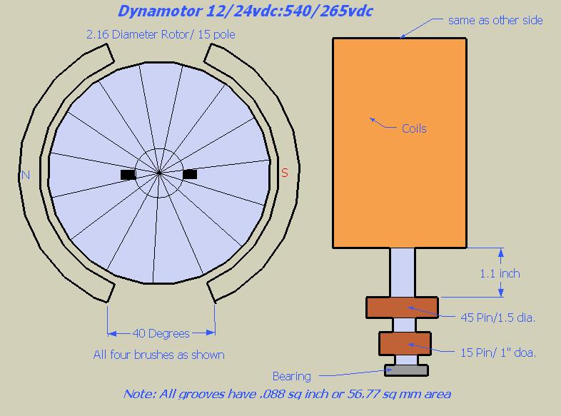

      I have been tossing about for days now as to what to do with this thing. I want it to be a good example of your technique. The original had motor coils of 20 gauge on the outside. Sixteen wires in each groove. With our winding method that would be about .1418 ohms per pair. Not good. If the power coils are on the outside, I must calculate enough space for them after the generator coils are on. Bifilar would be great but must move to smaller wire. Just for starters, roughly, what gauge motor wire would you start calculating for the motor side which will drive the other two coils well. I know this will just be a guess from your experience. Maybe just off the top of your mind, what would you do with this whole rotor? No, I cant stick it there. If you do have a guess, I will see if space allows. Thank You.
      Dana
      Hello Prochiro,
      I would, before thinking of wire gauge for your machine...make a diagram of the whole thing, just the bare cores at rotor and stators, if you could shut pictures of top view (with and without brushes on) So I can see the stators disposition related to groups of rotor poles then I could start drawing a CAD on this...
      I would think a mathematical way to wind this would be (as one of other possibilities):
      Motor : I would make it a Three Pole, Five Rotor Poles per Coil (3X5=15) and joining Five Commutator Elements to make it a Three Element Commutator.

        • Winding up a Dyno
          @UFO
          Here is a sketch of the setup. Is this enough to go on or would you need pictures or other info first.? This is my first attempt with sketchup.

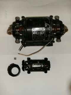

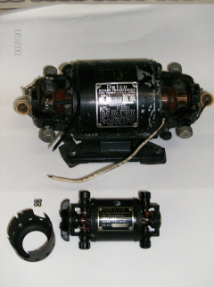

                              • Rotary transformers.
                                Hi all,
                                Pictures of the 2 rotary transformers, 1 Delco and the other is a Type 119, no company indicated.
                                Take care,
                                Michel
                                For larger pictures: Delco Rotary Transformer & Type 119 picture by MickeyMouse1950 - Photobucket & Delco Rotary Transformer & Type 119 picture by MickeyMouse1950 - Photobucket
