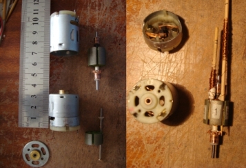

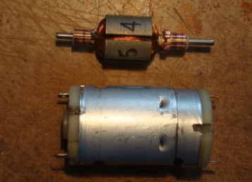

                          • Brilliant...Yes it was
                            it was brilliant...I just said..."lots of questions", but excellent ones!...
                            I saw your motors and your winding and work look great!...those motors look almost exactly to the Radio Shack ones...the 256 body type.
                            Now, I see you have modified the brushes positioning...and just reminding you that for the Dual Pentagons they go the way they came from factory...or like (- -)...
                            Ufopolitics
                            • sorry, in the pic I showed the stator before assembly, just put both pieces together to show the size.
                              regards
