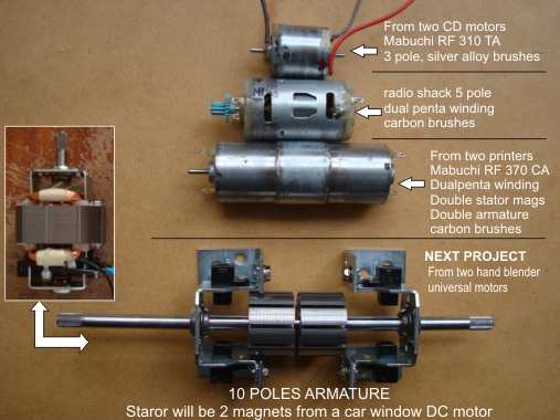

    I got a second hand one (1000W) for few bucks. I will post pics soon in order to evaluate its suitability.
    • i look foreward to some pictures of that JohnStone.
      i'd also like to try an 8x fully independant brush, 4 magnet and at least 12 pole machine next.
      i'm finding the washing machine motors a massive pain to strip.
      the second (third and fourth) armatures are going to require something like a dremel just to start clearing the wiring off the armature :-/ ...and that i don't have.
      the PM DC motors are far easier to work with it seems and Ufopolitics has said 4 brush as donor motors are better than 2 brush so thats next for me.
      good luck with yours there.
      also with a scooter motor a fun test would be to see if the same charged batteries can get one further up a hill with an assymetric machine compared to a standard motor
