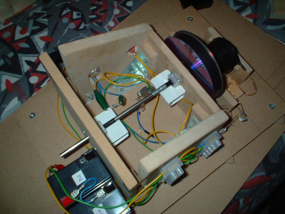

                      • Hello, I'd just like to thank everyone who contributed to this discussion and shared their problems and solutions and experiments.
                        I just got my first SSG running 3 weeks ago. It didn't seem to want to run for very long the first few tries, I could hear it running but then it just ran out of power and came to a stop, so after concentrating on listening so hard for a while I begun to wonder whether I was just imagining it or not. Anyway, after some fiddling (don't ask me what, I did nothing in particular just poked around with my fingers) {[edit] I had a 430 ohm resistor but it preferred the 680, also what I believed to be 'low' on the potentiometer was in fact 'high'} and readjusting the distance of the coil from the magnets, it started keeping itself going for longer periods each time, although it wasn't able to increase its own speed. I believe this was due to using 8 x AA batteries in an unheated shed when the temperature outside was about -5 Celsius, so the batteries just weren't able to power it. After taking it into the (warmer) house, it seemed to come to life.
                        I since realised I wound the coil the wrong way and I had a south pole at the top, because I had not considered the electro magnet aspect of the thing until after I had made it. I swapped the wires, and what was a slightly noisy and lukewarm coil became quiet and cool. The maximum draw is 200mA @ 680 ohms and minimum is about 45mA if I remember correctly @ 1,680 ohms. It successfully charges batteries, which I have been using to charge/power my wind-up LED lantern via the 12v car adaptor and light the room. I used 2500mAh to charge 4.5Ah, then used the 4.5Ah bank to charge a 9Ah bank. But I haven't begun with the load tests on these bigger lead-acid batteries yet.
                        All is well so far, except it seems I need to get an inverter and a transformer so I can run the SSG from batteries I charged through the SSG. I already have plans for future projects, and I'm just about to finish putting together a contraption I devised for making/litzing coils. The first coil was all twisted by hand and was not a pleasant experience, it seemed easier in my head than when it came to actually doing it So this contraption will allow me to put up to 6 wire spools to be twisted together (I won't be using 6, it's just easier to build that way than making it 5) by turning one handle, and then another handle to wind them in onto the coil spool. Or so I hope it will work.

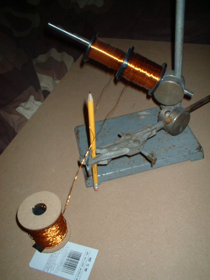

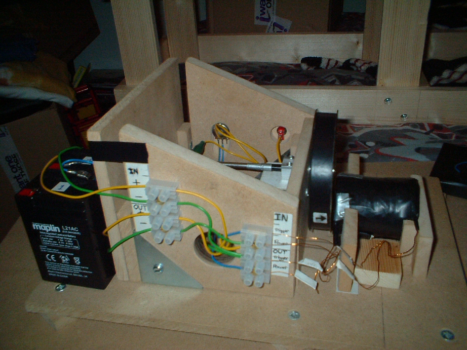

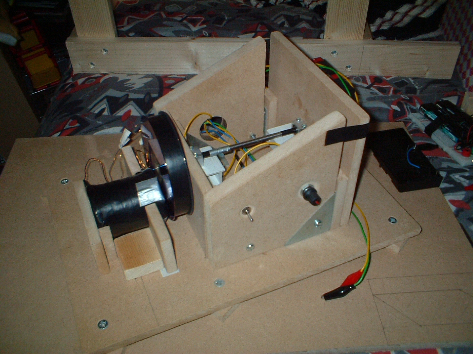

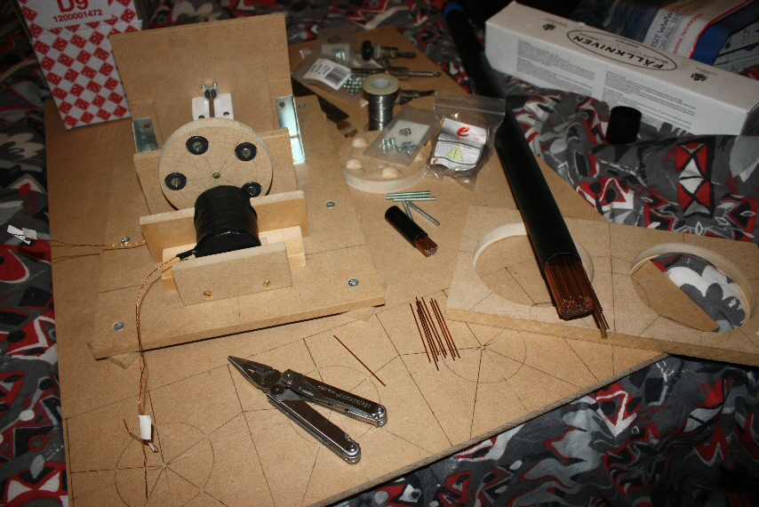

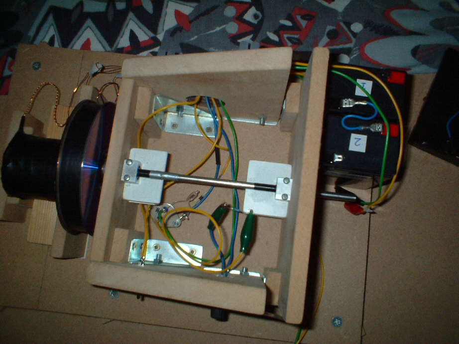

                          • A few pics of the construction process of my SSG including my highly advanced coil twisting method And the completed (or close enough) device. The bits of electrical tape at the back are to try and minimise the noise of the bearings being amplified by the wood, and the tape on the shaft is to stop it from slipping forward or back because I haven't got round to putting a thread and nut to hold it in place. The coil had to be taped up good, because literally on the final turn I heard a big CRACK, which was one end of the home made spool coming loose, which luckily I managed to hold in place without it unravelling everywhere before getting the tape on there.
                            The coil is 26 SWG and 24 SWG wires, approx 780-884 turns (I counted 52 turns on the first layer, multiplied by either 15 or 17 layers because I got carried away and forgot to mark the completion of a layer and ended up with an even number of counts and an odd number of layers, so it's either 15 or 17). 6cm diameter x 7.5cm length coil made out of 12mm thick MDF, with 20mm diameter PVC conduit for the centre. Currently using 5 magnets on the rotor, using standard components and resistor/pot values etc, 1.6mm copper coated welding rods for the coil core. Once the whole thing was up and running I reassembled it adding more wires and the connector blocks to have an "Input" and "Output" section to make it a bit tidier and easier to hook up.
