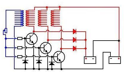

    There are three power coils, but only one trigger coil, each power coil has a transister and there has to be identical resisters from the trigger winding to each transister base as well as the original pot and fixed resister, I have the fixed resister jumpered with a switch for fast spinup.
    There is probably a circuit drawing somewhere in this thread for multi coil SG.
    Oh there is a generator coil at the top of course just to see if it would work.
    I'll see if I can find a multi coil drawing and post it here.
    P.S. You could quite easily make your's into a two three or four coil SG. one that size would probably spin up to a sweet spot somewhere between 2 to 6 thousand rpm, and would work very well. but you need to make sure the magnets don't come off a bigger one like yours, mine has soft linolium type magnet strips, so i'm not too woried about it.

        I can't seem to find a drawing for multi coil SG I might have to look for a bit.
        Rgds
        • Multi coil picture....
          Farmhand,
          I have attached a multi-coil bedini picture.......
          Hopes and Dreams.....
          Tj
          • Yeah thats it thanks. I was starting to wonder if i could find one. Now I don't have to.
