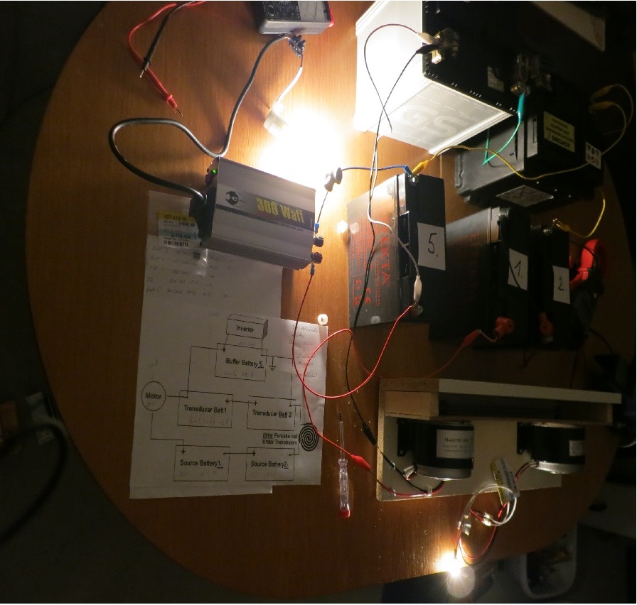

                              • 5BGS running
                                Dear all
                                I got the system ready to run.
                                .....................installing conditions........................running 20'......after rest 20'
                                Source Batt 1: new AMG 12V/20Ah...12,66V............12.04V...........12.33V
                                Source Batt 2: new AMG 12V/20Ah...12.62V............12.00V...........12.37V
                                Transd Batt 3: old car FLA 12V/50Ah flat, -1V..........-7.7V............-2.2V
                                Transd Batt 4: old car FLA 12V/50AH flat, +5V.........+5.5V............+5.2V
                                Buffer Batt 5: new AMG 12V/20Ah 12.64V..............13.10V...........12.84V
                                Motor: of the shelf MY1016, 24V, 250V...................10.3V
                                Generator: of the shelf MY1016, 24V, 300W, driven with chain
                                Light Bulb: 7W / 12V............................................9.3 V (0.9A?)
                                Inverter: 12VDC / 230VAC 300W
                                Light Bulb: 25W / 230V
                                Several runs without the chain and balancing brought the Source Batt 1 and 2 down to 12.4V.
                                The chain drive ist quite loud, but with input 10.3V not at full rating speed of 2450 rpm at 24V.
                                I tried to balance the system with the 2 light bulbs, resulting 25W load on inverter, 7W on generator to get the volt changes on Batts 1,2 and 5 minimized.
                                Results:
                                The Source Batts 1 and 2 are going down slowly, from 12.10 V to 12.04V during 20minutes.
                                The buffer Batt 5 is going up slowly, from 12.90V to 13.10 V
                                The changes of the readings were faster at the beginning, then slowlier.
                                The Transducer Batt 3 rest stable in minus Voltage. Voltage measured over Transducer 3 and 4 together is 13.2V.
                                Turning the inverter on with the switch together with the 25W bulb just after starting results still in a slightly higher motor speed.
                                Regards and
                                cubalibre
