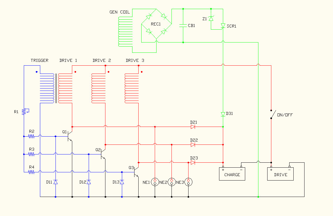

          I found some time amongst my holiday madness to redraw my schematic, hope it helps.
          happy holidays all
          An EXCELLENT Schematic. I would post as a PNG - you will find it to come out much smaller.

              Thanks. Keep in mind that I am still changing things as I figure out what works best for me. That schematic has already been changed to have a fixed resistor at the base of each transistor as per Minoly's input and I think it is better that way but I have not found the time to test it fully other than to see it run.
              Good Idea on the doccument, thats what I am trying to do basically but there are allot of variables to test out! Getting it running is not terribly hard but getting ot to run right is a much bigger question

                Kippered
                I just added a secondary charging battery to the new circuit you posted for me. I'm getting some interesting results, I'll let you know more after further testing. I have the FWBR attached directly to the coil wires, so its only attached to the collector of the 21194 and the start of the coil wires. If that makes sense. I made the correction in my post but it still shows differently in your post where you quoted me (please correct it if your able).
                Mark

                      schematic from conference
                      Talking to a friend who is working on the kit, he recieved a mail from r-charge and it had an attached circuit with pictures. I never recieved that mail but have looked at it now.
                      On the pictures it shows a 'grain of wheat' bulb connected plus the 3 neon's but on the schematic it does not show the 4th bulb.
                      First off I was under the impression the neons are the 'grain of wheat' since that is what they look like and the 4th looks like an LED. The LED is shown in the basic monopole circuit in the trigger portion so my best guess is:
                      Basically I have had problems with the inrush from hooking up the battery inducing enough to turn on the 8099 transistors and then burning it up due to the higher than rated current. I have gotten around this but guess is that the small LED is so the voltage needs to hit a minimum level before turning the transistor on stopping this problem.
                      Sound about right? I am using bigger transistors now and the problem is gone.

                          In my frantic spare time I have been able to make some progress including a working automatic cap dump system for putting the generated power into the system. Next I am going to play with coil configurations using my automated switching system that should allow me uniform testing conditions and then its time to perform battery charge tests and plot some data!
                          see the attached revised schematic I am using
                          for the cap dump I am using a 4.7V Zener (as was reccomended on other threads) to trigger my SCR. I learned the 4.7V was necessary if you want to dump at about 2V over battery voltage because of the large voltage drop due to the battery impedance. I also learned it is critical to pick a SCR that has a very low trigger current otherwise it will not turn on.
                          Anyhow the fun really begins with the tests and regardless of outcome has been a fun learning process.
