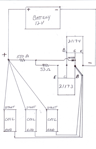

        I've had my 3 pole kit now for over a year. I have come up with a different circuit similiar to the half bipolar circuit, but even simpler. I'm using the 3 power coils but I am not using the trigger coil wire on the bifiliar coil. So you could just use 3 single wire coils. I am putting the spike back into the input battery so I use only 1 battery. My best tuned set up runs on 12 volts 40ma and the rotor turns a little over 3300 rpm's.

        • #34
          Hey Mark, can you post your schematic so I can replicate.
          • #35
            Parts you'll need:
            21194 transistor
            21193 transistor
            1N4007 diode
            33 ohm resistor
            550 ohm resistor
            I hope the diagram shows up never posted one here before.
            Mark

                      • #41

                            • #44
                              Hey Kippered
                              I emailed you the circuit. No over unity with the circuit or actual charging of the input just recirculates the spike back into the input battery. Feel free to post the circuit so others can play with it and possibly improve on it.
                              Mark
                              • #45
                                Circuit from Mark
                                thanks Mark here it is (hopefully)
                                I had to resize as the file was too big for an attachment here.
