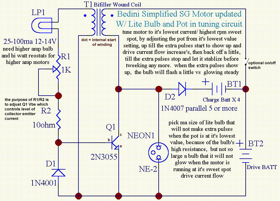

        Will do once I get home tonight. I used the typical SSG diagram but it doesnt show some details such as the transistor pinout etc..

              As promised here are my work in progress notes minus my plans going forward which we can all discuss, please feel free to correct me if I have things wrong or at least have a discussion around it.
              Concept
              The Bedini motor harnesses extra energy from the environment by the use of the radient voltage spike coming from the colapsing magnetic field in a coil of wire. This spike charges a battery that makes use of this pure voltage spike to chemically recharge itself. The extra radient energy is gained due to a disturbance in the surrounding environment that allows the extra energy around the wire (heaviside flow) to enter the circuit.
              The energy lost from the primary battery is due to the energizing of the 3 coils briefly which requires energy to establish the magnetic field and provides rotor push via repulsion of north poles. The use of permanent magnets in the rotor provides a free magnetic field used to trigger the coil pulses and also to provide repulsion moving the rotor. The speed of the motor is self determined by the applied voltage (field strength) and the number of asymetrical trigger poles. The rotor torque is determined by the number of pulse coils, more coils equals more torque. If using a generator coil to drive a load then it will affect speed depending on the current load (BEMF).

              The SSG diagram and description of the circuit operation
                The single most important thing is to educate yourself and know what the components are and how they work, what they are looking for etc...
                Attached is the datasheet for the 8099 transistors. I had them running fine and reached about 3000 RPM with the fixed 220ohm resistor but now I have 1kohm pots to work with and am going to experiment with transistors like Alan.
                I will post pics of the kit re-build once it is done

                  Looking at your schematic, I would suggest a higher resistor than 10 ohms in your SSG schematic, 47 ohms is the lowest I would go unless you are driving with like 6 V.
                  Just a suggestion. I have burnt up many a resistor at that location when I stepped up to 12 V / 24 V / 48 V, using this circuit.
                  See my experiments here...
                    Thanks theremart
                    I have used the 10ohm with the MJL21194 with no problems but I am sure you are right with using low power transistors such as the 8099.
