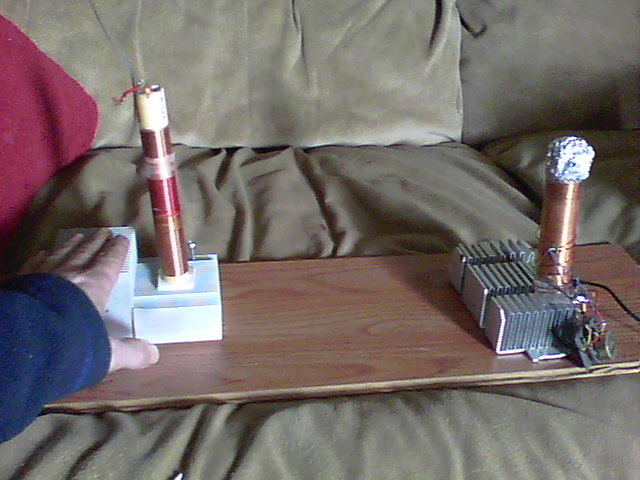

      I was going to build up a pop bottle coil for this and, while cleaning the bottle up thought i'd try 1 turn of speaker hookup wire (20ish gauge) as the primary on my PVC pipe based shorter tower. Fired up the BD139 based circuit at 12V and got plasma ! So, I guess I join you guys with that one now...so exciting in more ways than field effects
      After a few experiments with bridge rectifiers, transformers and big caps i'm still unable to convert back down to DC useable current from a receiving tower. Any pointers ?
      Here's the plasma vid and there's a pic attached (sorry about quality).

            It's a tennis ball on the top jimboot, with the tinfoil wrapped around. The field seems to change based on the height of the single wind on the tower. The lightsaber will light easier at one spot, get better range in another and then anything will light at another, but at maybe the cost of range or plasma. So a crucial resonance sweet spot maybe a little more subjective to the kind of results wished for. It seems easier to note such things with the one turn primary.
            Neons will light to around 5" tower distance if just placed in the palm of the hand, no AV plug or anything. Surprised the heck out of me that did and looked like one of Lidmotor's killer 'must try' effects lol
            Plasma will reach down a thin copper wire to a few feet and neons will light for an inch or so around the wire. But any tinfoil mass and that stops, as does the field. I tried a very loose pancake type arrangement off the end of the wire last night and got nothing. Nothing either with a wire running to flat foil out on the floor.

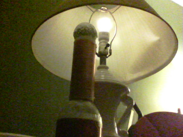

            • Bit of a fun thing happened just. I built one of the pop bottle towers and then put my usual tennis ball one on top, connected output to input.
              Powered up the circuit to try it all out.
              Went to switch the table lamp off and it only dimmed a bit. I tried the switch again, seemed fine....and then it dawned on me what was going on
              • Originally posted by Slider2732 View Post
                Were you able to light the table lamp with your exciter?
                • Yeah
                  You can see in the pic how it's dimmer than the other lamp on the right of the room. Not bad though, thinking about mains versus 12V.
