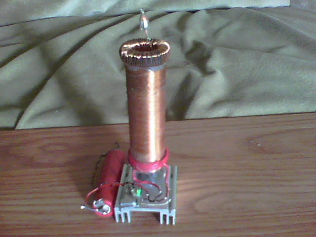

              So, I built the 'Wensleydale' today
              Components are only the transistor and coil placement LED, beside the L1 and L2 tower.
              Transistor is a C3198 - which, has been found to be very strong and to self start oscillating 9 times out of 10.
              Datasheet here: 2SC3198L Datasheet pdf - SILICON NPN TRANSISTOR EPITAXIAL PLANAR TYPE(PCT PROCESS) - Korea Electronics (KEC)
              Primary is 3 turns, secondary is about 400 of mid 30's gauge wire, wrapped around a Radio Shack solder tube.
              Field strength is ok for a couple of volts (whatever that single cell from a laptop battery has in it).
              At the top, is a ferrite toroid, wound with wire...but only completes the look of a Tesla tower, rather than appreciably changes anything.
              The video does indeed have my pronunciation of Wensleydale too lol

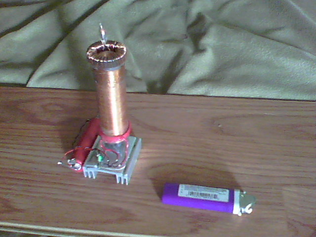

              The removal of extra coils, capacitors and other refinements has also meant that the circuit fits on the small heatsink, that i've used as a base to put the tower on.
              Shown with a regular cigarette lighter for comparison in the second pic.
