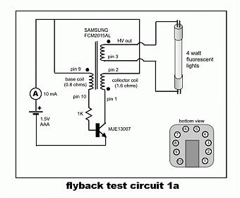

    Attached is a circuit using only one resistor that you might want to try also (it is a Joule thief circuit).
    I do not think a flyback will work as well as your simple SEC for wireless stuff because it works at a much lower frequency and therefore less energy is capacitively coupled through a given capacitor value. My flyback was working in the low KHz range. I suspect your simple sec is working in the MHz range. That is a difference of about 1000 in energy coupled through a capacitance.
    Hmmmm...... My circuit was converted to a smaller size by the forum software. The result is a bit hard to read. Sorry, I am still learning how to do things here.

          If you post image as gif or png, it will converted to small jpg, it is best to post it as jpg.

            I have not removed any diodes. But, Yucca has. He said it was not hard to do. I did not want to risk breaking my flyback. If you do, please post results. But, the flyback technique of voltage multiplication does not produce AC since the rapid current change is always with the same polarity. I think the diodes are mostly to keep the capacitor (picture tube) from discharging. To get AC I think you will need to use a two transistor driver.
            Yes, I made the circuit a while ago and it lights the tube with 10 mA from 1.5 volts. I like this because there is only one resistor to change. But of course, two resistors gives more options. I have used it up to 9 volts.
            For some reason which I do not understand, the Joule thief + trigger coil circuit produces AC (or at least symetric plus and minus pulses). I was able to get high voltage AC that way. But, there is still the low frequency problem. You should be able to use the flyback transformer in place of the trigger transformer if you want to try this. I have been able to light a 4 watt tube without any wires to the tube at all from 3 volts using this circuit, but only when tube was right next to the circuit output wires.
            circuit = http://www.overunity.com/index.php?a...0;attach=41557

            • Originally posted by sucahyo View Post
              Thanks. I had posted as a GIF so that explains what happened.

                    You might try the one resistor circuit I posted above. It is easier to get it working and it will produce small sparks at 1.5 volts if the resistor value is decreased. Neon does protect transistor, but it also steals a little power from the output.

                      Got it to run from 2 AA batteries with your circuit and a 2n3055.
                      Had several problems initially:
                      Had tried a BU208D which did not work,
                      Did not try with my one and only 2n3055 for fear it might fry ...

                      PPS xee2, you can reformat your image to ca. 800 pixels width before uploading, then it will display ok. I use the program irfanview
