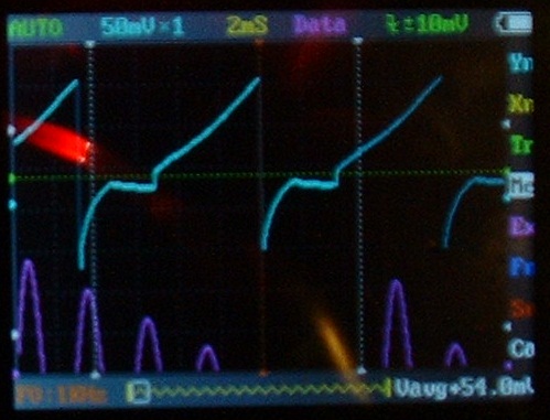

                        • Ok, I managed to remove the switching noise.
                          Now a single cycle is 8.84mS (113Hz) with a duty of 54%.
                          It draws a linear rising current for 4.78mS
                          That makes the total current draw 90mA from the battery.
                          Also in every cycle it feeds back a 2mS pulse to the battery.
                          That pulse is 160mA average so it charges back a constant 36mA.
                          • Originally posted by janost View Post

                            thats really cool to see!
                            -Shunryu Suzuki
