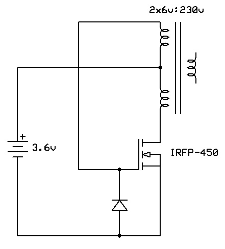

                      • I've built this MOSFET version of a Joule-Thief to get something oscillating on DC.
                        It uses a IRFP-450 MOSFET without heatsink and a 230v/2x6v transformer with a center-tap.
                        It draws 170mA@3.6v and the MOSFET is cold to the touch.
                        The problem is that it wont run on higher voltage than 3.6v
                        I tried at 6v and the MOSFET just remains fully on.
                        Is it because I'm not using a resistor on the gate?
                        It has a gate-threshold of max 4v.
                        Could someone throw a light on this?
                        • Originally posted by janost View Post
                          You may be getting too much voltage feeding back to the gate from the winding that the gate is connected into. You can try adding a voltage divider circuit on the gate to lower the amplitude of the pulses feeding back to the gate. You could also try placing a low ohm value resistor in series with the gate, with one end connected to the gate. Try values between maybe 10 to 100 ohms. Maybe try the voltage divider first though. If you have a 10K pot, you could maybe try using that for the voltage divider on the gate winding lead that connects to the gate, and then you can make on the fly adjustments to the gate pulses amplitude.
                          level
                          • Originally posted by level View Post
                            Thanks.
                            I though that it might be the problem and since mosfets are voltage controlled it might need a divider.
                            I'll try a pot in a divider config.
