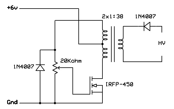

          • I would say that this JT is extremely efficient.
            If you just have 1.5v or less to feed, the mosfet wont do and a bipolar is better but if you have enough for the gate to switch, the mosfet is way more efficient.
            The circut has no resistors (except for the gate bias but that is voltage controlled) so nothing to disipate heat.
            The total current drawn is less than 60mA because the coil feeds back to the battery.
            When the mosfet is on, its 0.3ohm to ground and when its off it is >1Mohm.
            In practise the coil is straight over the battery.
            Still it doesnt need a heatsink.
            And it switches fast, VERY FAST, less than 50nS.
            The coil is charged to 330mA before switched off and the kickback has nowhere to go as the mosfet isnt there anymore.
            The pulse that is generated on the secondary is way over 300v and is radiant for sure.
            The drawback is that power mosfets are expensive
            This is the best JT I have ever built
            • By the way, I removed the switching noise by changing the trimmer from 5Kohm to 20Kohm instead.
              Probably has to do with capacitance on the gate?
              • Originally posted by janost View Post
                Hi Janost thanks for sharing. Regarding coils you wound them to a toroid or a ferrite rod? How many turns?
                  I did not wind it myself.
                  It is a 230v/2x6v 4.5VA transformer.
                  The resistance of the windings are 0.3ohms
                  But it should also work with a torroid or ferritecore with at least 2x40turns.
                  If the feedback to the battery is to work, the number of turns should be the same.
                  There is also some loss in the feedback diode as it has a drop of 0.7v
                  But its the only configuration that works for collecting the kickback to the battery.
                  Anything on the primary coil would short it out.
