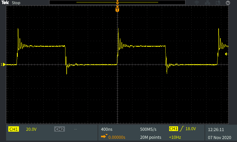

          The main characteristic that I looked at when choosing my components was speed. The 1EDI60I12AF gate driver has a typical delay of 300ns which is way too long for my design. Adding a resistor to the MOSFET gate slows the switching of the MOSFET which is also not what I want. I managed to get the ringing down to an acceptable level with some capacitors, UF diodes and a TVS. It now looks like this:
          Click image for larger version  Name:	TEK00234.PNG Views:	4 Size:	19.5 KB ID:	501543
          It doesn't have to be perfect as it is a signal that goes to a vacuum tube grid. And whether the grid is +150V flat or with peaks to +300V the tube will conduct, likewise -150V flat or with peaks to -300V will just block any current.
          The circuit seems to be working quite reliably now, so I hope to be able to upload the KiCAD files and BOM soon.
          (very busy these days)
          Ernst.
