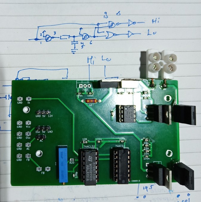

          OK continuing on the QCW experiments line... started here with the RF-amplifier idea...

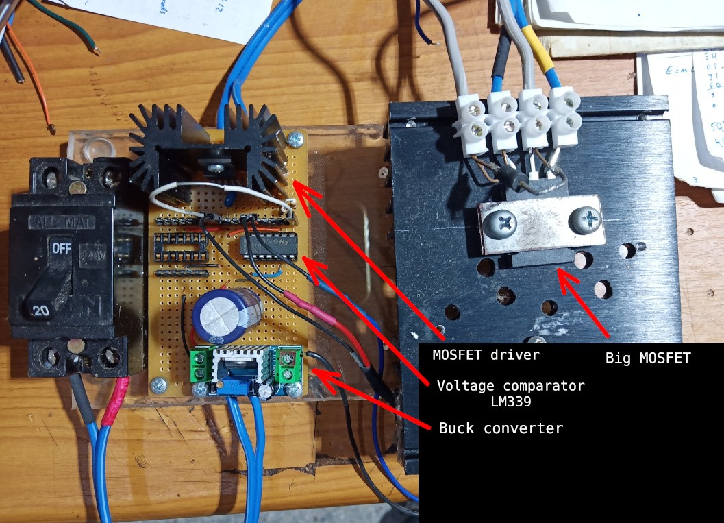

          My second Idea was to use PWM. I used a dual channel DDS (UDB1300) to provide the coil's resonance frequency as a triangle waveform and a low frequency (10-1000 Hz) saw tooth.
          The signals generated by the UDB1300 are balanced around 0V, so half of the period they are negative, the other half positive. My voltage comparator+MOSFET driver only accepts positive signals so I added a buck converter to raise the (GND) voltage of the UDB1300 just enough so that the entire signal was >0V.
          The two signals were fed to a voltage comparator, producing the PWM signal. This went to a TC4422 MOSFET driver and that to a large MOSFET.
Name:	PWM driver.jpg
          This circuit worked but I did not see the QCW effect.
          I did hear the sound of the PWM-ed signal through the (small) streamer that it produced. And, more interestingly, this small (4 cm) streamer produced copious amounts of ozone.
          So, even though I still didn't get to see the QCW effect, this kind of streamer showed a strong chemical action (that Tesla also refers to) that could be useful in charging batteries or splitting water.
          More later.
          Ernst.

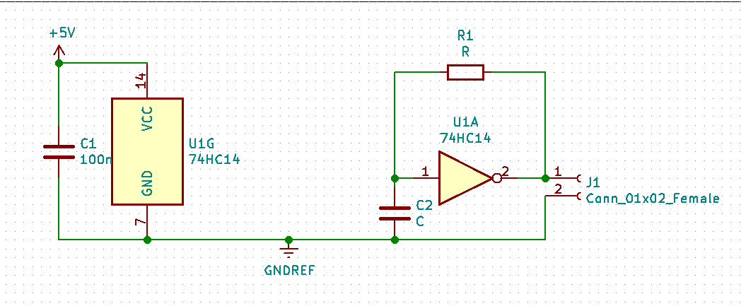

                No, when I think of a capacitor based oscillator circuit, due to my background in digital electronics, I think of something like this:
                U1G is the chip's power supply, so don't look there.
                U1A is an inverter, so when the input is low, the output will be high and vice versa. So by connecting the input to the output you would get a very fast oscillation. To slow that down you add R1 and C2. Now the output is delayed through this RC circuit and fed back to the input resulting in an oscillator whose period is determined by the values of R1 and C2.
                No HV involved here, nor any coil. Just charging and discharging a capacitor over a resistor. Easy and very reliable. That is, to make it very reliable you'd need a very constant power supply. This can be arranged through using a battery and/or a 7805 voltage regulator. The combination will give a near ripple-free 5V.
                So now you have a capacitance dependent oscillator, next thing you need is an instrument to measure the period of this signal.
                One way would be to get a HF crystal oscillator and counter and count the HF pulses that fit in one period, but then you have a number and how would you want that displayed?
                The better way to do that is by using a small micro controller. That will give you plenty of options to display, log or otherwise output your measurements.
                I have some ATmega's laying around that could be programmed to do this, or you could use an arduino.... Plenty of options there.
                Ernst.

                  • #54
                    J1 is the output of the oscillator. This should then go to some microcontroller to measure the period.
                    If you choose R*C=about 0.01, then your period will be around 0.01 s (frequency about 100 Hz). With 100 measurements per second you may be able to see 11.7 Hz waves.
                    I agree that a large C is preferable, but don't choose R < 1K because that may overload the gate output. So 10uF and 1K would be good values.
                    I think crystals would not be affected as much as capacitors as they oscillate on different principles.
                    We have seen that these waves can be guided along conductors, so I can imagine a funnel with the capacitor at the centre.
                    As for the measurement with an ATmega, you would have to use the chip's builtin timer. I know it can be done in assembler which takes a little bit more than average knowledge and skill, but that should give decent results. Many arduino programmers use program loops for delay routines, that will not give accurate results. You really need to program the timer and use interrupt service routines to read and reset the timer and output the result.
                    It is probably possible with an arduino but I have never done that before.
                    An ATmega328 can probably relatively easy be used in a cuircuit like this. It has 3 timers and all inputs can trigger interrupts. So I imagine something like:
                    1 - initialize chip
                    2 - sleep
                    3 - goto 2
                    Then all the processing is done in the interrupt service routine which in its simplest form looks like:
                    1 - read and reset timer
                    2 - output timer value
                    3 - return from interrupt
                    Since my money is running very low, I will need to pause my experiments some day in the not too distant future and do some programming job. While I am in programming mode I may do this one as well.
                    Ernst.

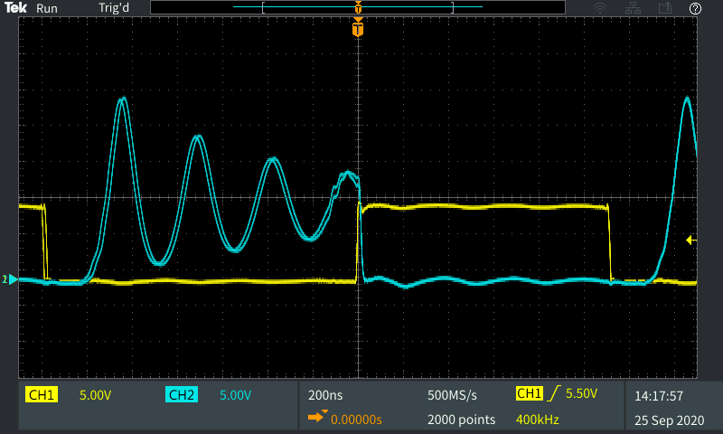

                          Continuing on the QCW experiments line... started here with the RF-amplifier idea... then the PWM idea here.
                          As it MOSFET's do not seem to survive in my experiments I then looked at vacuum tubes. The 833 triode in particular for which there is a Chinese version: the FU33C.
                          If I can somehow switch the grid voltage between +150V and -150V that could make a very powerful Tesla coil driver.
                          That led me initially to the circuit shown here.
                          The grid is charged (to +150V) through a resistor and discharged (to -150V) through a MOSFET. Unfortunately the charging happens too slow for the frequencies I am interested in (300KHz-500KHz). So the next attempt is a half-bridge as shown in this post.
                          And that is where I am today
                          The first tests were not particularly gratifying
                          The yellow trace is the input signal which after a small delay results in a change in the output (blue trace) accompanied by tremendous ringing.
                          Through adding some capacitance I have now been able to get it tho look like this:
                          For the tube and the Tesla coil is is absolutely usable. The only things that worries me a bit are those voltage spikes. The negative spikes completely disappear if I add a 25 Ohm load to the circuit so that is not too bad but those positive spikes go up to 1.5 times the voltage. That is near the max of my MOSFETs.
                          It looks OK-ish, but I would like to reduce the ringing a bit more. BTW, this ringing occurs only on the output of the half-bridge. The input to the half-bridge, the signal on the MOSFET gates is pretty clean:
Name:	TEK00193 zonder.PNG
                          Any ideas?
                          Ernst.

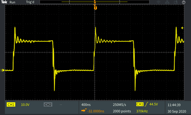

                          • #58

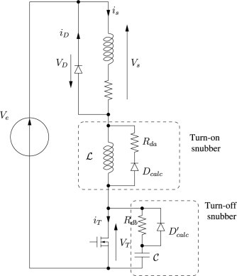

                            What kind of load would the grid of the FU33C? Would that load drown the ringing?
                            The art of snubber-ing! Has anyone figured a good method for damping MOSFETs?
                            • #59
                              The problem is not just "suppressing the ringing", it is "suppressing the ringing while maintaining the switching speed".
                              The "standard" snubbing techniques cause severe switching delays. Look for example at the circuit above, the "turn-off snubber".
                              While the MOSFET is conducting there is a (near) zero potential across the snubber circuit. When the MOSFET switches off, this potential can immediately rise because of Rdb being placed in series with C. However, when the MOSFET switches on, L inhibits the immediate current flow delaying the output.
                              Also, I'm using a half-bridge... Usually, when I google "half-bridge", I find circuits that don't require fast switching. But, I'll look again. You never know...
                              Ernst.

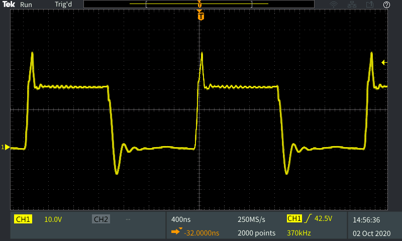

                              • #60

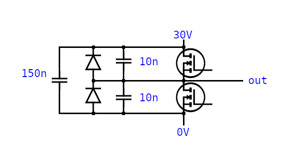

                                OK, here is what we have now. 150nF PP film capacitor across the power supply, 2 10nF ceramic capacitors across the diodes to the power rails.
                                With this result:

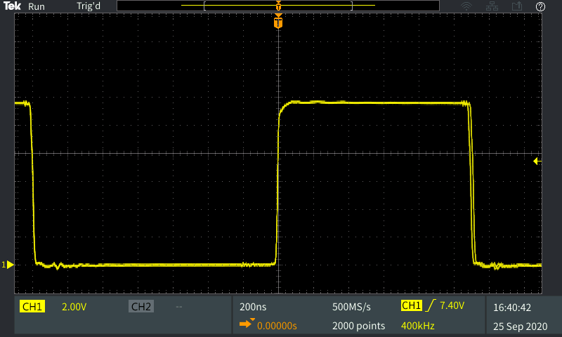

                                Still an almost 18V spike when switching on and about -13V when switching off, but other than that it looks decent.
                                Maybe if I add a TVS, that should suppress those spikes a bit. (but I do not yet have one of the right value).
                                Ernst.
