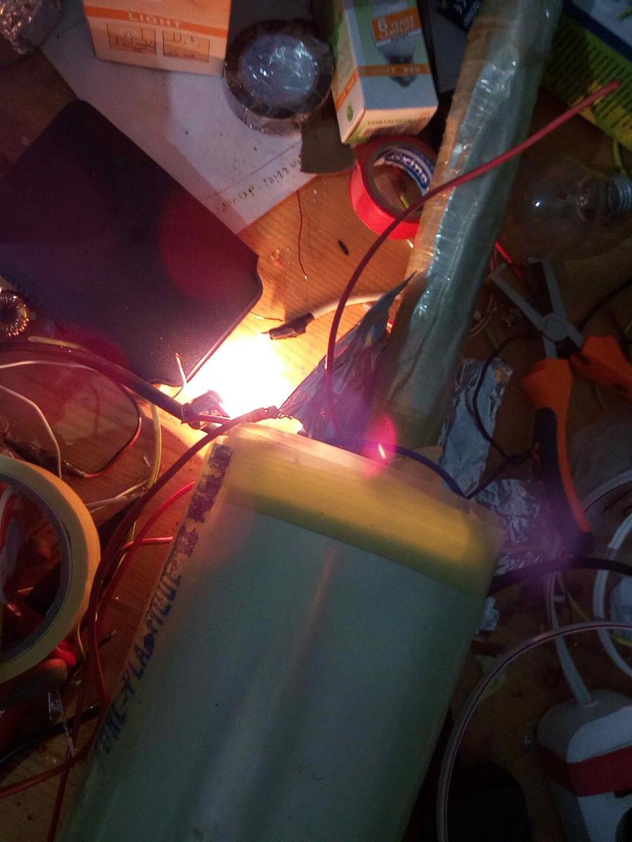

    you successfully converted radiant energy into useful electric power , the first experiment with tower coil ! the Incandescent light bulb is primarily a resistive load and it's the most difficult bulb to light up because it show a real power ..
    the following photo show an Incandescent light bulb with full bright ( the energy is radiant without a doubt ..) the bulb don't generate a lots of heat compared ordinary electricity , the core of ETBC is stainless steel thin layer tube , i drive the circuit using Mazilli driver at the same time i take the power from it ! this is the replacement of D-ETBC :
    as you see a lots of mess there
    today i tried another test using solenoid coil oscillator ( Mazilli driver ..) i tired to put the stainless steel but the oscillator stop !!! this is to be expected because the core form a short circuited coil which take a lots of power than the power supply can handle, if i change the power supply the driver should work again as induction heating !! but this is not the case when using the ETBC !
    i need to take some measurement before a can make a conclusion of what's going on , how to make the compacted Tesla wireless power transmitter reflect the power is solved now but we need to know the requirement to take the power the best way .

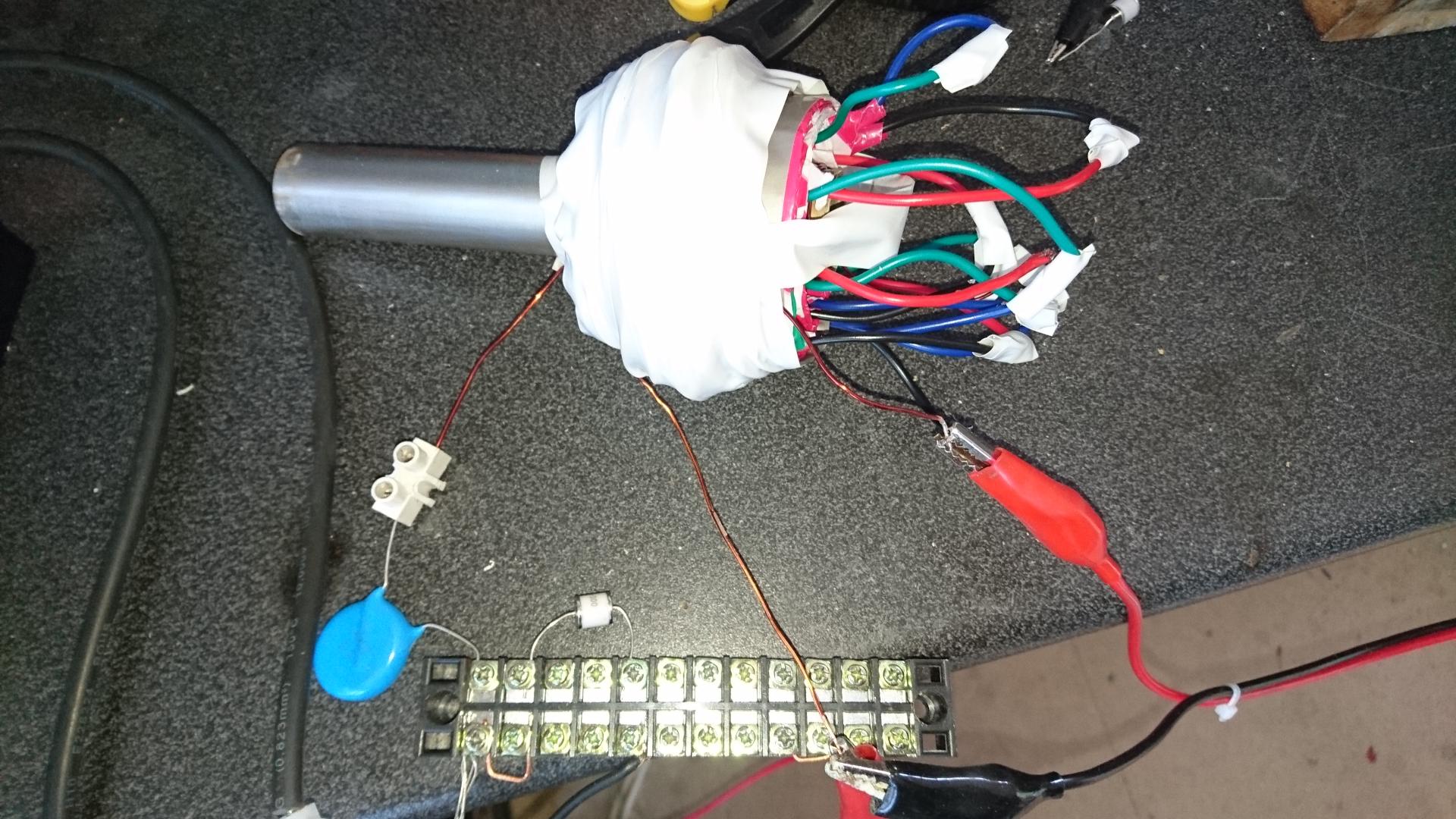

      Thanks for the demo! Couple of questions. Did you have a coil L2? I take it your wide wrap contributes to the current? Did you only have one wrap? Finally, was that a collector which looks to have a wire attached in front of the coil?
      I have ordered a larger piece of SS tube - 50mm dia. In the meantime, I have a couple of small lengths of smaller SS tube from when I was mucking about with Stan the man's H20. I have L1 which comprises L0 50 turns and 4 wraps of ETBC. L2 is 100 turns 1mm wire over the top, only one coil as in the attached photo. Output is quite good. I have to get the capacitor upto about 220volts and then switch globe into circuit. I only have tungsten hybrids. They pulse the light. Cap charge -> discharge. The small test model holds the threshold at about 220 volts. Need the higher range to kick it is. However, I have left it running for a couple of hours and the output has seriously deteriorated. I am wondering if the ETBC wraps have shorted.

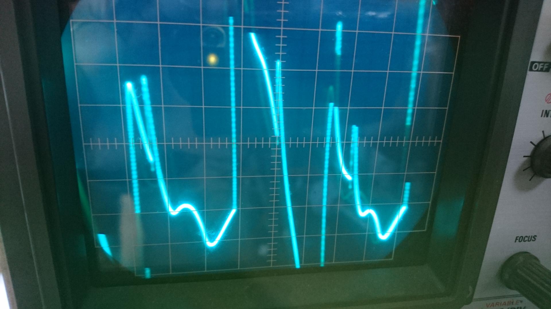

      Anyway, This is the test unit until I get a larger SS sample in a few days, and the wave form - quite steady on my scope!! Is that telling me something. The circuit is essentially one half of my original.

        welcome, the ETBC is isolated without L2 coil , the idea is how to take the power from the ETBC without disturbing it, it oscillate around 600 KHZ without load after attaching the light bulb the frequency increase to 640 KHZ , the light bulb just a show because it's better to attach a capacitive load using diodes to rectify the power .. i also need a couple of capacitors to make a kind of super capacitor to see how much power we are able to obtain from this high frequency capacitive disturbance .
        the wide wrap contributes to the electric current gain when we can cancel lenz's law in 3D environment.. this is the most good news here because we can cancel this effect only in 3D geometry ! ( this is my opinion ) the half of the answer is the capacitive geometry which allow another degree of freedom, this side allow you to copy the power , this is why we need to use a capacitors banks .
        this is the same ETBC used in the first experiment with tower coil , with other modifications , the number of turn is 10 the two side together . inside it i have a stainless steel tube which make the light bright strongly , if i remove the tube i have a minor power , now we have a new interesting phenomena regarding the use of steel in high frequency without heating effect problem , the tube form a continuous conductor so i have to cut it to make a break for the electric current and repeat the test once again .
        the photo is just to show how the radiant energy is there in the ETBC all the wire there isn't a part from the experiment!!! just an ETBC and a light bulb , the real power is inside it !!! later i will explain more if the idea is correct and strong enough to be published otherwise it's another failure i hope it's correct !

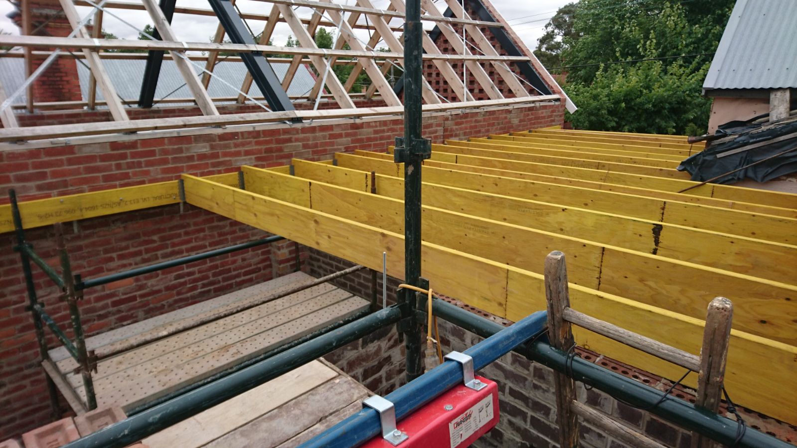

          Some progress to date, I have been the bricklayer too! This week or so I am now a Roofer!
          • Hi Dwane,
            nice to see the the roof you made, Next time you will be over energy device roofer , i really don't count the numbers of ETBC i made until now ! being stuck with such geometry is something strange , like it act as a magnet to me !

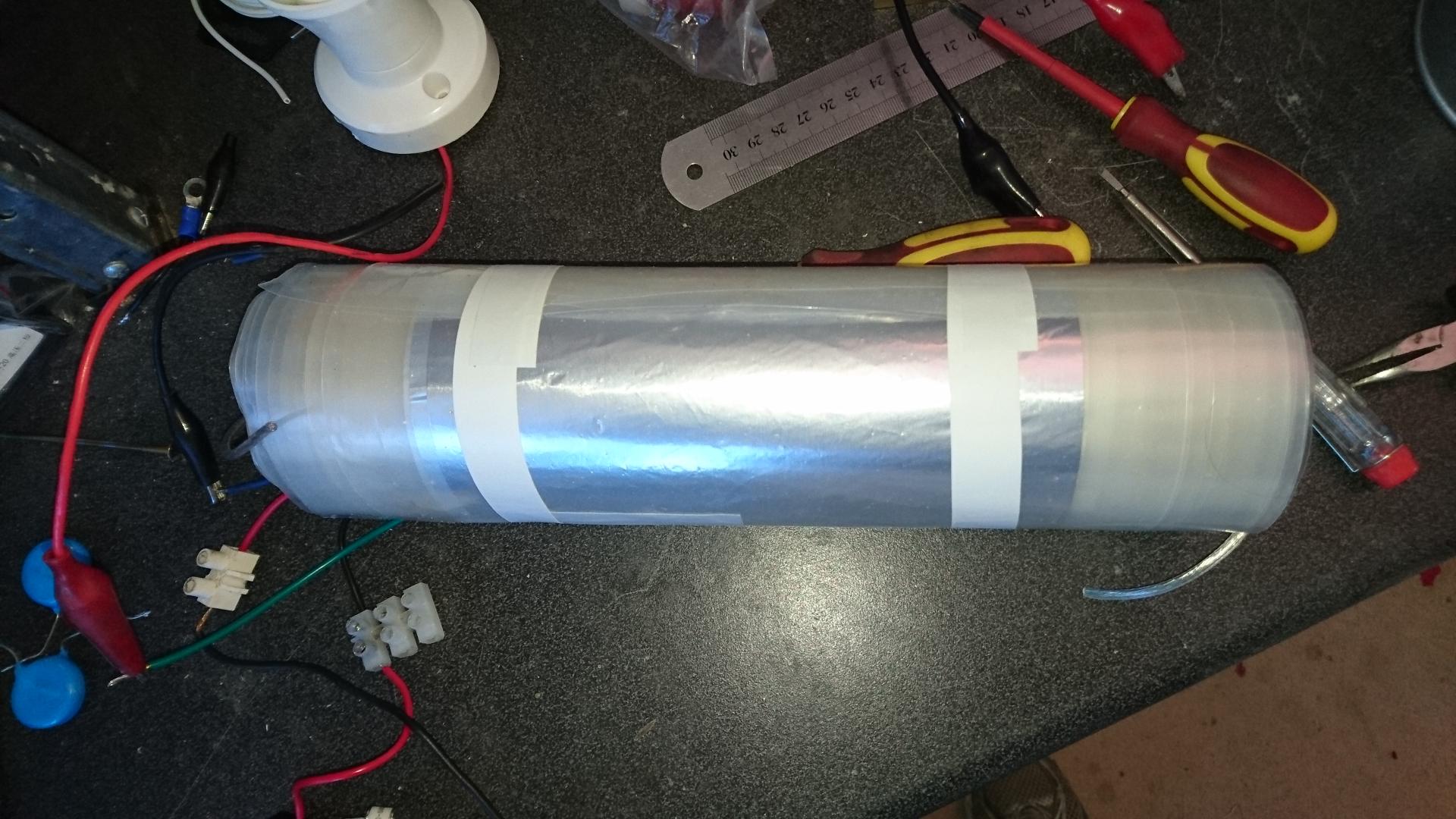

              I am having trouble connecting the Mazilli to the new wrap. 10 turns on SS core 57mm. Length is 220mm. As soon as I try any configuration, the Mazillie goes dead. When I disconnect, I can get the plasma arc across the terminals of the Mazilli.
              If I connect the NST, need diodes to get it working, no caps.Getting lots of popping sounds from withing the build! I suppose I have some insulation issues! Or the wrap is not wound tight enough?
              Perhaps, as we are connecting direct to the Mazilli, could you show me how you connected? I am missing something here. I get the impression I have an impedance problem with the Mazilli.

                Hi !
                just a quick reply ! please open the junction CD and measure the capacitance or the continuity , if there's a continuity the ETBC will not work , this is due to internal short circuit , to protect the Mazilli driver never use a powerful power supply for the first test ! always use around 30 W power , as example 12 V 3 A is good ! more than 100 W will break the MOSFET instantly if there's no capacitance or if you drive it very fast than it can handle .
