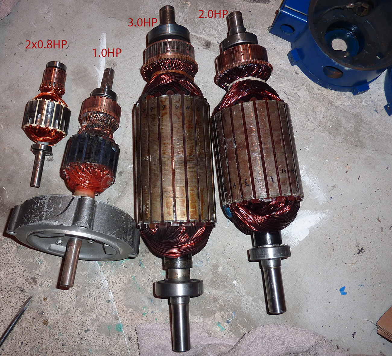

                      • HI Dana , I posted a picture of the rotors I have.
                        1) two are 0.8 HP (only one is shown). with 16 sections on the commutator and the lamination
                        2) one 1HP motor , but this one has coils stator. with 40 sections on the commutator and 20 section on the lamination
                        3) one 2HP with 63 sections on the commutator and 21 section on the lamination.
                        4) one 3HP with 63 sections on the commutator and 21 section on the lamination
                        The bearing is not a big problem to remove, but the commutators are not intended to be removed. Even with a puller it might break. I could put both 63 section commutator on the 2HP motor, but I will run out of shaft lenght... i guess.
                        Which one would you use ?
                        Joel

                            • Hello and Welcome Lerameur
                              Joel
                              Hello and Lerameur,
                              You've got some nice Machines there, now I would go for the 3HP one, bigger shaft, longer armature core 9more elongated) which will generate more than the rest.
                              Now a 63 element commutator would be used with 21 poles by joining three elements (63/21=3), then you have a 21 element commutator...

                              • WOw Hello UFOPolitics
                                Hello Mr UFOPOLITICS.
                                Good to see you and thank you for the nice welcome.
                                All the motor shown have only two magnets inside (stator) and not 4 like your diagram.
                                So what you are saying is to take the 3HP motor.
                                Remove the commutator from the 2HP and put it on the 3HP ?
                                If I do that then I wont have enough shaft left to stick outside, How do you guys go about that? I was thinking of keeping the shaft of the 3HP and switching the lamination from the 2HP. Not sure if its a good idea and if its possible...
                                these commutators are a Bit$$$ to remove any hints on how to remove them without damaging.
