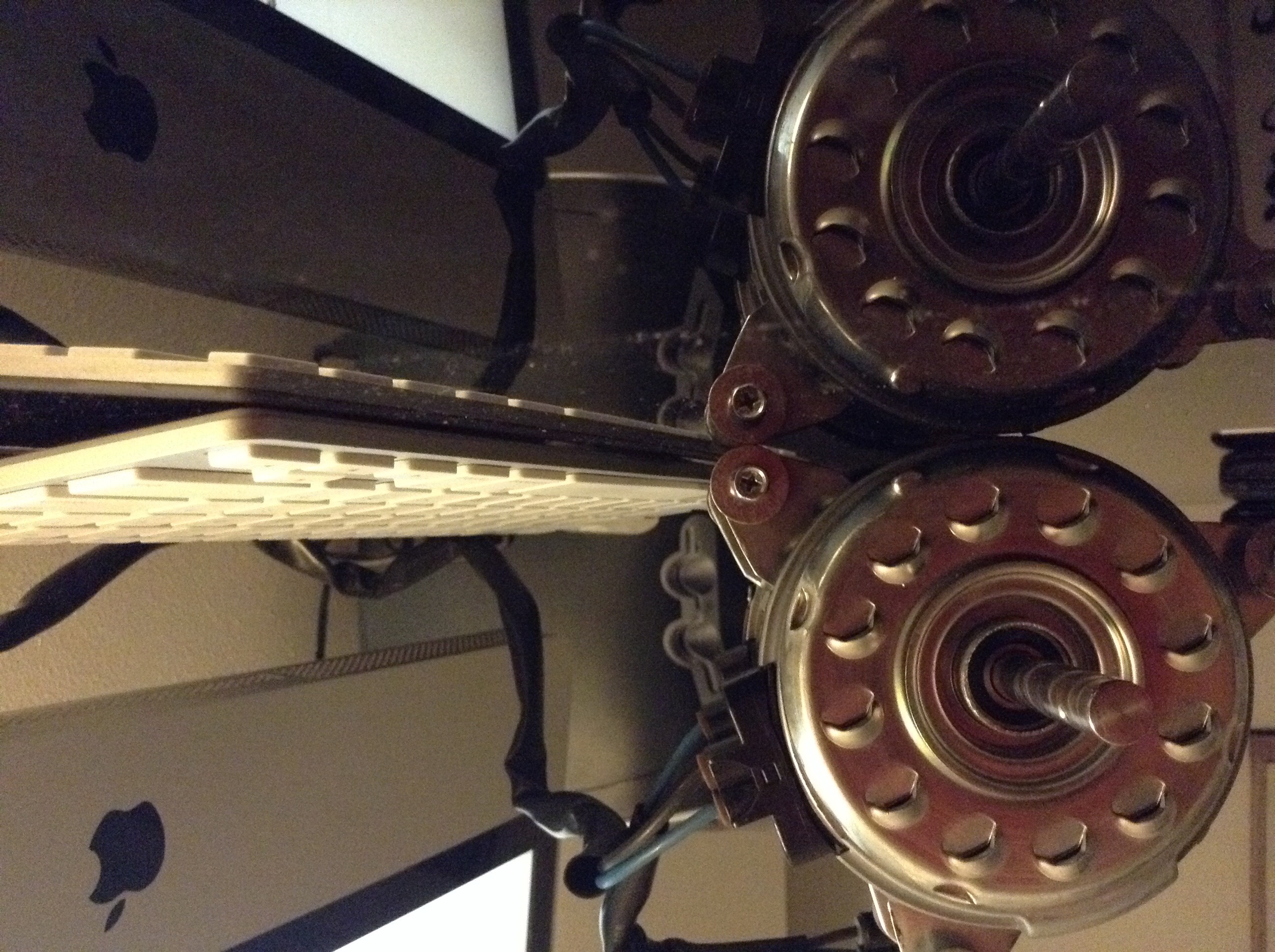

                        • Asymmetric 10 Pole
                          Asymmetric 10 Pole... This is the first picture more to come. Still figuring out the UI on this forum.

                            • Welcome Zara!
                              Hello and Zara!!
                              [IMG][/IMG]
                              Wow!!...That is a very nice looking Machine Zara!
                              Zara, I recommend to open a free account at photobucket.com and upload pic's there, since space on this Forum Server is limited, plus outside viewers (not logged in) could not see them.
                              Then on this UI Editor choose IMG at the little yellow square icon and add link from Image URL from Photobucket at the new small window.
                              Beautiful Machine!!
                              Regards and Thanks!
                              Ufopolitics

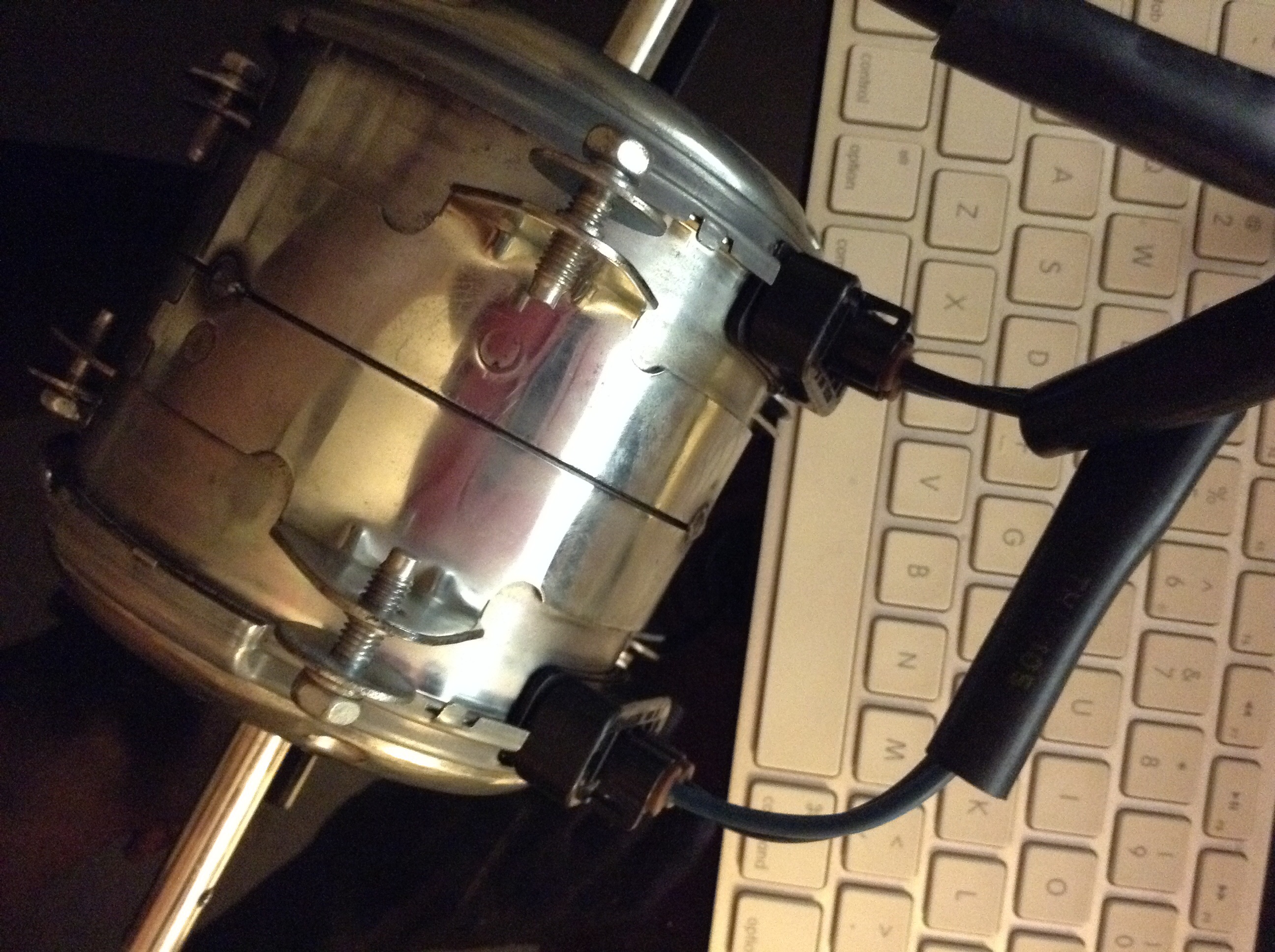

                              • Cap Side
                                This is a picture of the side of the cap of the motor.
