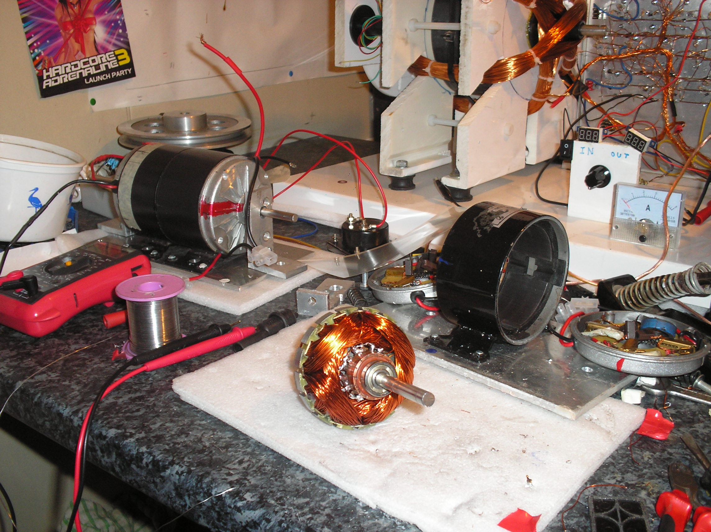

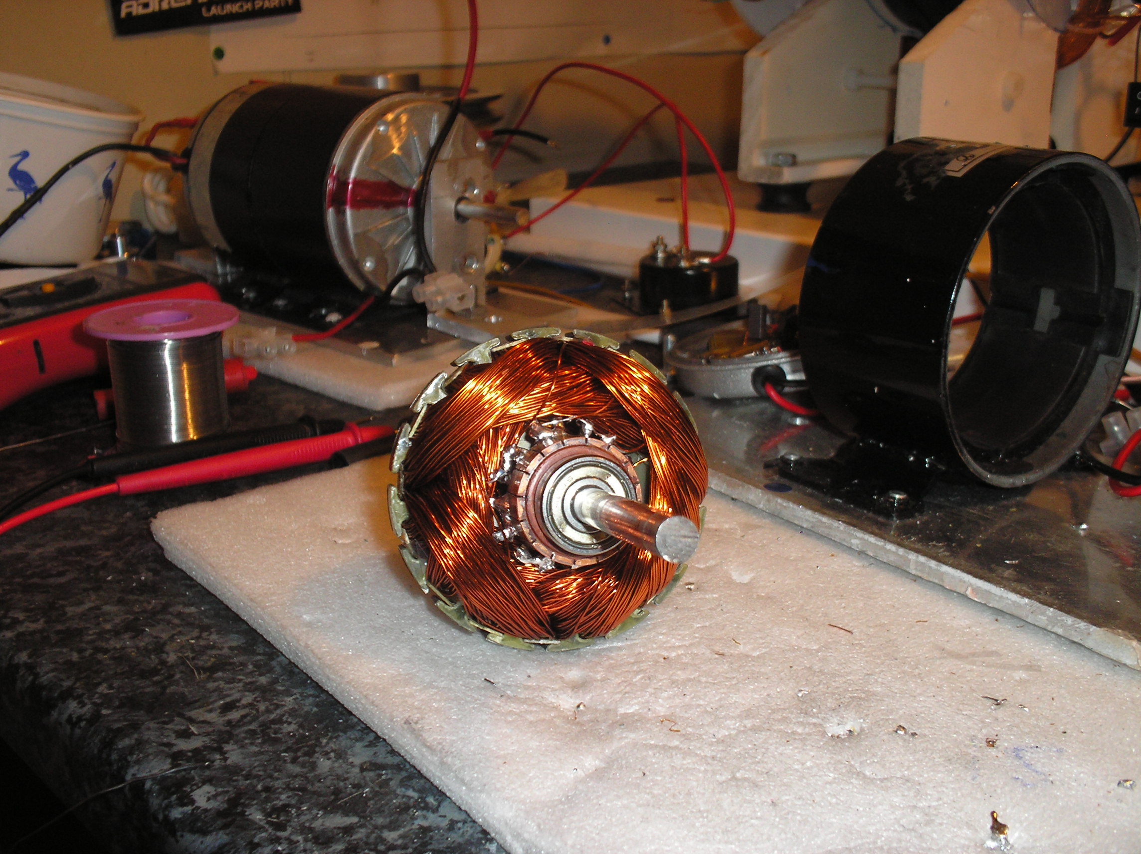

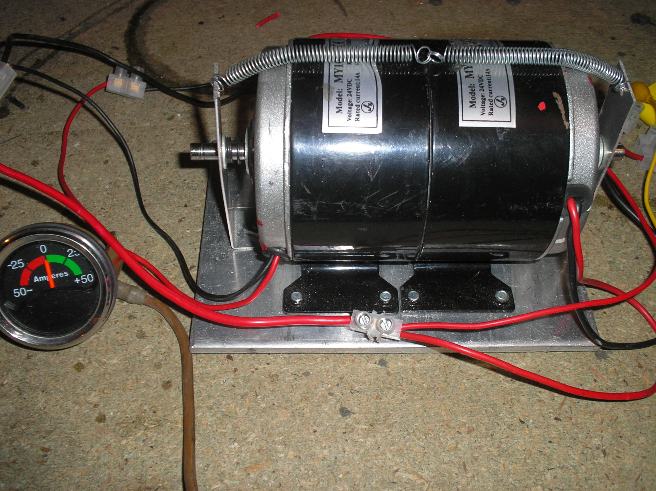

      • johnny
        hello this my first post ufo you are star hear is some pictures of my work so far
        i will go on the list after i come back from holliday
        • Originally posted by laserjo View Post
          Hi laserjo,
          Welcome! Please talk about your replication. Obviously you have UNITE motors MYxxxx. What types did you put together?
          I have UNITE morors as well. MY 1020 and MY1016. I'm goint to test them before in order to compare the success after rewinding. You can give valuable hints for rework!
          rgds John

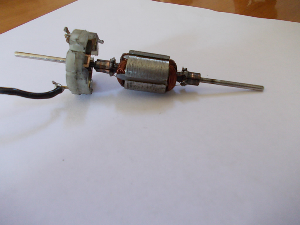

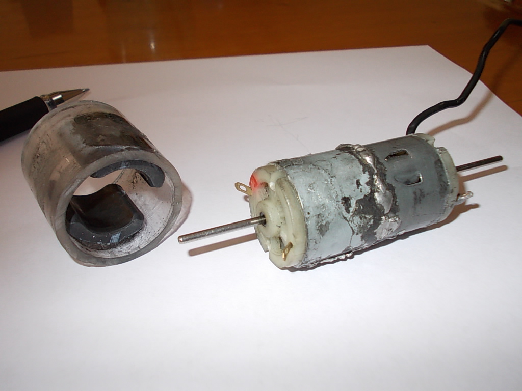

                            • Hi UFO,
                              Thanks for the quick reply. Let me first explain and clear up a few things.
                              - Sorry, my language may not have been clear, but I was simply stating the pulse rates which were working for me so that I may have a comparison with others. I had not noticed anyone else posting such information for those still working on the small motors. I certainly was not trying to set rules or guidelines for others to follow.
                              In fact you have now confirmed that these motors should operate at much higher pulse rates, so there is definitely something wrong with my builds.
                              - I looked at the winding videos you mentioned. I've also carefully looked at my windings configuration and that part seems allright. In fact I've been following john_g's excellent instructions for the 5-pole winding as per his post #93 of July this year. http://www.energeticforum.com/renewa...tml#post201543
                              - Regarding the brush orientation, yes the brushes are offset by 90 degrees from the connection terminal on these motors, so that part seems fine.
                              - I have previously built the metal version, as well as a version using acrylic tubing with the permanent magnets inside the tubing. Photo's below.
                              - Yes your suggestion of plastic wedges is a good one, and I had followed your instructions in a previous build, as per photo below:
                              I discovered that those plastic "cable-ties" make excellent wedges for these small motors and have only to be cut to the correct length. These should be inserted with the ridged side facing outwards so as not to damage the coil wire.
                              - On this current rotor I have used too much wire as you have pointed out. I was trying to reach a particular resistance (!). As there was no space for wedges I finished off by putting a thin layer of araldite over the windings to keep them in place. Obviously this did not help! (Plus now I will have a tough time removing the old windings)
                              - My reason for working with acrylic tubing: Simply because I find it easier to work with than metal. For this stator coil version motor I felt it would be more practical to have these large coils outside of the tube, so I used a narrower tube for the rotor. The reasons for using the acrylic tubing:
                              - It gives a rigid support for the two endcap commutator assemblies
                              - The two ends are in perfect allignment.
                              - The entire rotor-tube assembly, when placed between the stator coils, can then be easily manually rotated to tune the offset between brushes and stator coils, before being secured in position.
                              - The transparent acrylic tube allows me to see inside (and see the arcing!)
                              - I had cut cooling ventilation slots along the entire length of the tubing , it is difficult to see these in the pictures posted.
                              - The "fire-hazard" plastic around the stator coils is actually sticky tape. It is there to keep the coils from unwinding and also to secure the coils to the mountings. Admittedly somewhat overdone (!) I've cut away some of the tape in the picture below to give a better view. The core is made of cut pieces of welding rods that have been glued together .
                              - You are absolutely correct that the thickness of the tubing creates a large gap between the rotor and stator. I am aware of this and my thinking was simply that I could compensate by applying a higher voltage for now, as this was only a trial model.
                              - I do not have a tachometer so not able to confirm speed of the motor yet.
                              - UFO, my model making skills may definitely be lacking, but this was just a "rough" quick-&-dirty model to test the principles of pulsing a coil-stator model. (Even this "rough" model took me many hours of work). I have no intention of running this "fire-hazard" for more than a few minutes at a time.
                              Now, the odd thing is that all the versions I've built seem to run well on normal DC and seem to require less voltage to run than the original standard motor.
                              However once I apply pulsed DC I get the arcing and overheating problems.
                              Even this present version was working fine on normal DC (ofcourse the stator coils were drawing huge current). Pulsing the stator coils only, also worked well and brought down the current consumption. Pulsing both the rotor and stator in parralell again caused the arcing and overheating.
                              I've also checked my pulsing system by using it to pulse a normal 5-pole motor, and I am able to go up to around 15K to 20K without any problem. With these converted motors however, pulsing at higher than around 100Hz causes the motor to stall. I have also experimented with varying the duty cycle from about 30% to around 90%.
                              After repairing this rotor I will test a little more, and if possible I'll make a video which maybe you could have a look at.
                              Thanks for your patience!
                              Best wishes
                              Anoop
