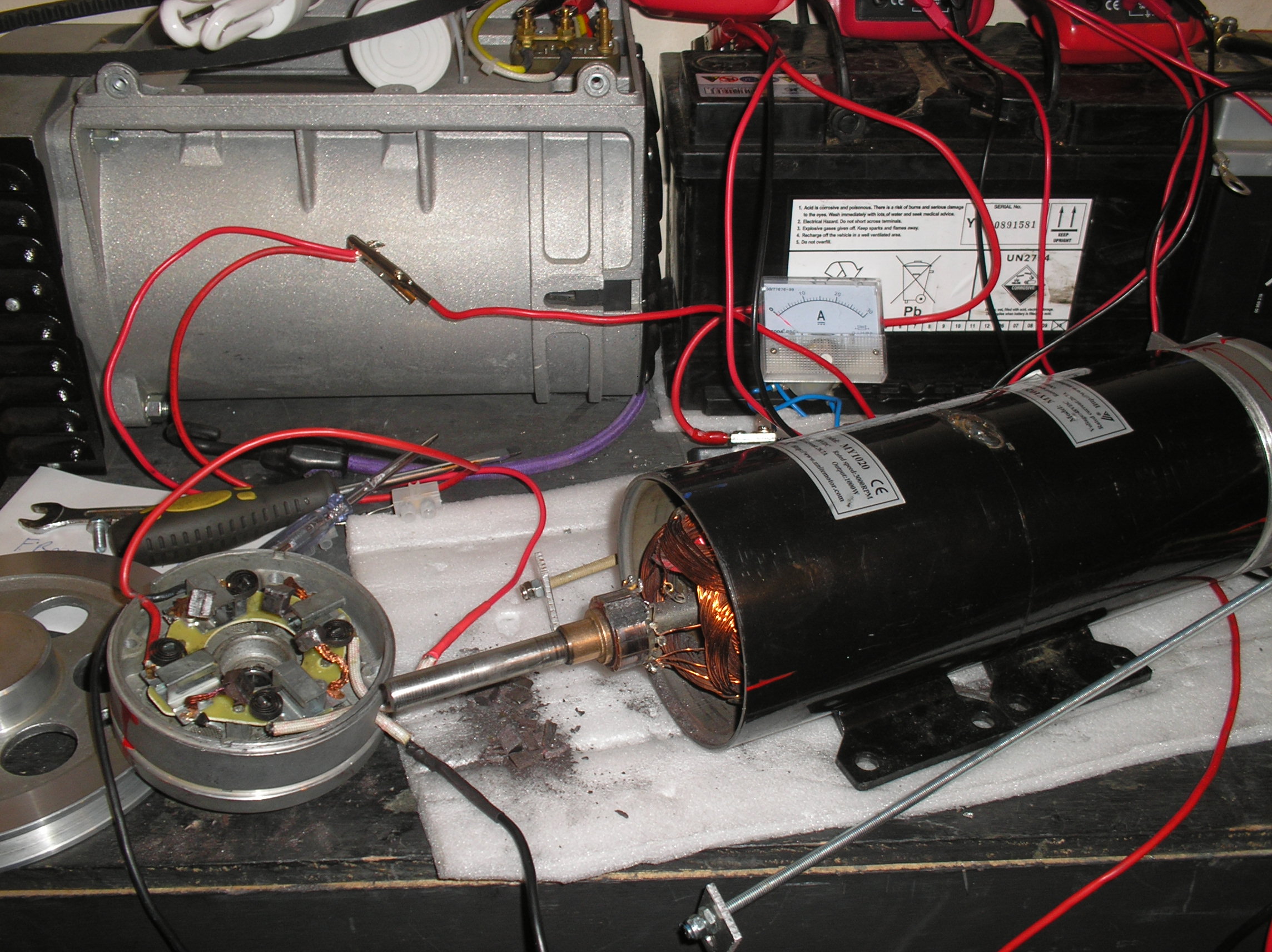

              hi thanks john stone and ufo .i am working on the info for the motors now i hope you like other picture the big motor is not doing so well yet?

                          • Originally posted by laserjo View Post
                            .... i hope you like other picture the big motor is not doing so well yet?
                            Hi laserjo,
                            sorry for your lost commutator. Possible reason - see below:
                            @ALL: If you press the second commutator on to the shaft please do it UFO-like.
                            1. He suggests to widen the hole of the commutator or sand down the shaft until the commutator slides smooth to its place by hand.
                            2. Make some marks on the shaft with a chisle parallel to the length of the shaft.
                            3. Press the commutator to its place. The markings will prevent it from turning on the shaft later on and same time limits pressure..
                            This way you do not explode your commutator.
                            If being fixed by pressure only it needs pressure like a ball bearing but the tiny ring inside the commutator can not hold the pressure.. Perhaps DadHav can do the precision machining to get the right balance of forces - me not and most of us not. So Ufo recomments to fix the commutator in place by means of chisle markings. (I hope my restricted English is understandable - if not please repost a corrected version)
                            JohnS
