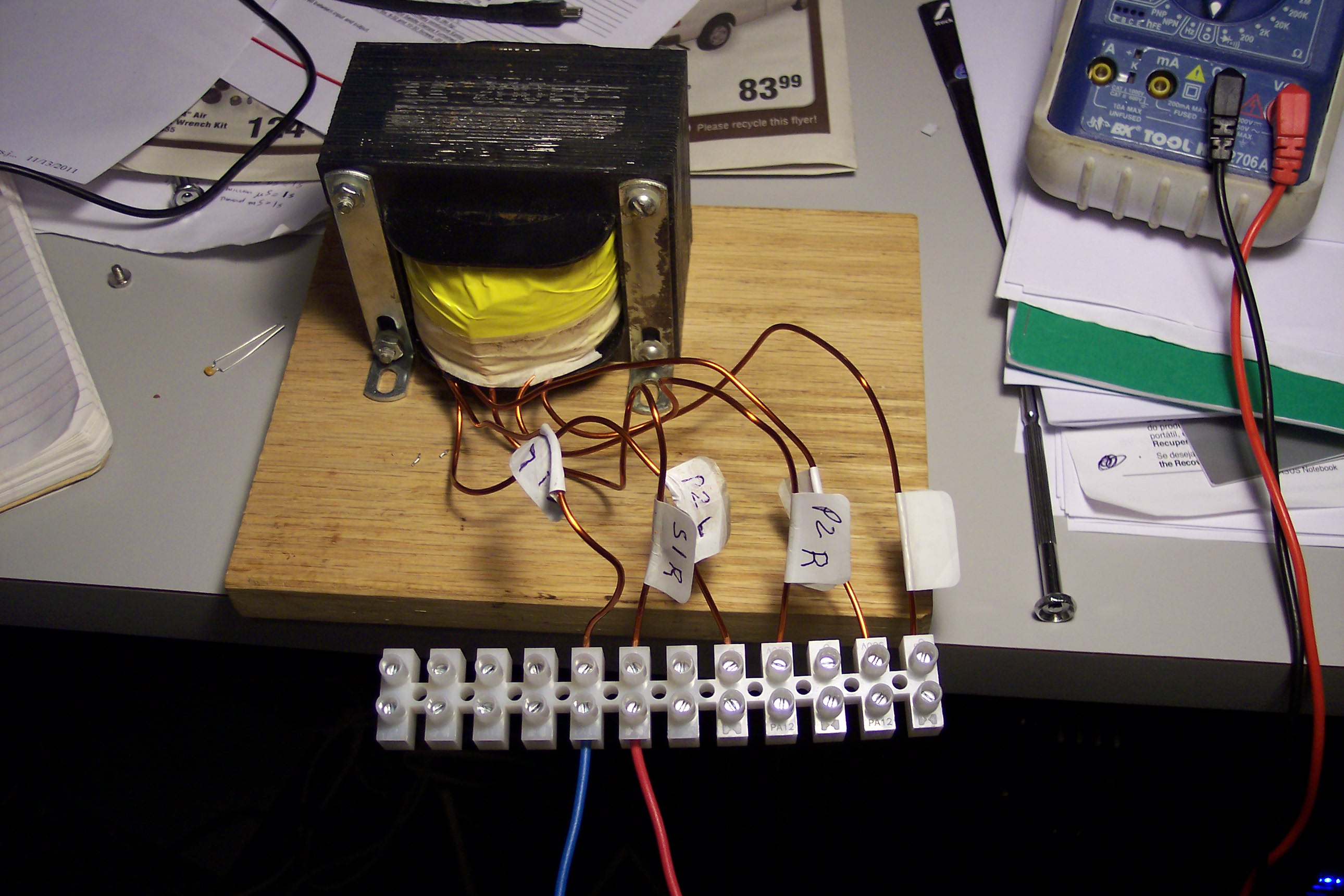

        Hello All,
        I see quite a few have downloaded my first version of the winding estimator. Did anyone compare their actual windings to the calculated estimate?
        I have finally wound this transformer and came within a few feet of the calculated estimate. I have updated the estimator to show percentage fill of the bobbin.
        This is my updated version to ESTIMATE the amount of wire needed to wind a transformer that Matthew describes. Download the file and rename it from TSWindings-v2.xls.pdf to TSWindings-v2.xls so you can open it in Excel. The calculations are based on how much a single winding will fit on a spool perfectly wound and then calculates the lengths of the primaries and a secondary which is 25% longer than the primaries. It also shows the percentage the bobbin is filled. The Test data is based on a 200VA 120V-24V transformer that I have dissassembled and measured the bobbin dimensions.
        Enter the diameter of the magnet wire and the bobbin dimensions.
        To remove a layer, delete the highest layer number. To add a layer type in the next highest layer number.
        Aim for around 80% fill of the bobbin and you should be very close. My calculated lengths were 38 ft primaries and 48 ft secondary. If my thumbs weren't so sore, I would have fit all the wire on the spool. In the end I used 34 ft primaries and 43 ft secondary using 14 awg. So it was pretty close. Your mileage may vary.
        Good luck.
        Alex

                dear hherby,
                it'd be even more convenient to convert the estimated wire length used to a number of turns on a designated bobbin, don't you think?

                  Thanks for taking the time to look it over and responding.
                  It basically does the calculations with full layers and at the top left it shows how many turns per layer. It also shows how many turns per layer per strand. It rounds down to the nearest multiple of 3 strands. The calculations came out close enough for me. Since I haven't received any feedback from those that have wound their own transformers with regards to actual windings vs calculated, I only have my own results as a basis for the calculations. It has come out close enough for me so I will not be posting any updates without results from others.
                  I am currently rejuvenating my batterys while I build and program my controller board (avr based). I will be using Solid state relays and have done some preliminary testing of firing the SSRs using the SG3524 circuit that JB posted early in the thread which I had used on a 6 switch version.
                  Good luck with your replication.
                  Alex
