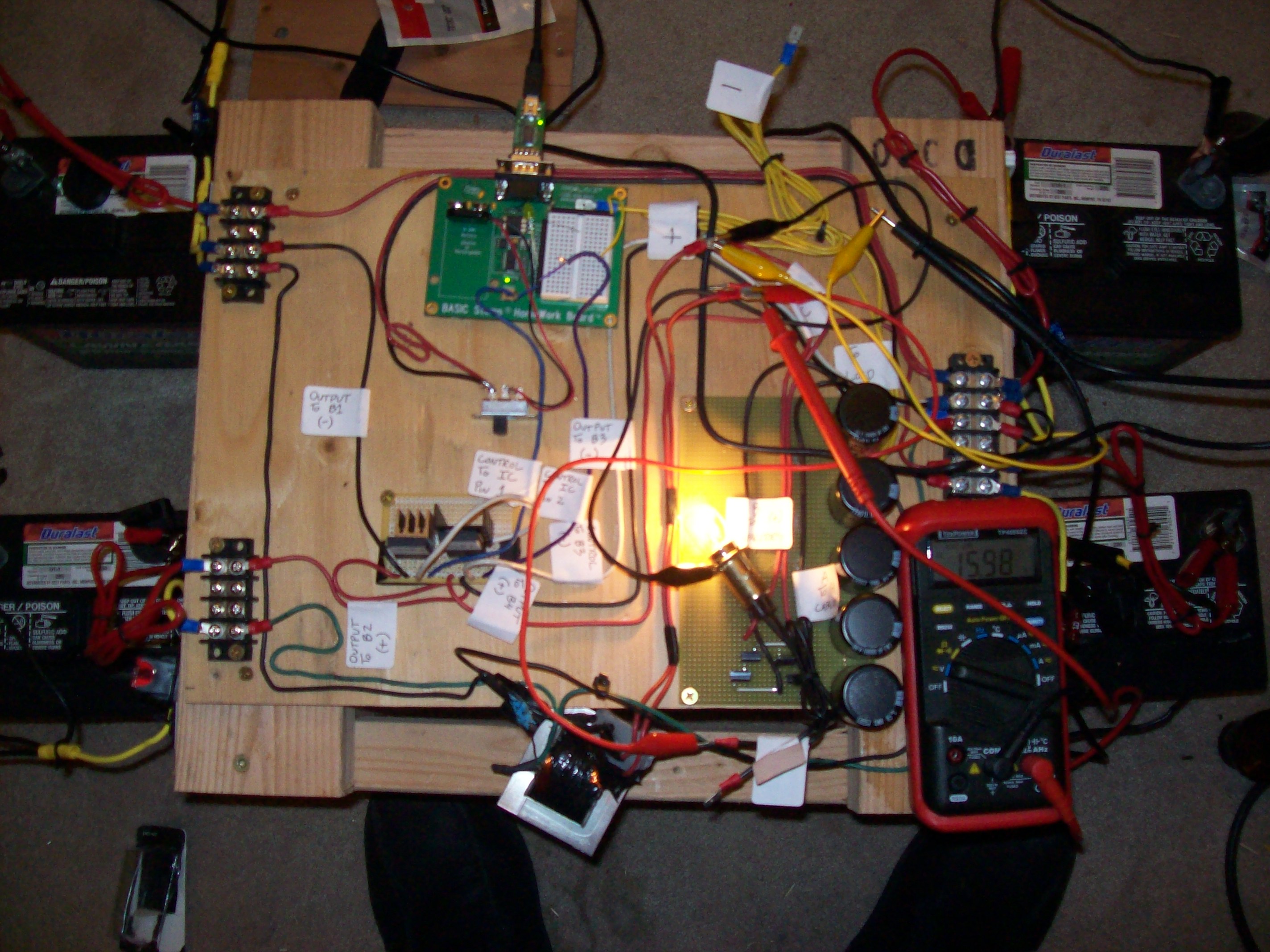

                • Yay!
                  Good news!
                  I got my switch up and running. I put some heat sinks on my chips and am running 10 amp fuses. It wasn't really neccesary though because the chips aren't even getting warm. The only time the 5 amp fuses were blowing was during the safety testing and I had 2 second long pulsewidths.
                  Anyways so nowI get the best voltage out of the transformer at a pulseout of 5100- which is 10,200 microseconds or about 10 milliseconds. Is this in the ballpark of what everyone else is getting?
                  Secondly, The AC voltage I'm getting out of the battery is about 17 volts with no load connected. At first I thought it would be higher because you get 12 volt peaks in each direction so I figured AC would be around 24 volts or more considering the output winding is 20% longer. But then I remembered meters don't measure peak to peak they measure RMS so 17 sounds about right. Is that what you guys are getting too?
                  I have yet to actually start load testing times, but will start that soon. Attached is a pic of my setup
                  Please help support my indiegogo campaign: Cosmic Induction Generator
                  • Also the VDC out at the capacitors is 14.2 volts. Again does this sound ballpark to you guys?
                    • Congratulations!
                      Glad you got it going. That is a nice looking build. Yes all of your values seem to be right in the ballpark for a rewound transformer. So now you get to have fun testing. Just take your time and document everything so you can see what works best.
                      Carroll
