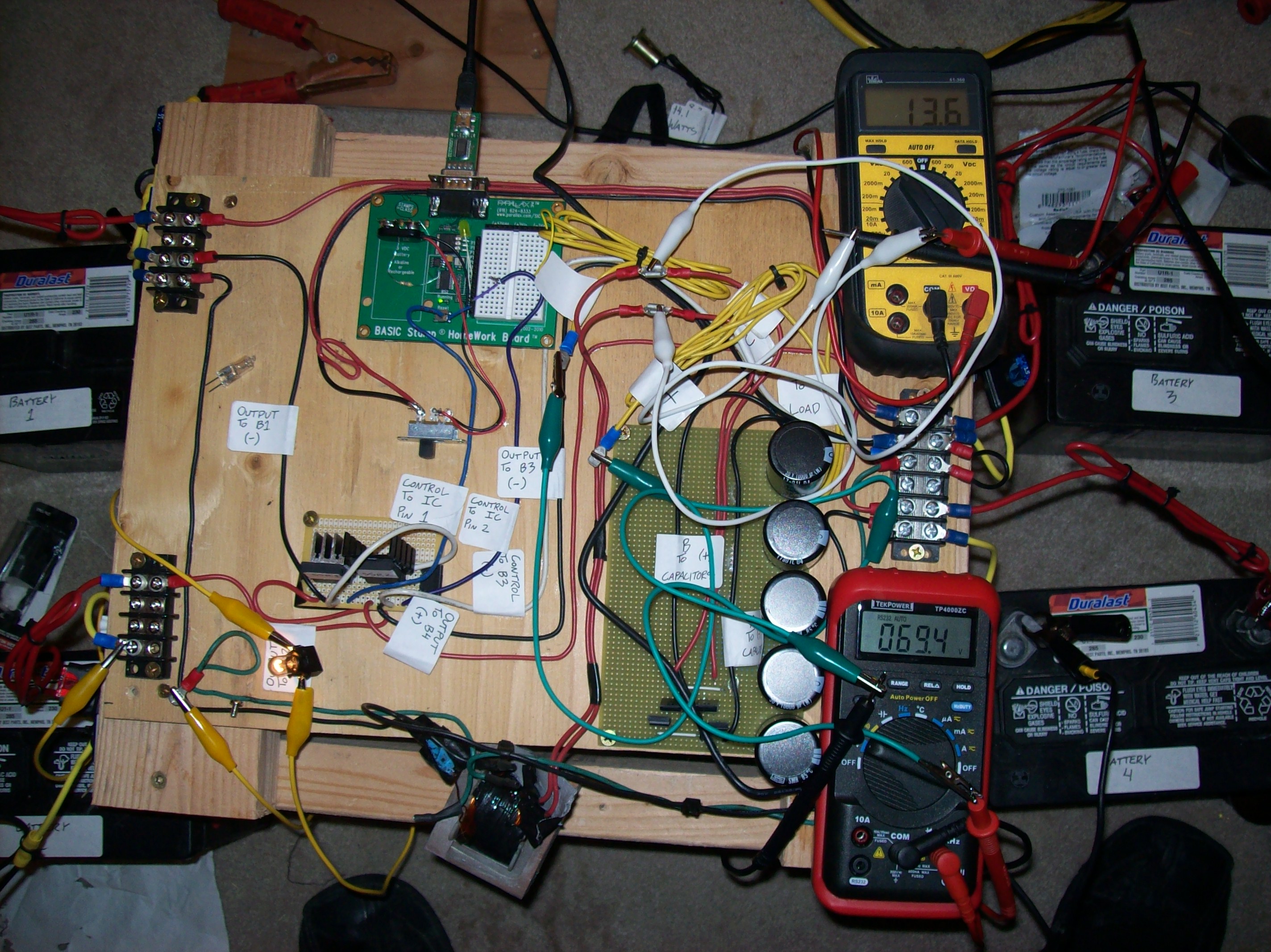

              • Readings
                Here is a picture of what I'm claiming. In the lower left corner you can see the yellow wires with alligator clips. They are connecting the bulb in series with the green winding primary.In the lower right corner you see the meter reading 69.4 volts. This is connected to the green wires with alligator clips, which in turn are connected to the output at the caps. In the upper right corner you see the other meter with a reading of 13.6 vac. this meter is connected to the output of the trafo(red wires) with the white wires with alligator clips
