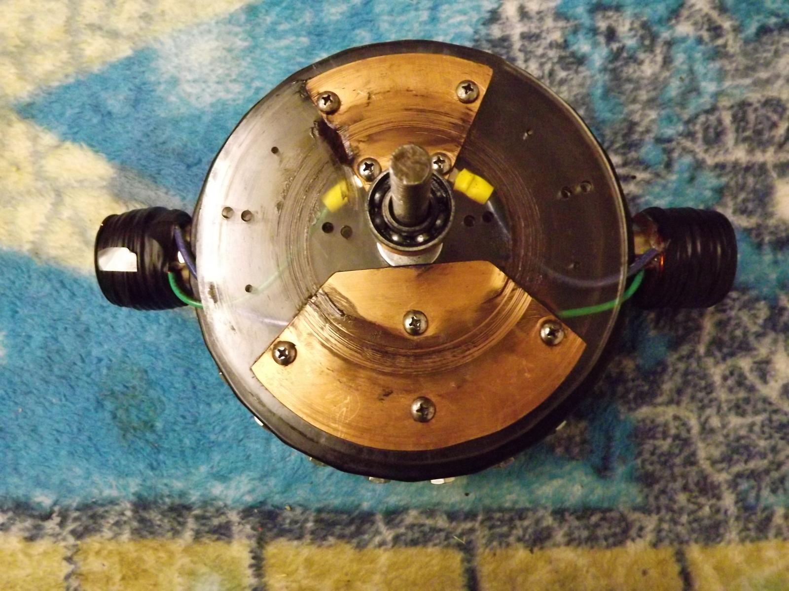

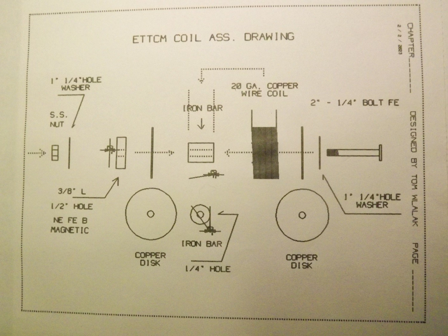

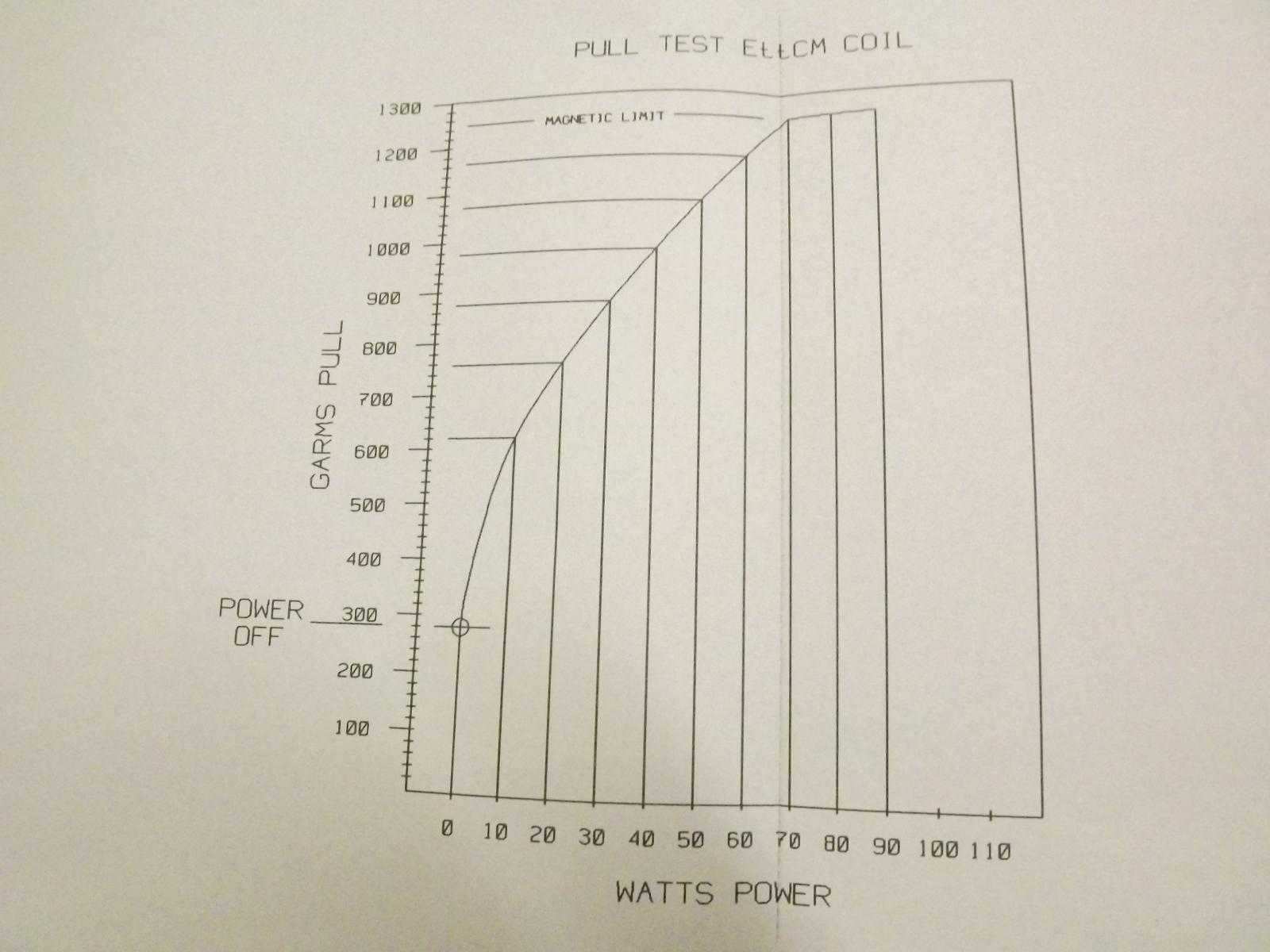

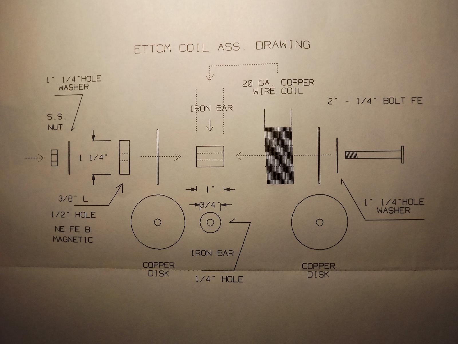

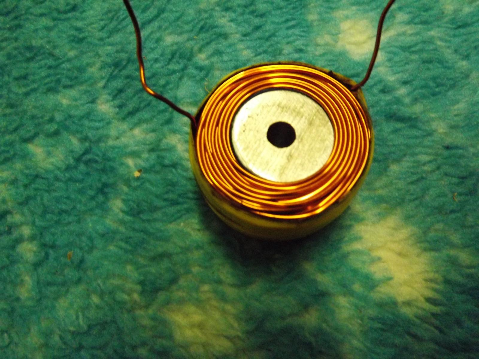

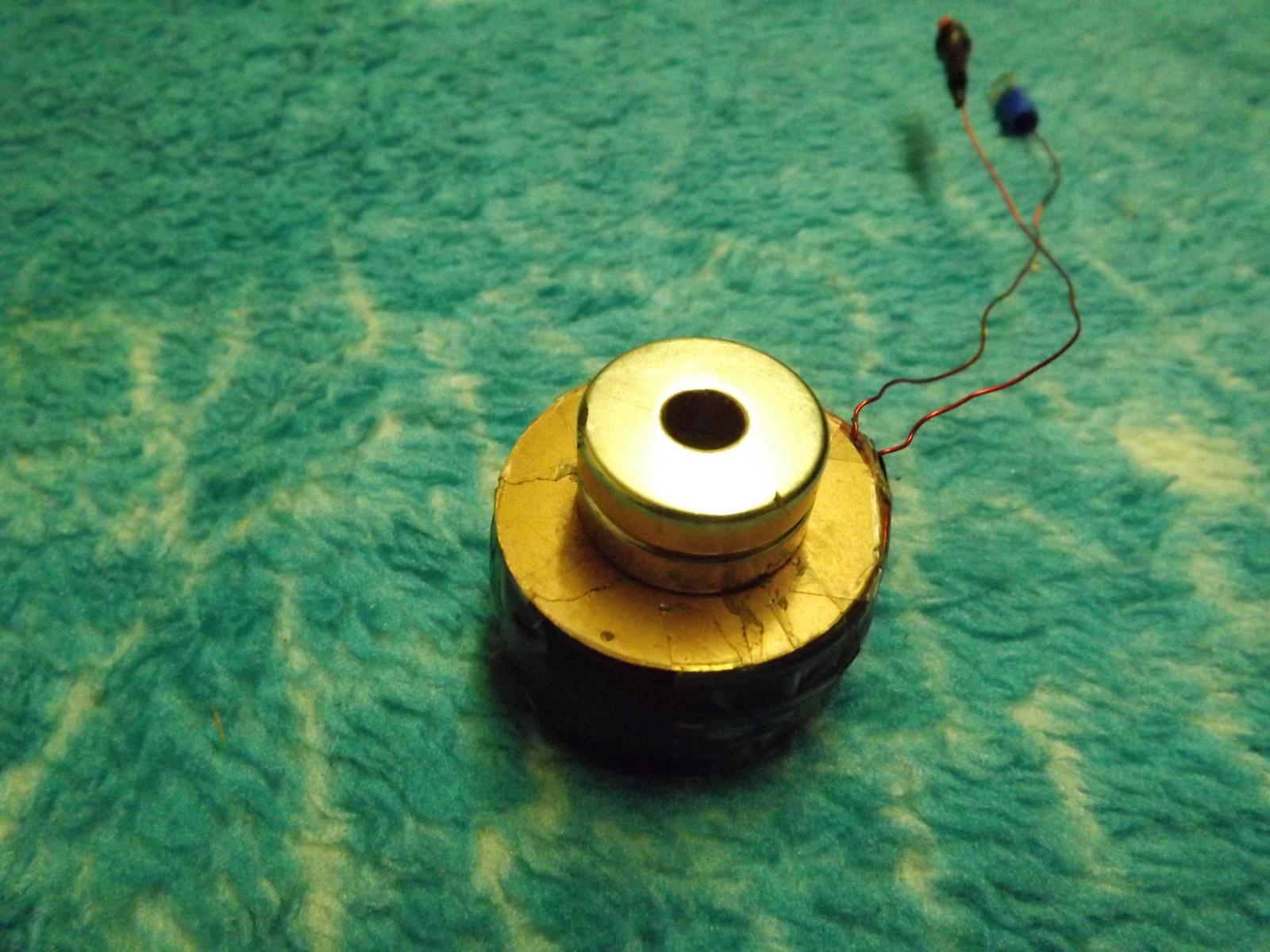

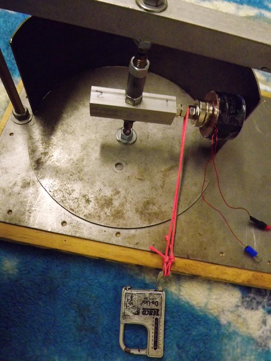

      To Start with this is the EttCM coil design it produces about 3.84 times more output power of attraction than a normal electromagnetic coil at the same input watts
      Dc. constant current - ( no pulse power needed )

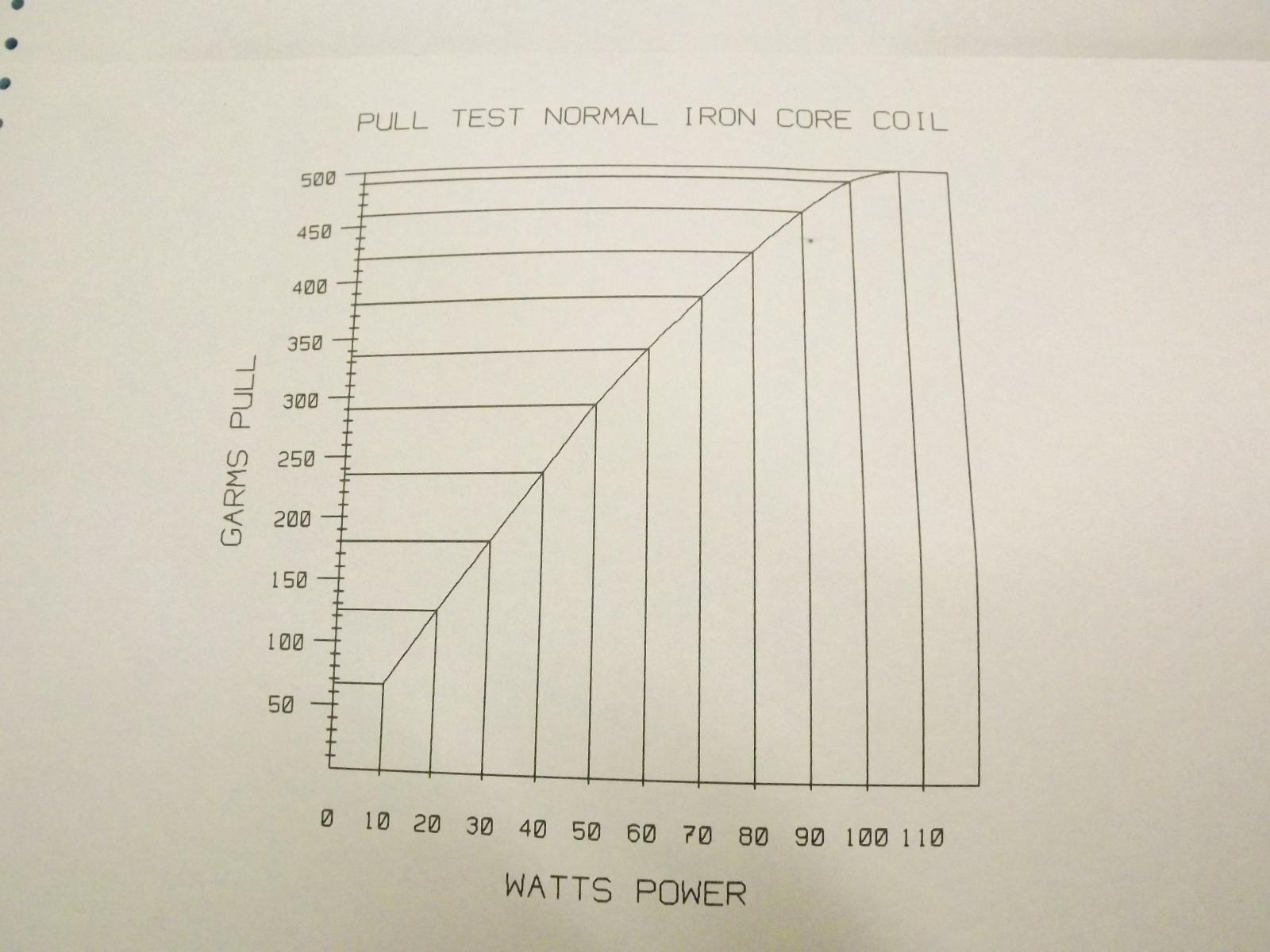

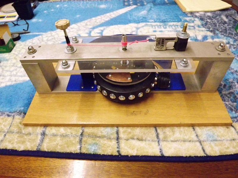

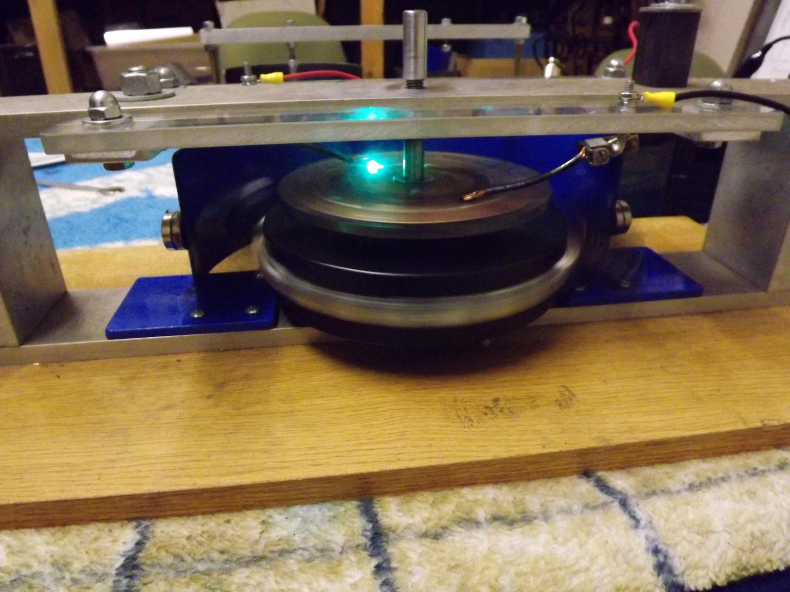

      This is a testing prototype motor tested on 12 / 7 / 2022
      The input Dc current is 70 watts
      The output of the EttCM coil produced 230 angler torque conversion from Permanent magnetic power
      The electrical input is not used as output power only conversion of permanent magnetic power to energy output power;

              Tom,
              I found this video:
              Short summary of how I currently understand it (please correct anything wrong):
              • Input shown on supply: ~85–90 W
              • No-load speed: ~640–686 rpm
              • Output estimated ~295 W mechanical from static pull test → ~3.3 : 1
              • Principle: permanent magnets do the real work, coils only provide timed ~4? boost + near-perfect cancellation (not classic over-unity).
              Four quick questions when you have a minute:
              1. Has torque/output ever been checked dynamically under actual rotation with any kind of brake or load (prony, fan, pump, etc.) instead of just the static pull test?
              2. Has input power ever been measured with a scope + current shunt (or a proper DC power analyser) to confirm true average power under pulsing, or are we only going by the power-supply display?
              3. With the highly inductive pulses and mechanical commutator, what does the power factor look like, or have you ever logged instantaneous V ? I to see the real energy per cycle?
              4. Has anyone you know put a measurable load on one of these and recorded both input change and useful shaft power?
              Even a 30-second clip with a small brake or a scope trace on the input would answer almost everything for most of us.
              Thanks again for openly sharing all the info.

                  Hi Tom,
                  At 680 rpm on 85–90 W the rotor is absolutely doing real work. It is already developing exactly the shaft power needed to continuously overcome every internal loss: bearings, air drag, eddy currents, brush friction, magnetic hysteresis, etc. That’s the motor’s natural balanced speed, just like the horse hitting a certain speed, but not pulling anything more than itself. The power is real; it’s just all being consumed inside the machine itself right now.
                  What is still missing (and what almost everyone keeps asking for) is simply to move a portion of that developed shaft power to an external, measurable, variable load so we can see three very basic things:
                  • How much the input current/watts rise when we deliberately extract, say, 50 W → 100 W → 150 W of useful work
                  • Direct measurement of that extracted mechanical power (prony brake, belt to a fan or small generator, rope + spring scale, etc.)
                  • How the overall efficiency behaves when we actually pull usable work out of the shaft instead of letting it all dissipate internally
                  Even a super-simple setup that lets you pull just 50–150 W continuously while logging input watts would instantly answer practically every remaining question for the wider audience.
                  Thanks again for the patient explanation, for confirming the multiple test methods all agreed within 5 %, and for openly sharing decades of work. I’ll go through the drawings and older data posted under both Dr. Wlazlak – EttCM and Tom Wlazlak – magnagravity; clearly a lot there already.

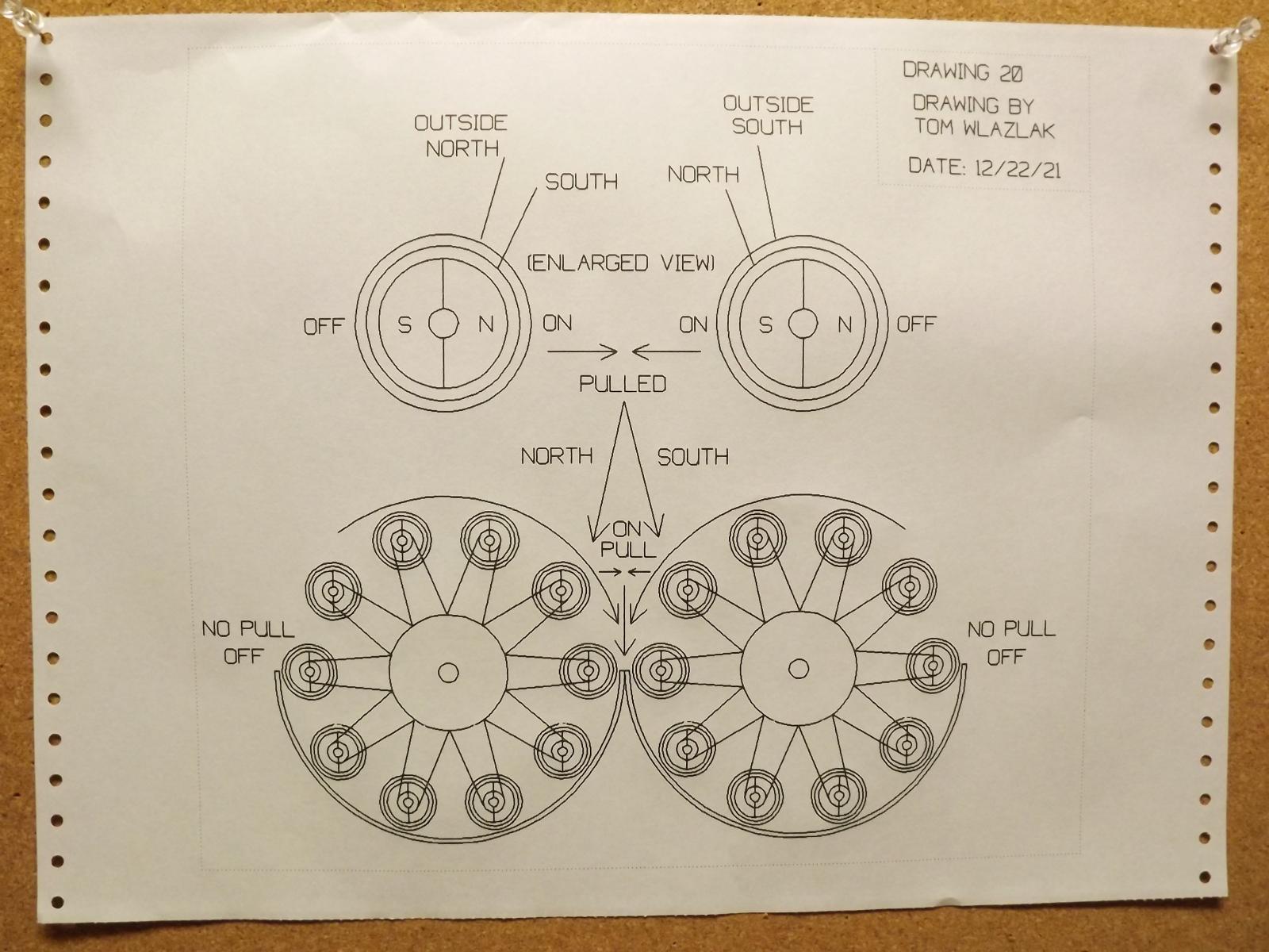

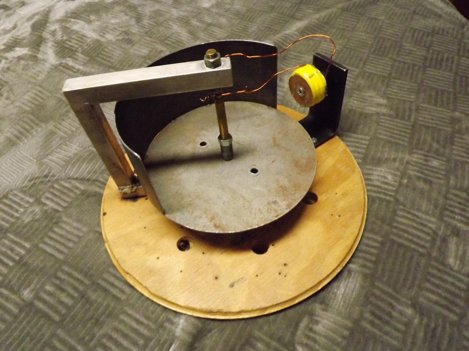

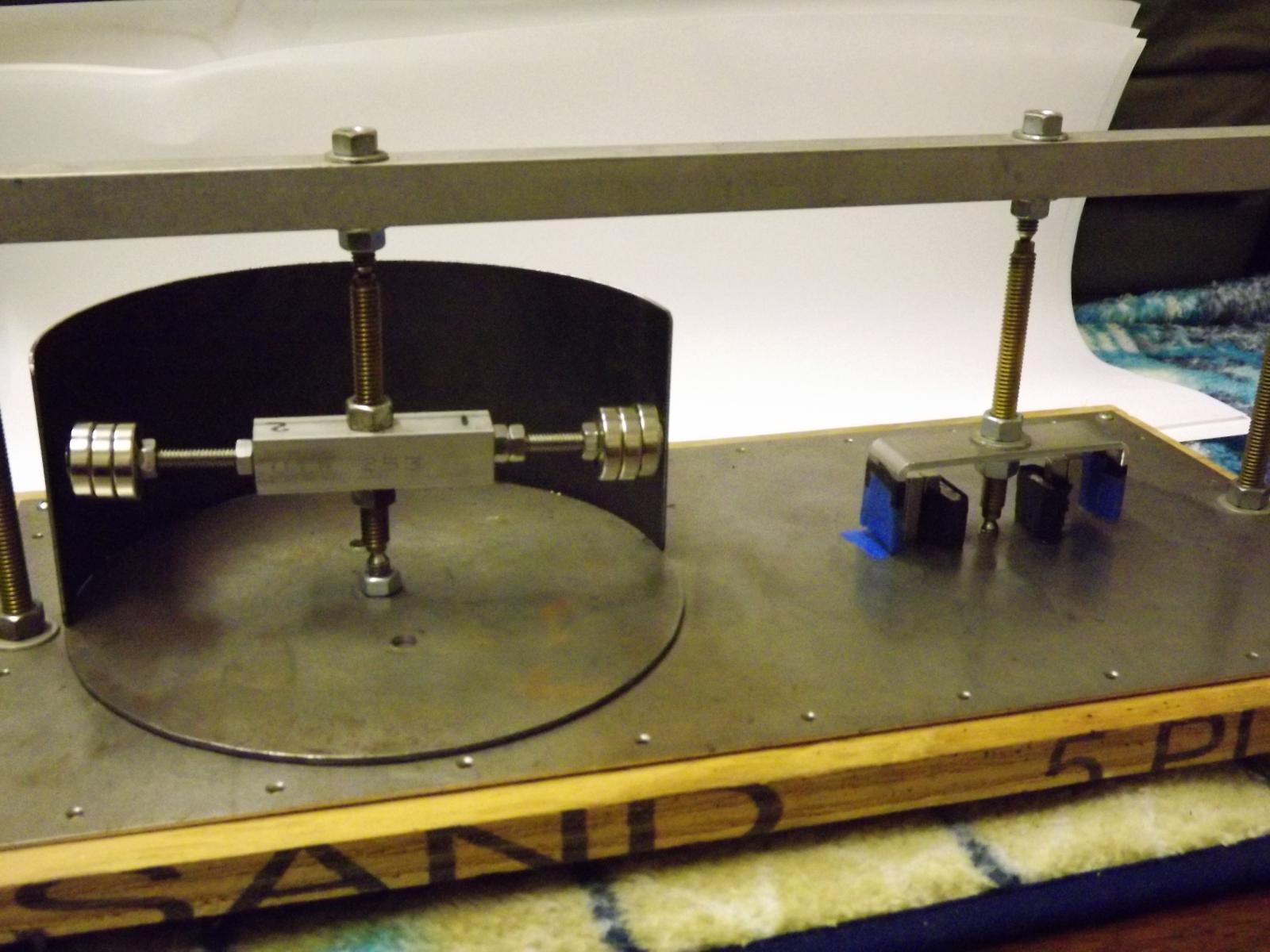

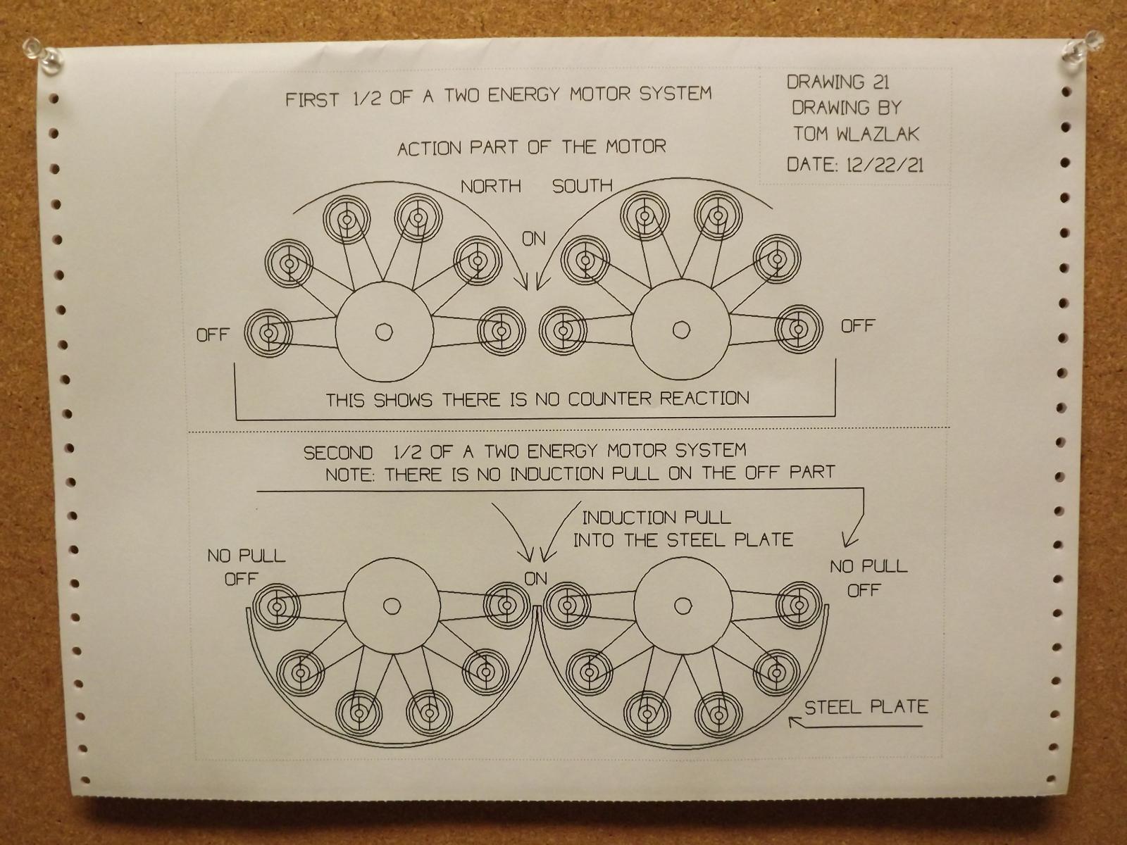

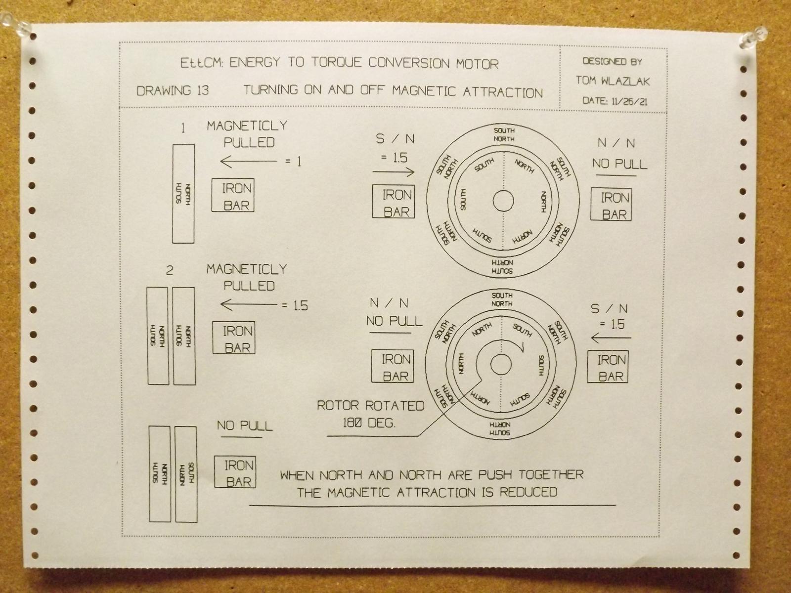

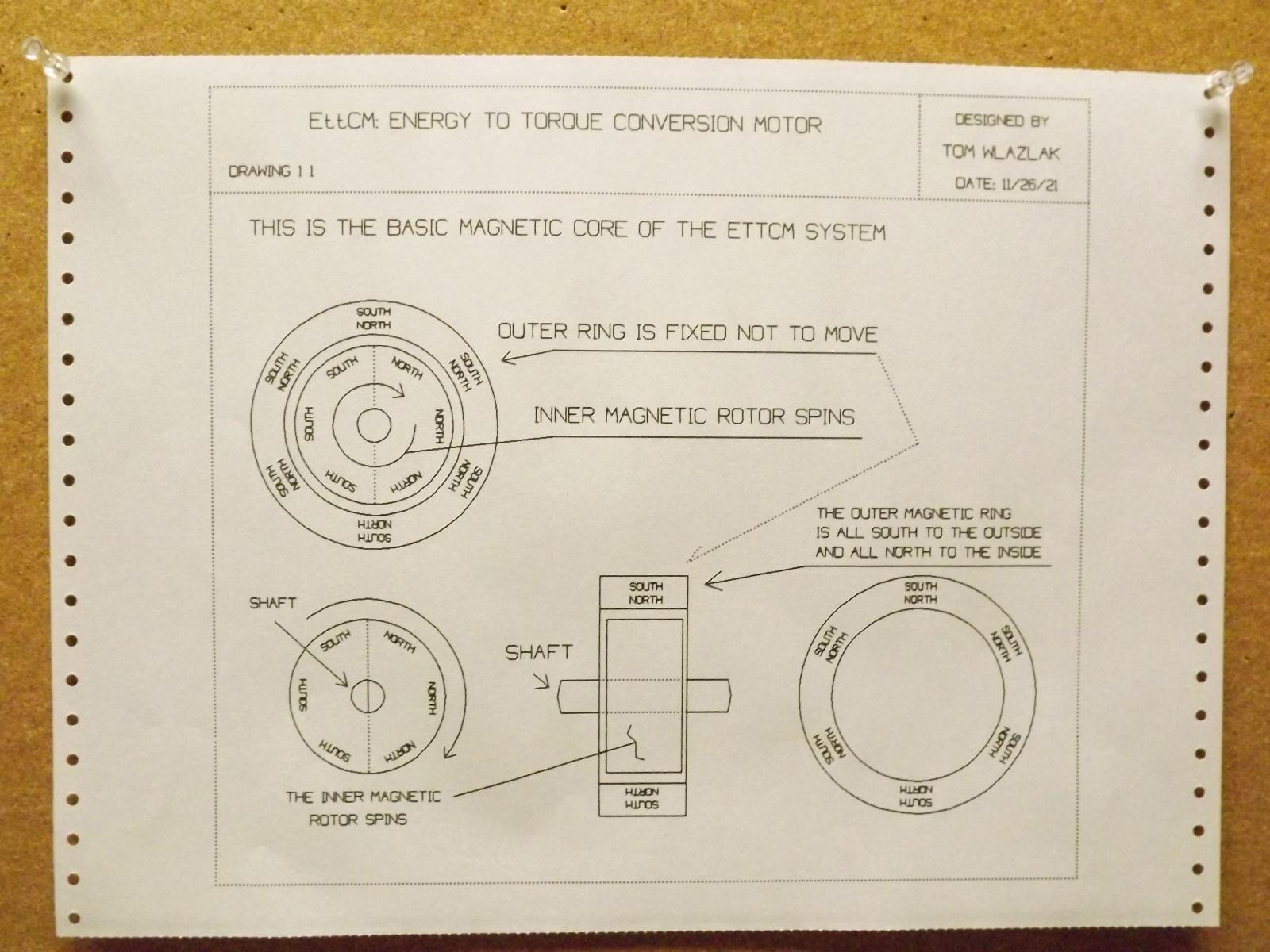

                      Here are files from Vinyasi's site regarding this: EttCM
                      Thanks Tom for allowing Vinyasi to post all of this publicly. Much to learn!​​
                        Here's a few more...
                        • #13
                          Here's more...
                          • #14
                            Another one.
