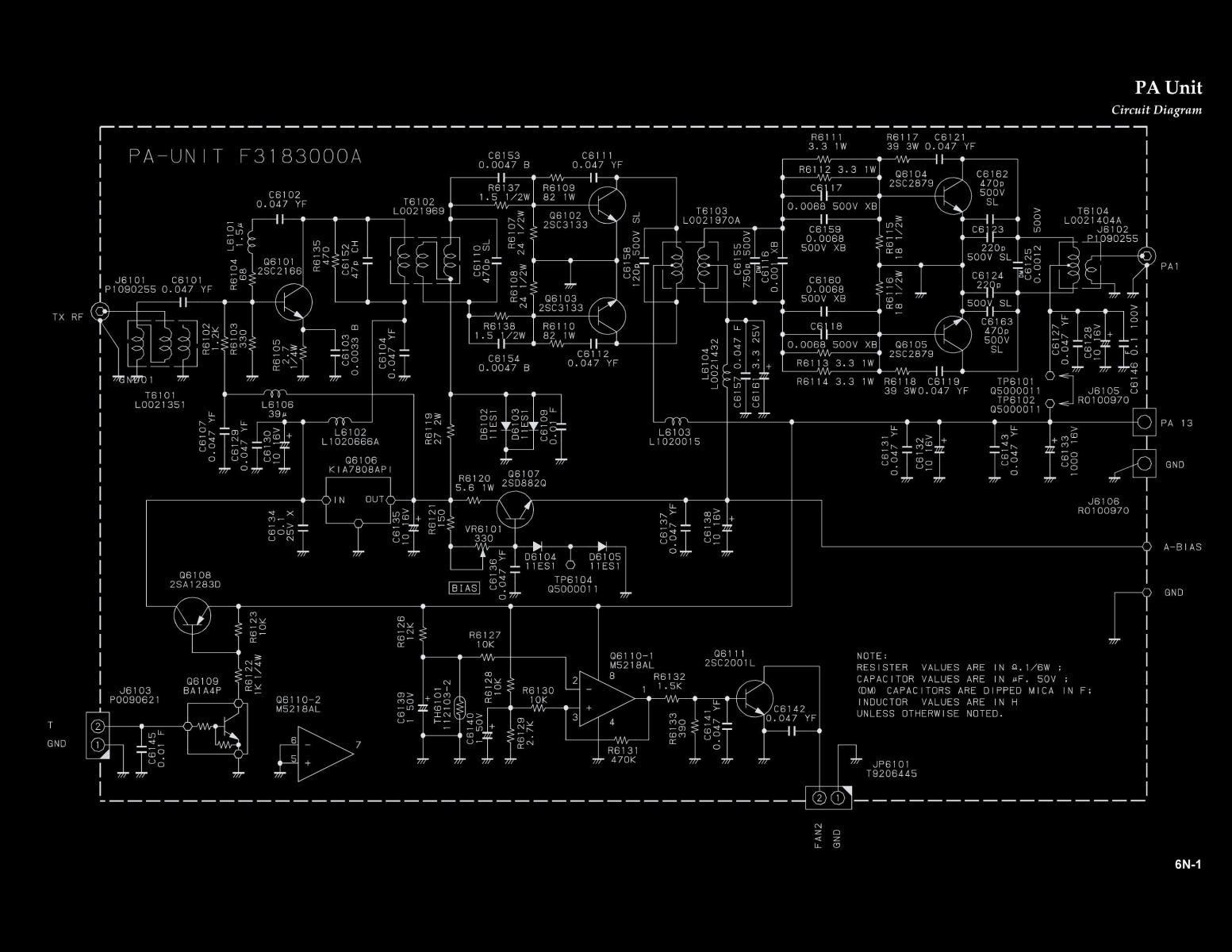

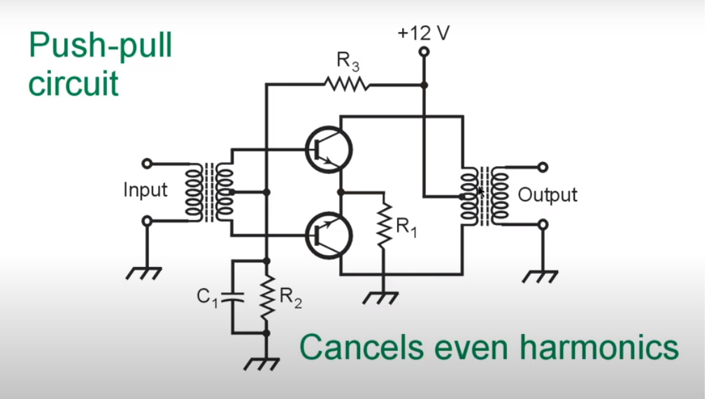

I think that my answer in my post (#67) in this thread applies here as wellOriginally posted by Buddhafollower View PostIn this image below there is a power stage with two NPN transistors.
There is a resistor in series with a capacitor that goes from each collector to each base. I believe this to be negative feedback. Based on what can I calculate the values of the components?
or at least for the capacitor value
I could write it out better if it does not make sense.Last edited by spacecase0; 07-28-2021, 07:23 PM.
This negative feedback i imagine has the advantage of increasing the bandwidth of the stage i guess. But how can i calculate the value of the resistor? I mean based on what parameters? Because as you said the capacitor will be one that has an reactance of 1Ohm at the lowest frequency which in my case is 1MHz and so the capacitor will have a value of 150nF. 150nF capacitor has a reactance of 1.1 Ohm at 1MHz which for me is close enough. And so in this case what will the value of the resistor be? Ten times the impedance of the capacitor at the lowest frequency (1MHz)?
Sorry for writing in big letters, it is quite hard for me to focus my eyesight when the letters are 12.Last edited by Buddhafollower; 07-28-2021, 09:08 PM.
http://www.zen22142.zen.co.uk/Design/lazarnfb.htm
Here it says that for a certain amplifier, the feedback equation is this one:
Rfb = ((Vcc / 2 ) - Vbe) x B1 / I1
I took my 15.5V and divided it by 2 so i got 7.75Vdc from which i subtracted 0.7V so i was left with 7.05V. Then the beta of the transistor 2SC3264 is 140 and this value i divided by the current for one transistor which is about 80mA. So overall i got a resistance of 12Ohm.
And so if what you said is correct, the i will have a resistance of 12Ohm or 10Ohm in series of 150nF capacitor.
Is this right?

my only question is if you got the idea that if you are using a transformer,
and a center tapped one,
did you think about how the individual transistor is a pair, and needs half the impedance as the entire system

So each transistor has assigned one half of the power transformer.
