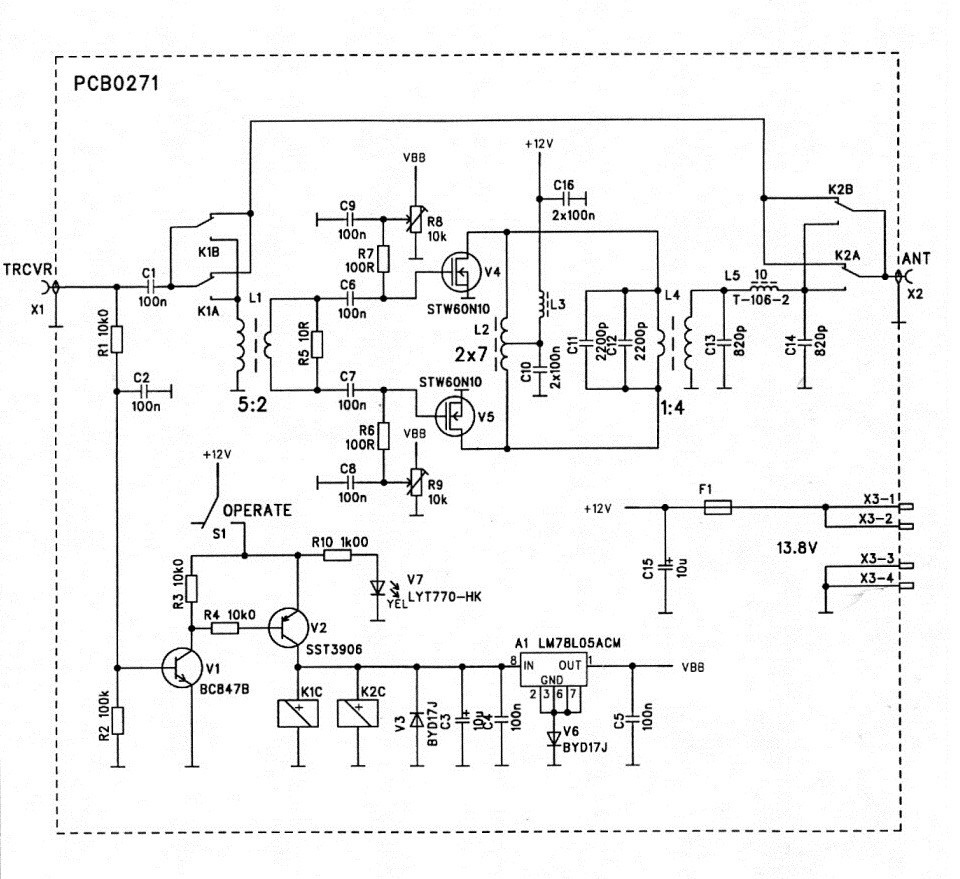

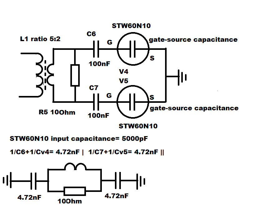

        • #19
          You see in this image there are two capacitors at the input of the amplifier. Two capacitors of 100nF after the secondary of the signal transformer. How do I calculate their values? If i follow the example you gave me with the input impedance, there will be two capacitors of the mosfets in series with these two capacitors of 100nF. Is it accurate?
          In this second image that I uploaded i specified how I see things.

            your second image seems to be correct to me.
            the 10 ohm resistor in there is going to set most of the input impedance
            and with that 5:2 transformer... (2.5 (turns ratio) squared gets you impedance ratio, so 10ohms times 6.25)
            is that 62.5 ohms in for just the resistor and transformer,
            and it is lowered by the 4.72nF to ground, but that will change with frequency,
            so, my guess is they are trying for about 50ohms in with that circuit (as that is a very common input number in radio electronics.
            and likely your signal generator is 50 ohms out as well (all of mine are).

              I was thinking that they put they two 100nF capacitors there in order to slightly decrease the gate capacitance. That's why I had drawn them like that in the second image. This value of capacitance is appropriate for the frequency they use also decrease the input impedance of the mosfets a little. That's what I think. That's how I see the problem. They chose a value that will have a low reactance at certain frequencies.
              • #22
                the capacitor is in there because you need to isolate the DC for the bias voltage,
                they chose a value that is 25 times the gate capacitance, that is large enough not to loose much.
                you could choose larger value, but there is no point, and you just risk DC leakage.

                  In the above image of the amplifier I got an input impedance of the mosfets of 31.84Ohm( at the frequency of 1MHz). The ratio of the transformer will be 1.253 from my calculation. What I don't understand is where did they get the 5:2 turns? You said the ratio is 2.5 but I still don't understand... I don't understand what is the purpose of that resistor parallelled with the secondary of the input RF trafo and how exactly is that going to set the input impedance since I done the math and got a totally different thing?
                  • #24
                    Yes, well... I guess you are right. I did the calculation for the 30m band, meaning 10.15MHz, and indeed the ratio is 2.5. But still I know not how they picked the 5:2 number of turns. If I divide 50Ohm by 2.5 I get 20. So I guess that will be the ''2''. Or you round it up to the nearest full number. And then you have 2.5*2= 5 turns. So we will have in the primary 50Ohm, 5 turns and in the secondary, 314.46Ohm, 2 turns.
                    You have to know that I divided the bigger impedance by the smaller (50Ohm). I had no other choice.
                    Please correct me if I'am wrong.
                    And still I do not understand. From where is this 5:2 number of turns? So 4 divided by 2.5 is 1.6 and it doesn't work well enough. Then 5:2.5= 2. So 5:2.
                    But then another question arises in my unripened mind, which is why is the secondary of 'two turns' supplying the gates of the mosfets with signal? I don't get it.
                    I guess that you will feed a smaller inductance to a higher impedance.
                    • #25
                      5:2 refers to 5 turns on the primary and 2 turns on the secondary.
                      the ratio of 5/2 is 2.5, but that is for voltage and not impedance
                      impedance ratio = turns ratio squared.
                      and that would be 6.25 for the 5:2 transformer
                      and looking at your math, you are dividing the wrong direction,
                      the lower number of turns will have the lower impedance.
                      so the 2 turn side is 8 ohms if the 5 turn side is 50 ohms.
                      the 2 turn side is run it into a 10 ohm resistor, so that gets it all pretty close without the mosfets even being connected.
                      the mosfets are an additional load, so it lowers that 10 ohm number a bit (the target being 8 ohms)
                      the reason why they do all this is that radio waves in a circuit will bounce back if they hit an impedance that is not the same as where it came from.
                      the more the impedance mismatch the more of the radio wave is bounced back.
                      radio waves coming back into the input can do bad things
                      so, you have to set up the input of the amplifier to match your source.
                      and transformers can't easily be made with partial turns...
                      you also can't have to many turns or you can over magnetize the core...
                      so you might not have ratios like 12:3 (that might be a closer number match for this circuit)
                      so there are limits.
                      the impedance of the mosfet input is reasonably high,
                      so they needed additional load (the resistor)
                      and they needed the voltage in to the gate of the mosfet to be in the correct range, and this also sets the turns ratio of the transformer.
                      so whoever designed this circuit likely choose values that are close enough for a wide range of conditions
                      designing is all about tradeoffs, and this circuit is not bad at all.
                      make sense now ?

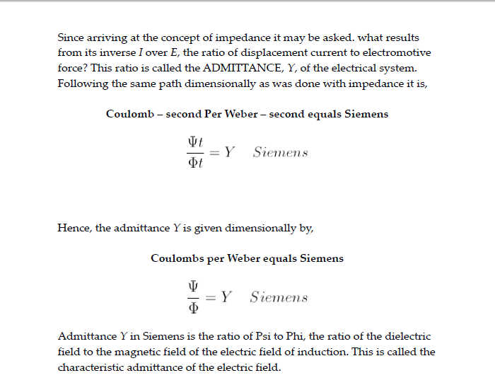

                              The ''S'' I believe stands for ''Siemens'' and it is a measure of Admittance. Here Dr. Dollard puts it like this.
