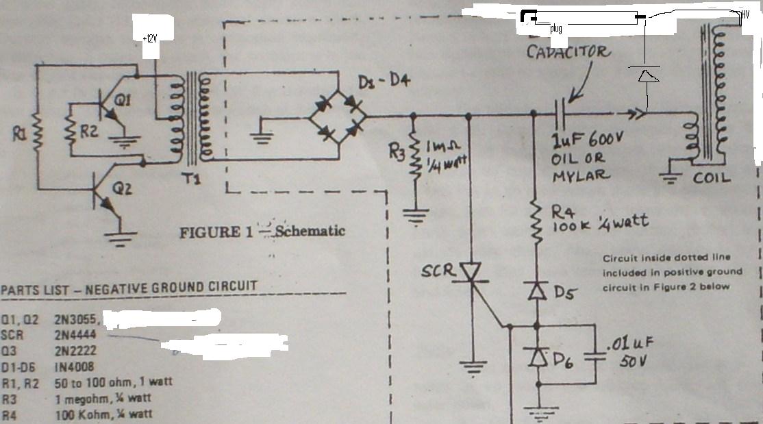

Anyway, dingo, try to connect the primary of the ignition coil in reverse and/or to provide a small air gap (1mm) between the HV and the LV circuit. The LV must be allways connected to the spark plugs.
The spark plugs and spark plug wires must be resistorless.

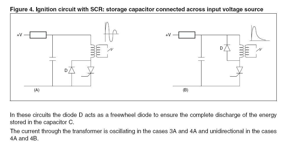

At the same time, it probably matters how the capacitor is connected inside the CDI. My CDI had it connected to the ground and to the ignition coil. Then the thyristor (SCR) connected between the ignition coil and the ground.
