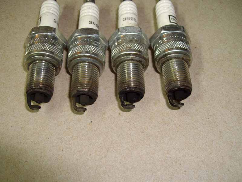

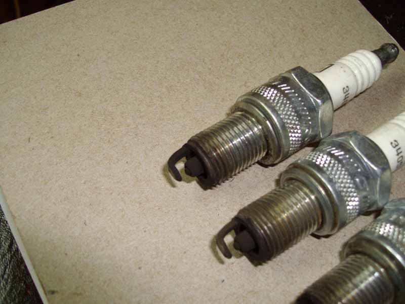

            I was hoping to have good results to share but unfortunately I do not. I was almost through an entire tank of fuel running the plasma circuit, until the other day when the motor just quit running and I had to change the plugs. I got 250 miles on this tank of fuel when I normally get 300 or slightly more (303 to 305). These plugs where the Champion Platinum plugs that I installed just under a month ago. I ran with the plasma intermittently for roughly 300 miles due to cross talk issues and finally 250 miles on the last run. I average 350 miles a week, so X 4 weeks = 1,400 miles total on the plugs. As you can see by the pictures, there is a lot of carbon build up from what I believe is due to the O2 sensor compensating for the lean burn. This would also explain the lower MPG's. You can also see by the pictures that the electrode has practically burned right off. The plug gap was factory to start with at .025" and the end result is .070".
            So end result is that I believe that the fuel consumption can be resolved by an O2 modifier and possibly water injection to compensate for any exhaust temperature increases. But the plug wear is not acceptable. Bill's system runs right of of the inverter at 115 to 120vac rectified and I am using a 16uf capacitor. Possibly higher voltage and lower capacitance like Greg and Jstaddwater's circuit will be a better combination.
            I'm looking forward to see what type of plug wear that Greg and Jstaddwater find after some long term testing.
            Back to the drawing board,
            LapperL
                        LapperL

                          Actually is not EFI it has a carburetor with electronic fuel control. It is one of the very early fuel control systems before fuel injection. An O2 modifier should take care of the consumption and carbon build up, but the electrode wear is what I am mainly concerned with.
                          I'm looking forward to Greg and Jstaddwater's results after some long term testing.
                          LapperL
