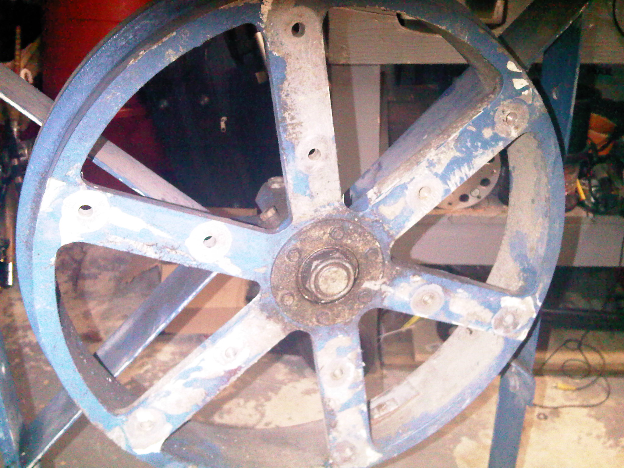

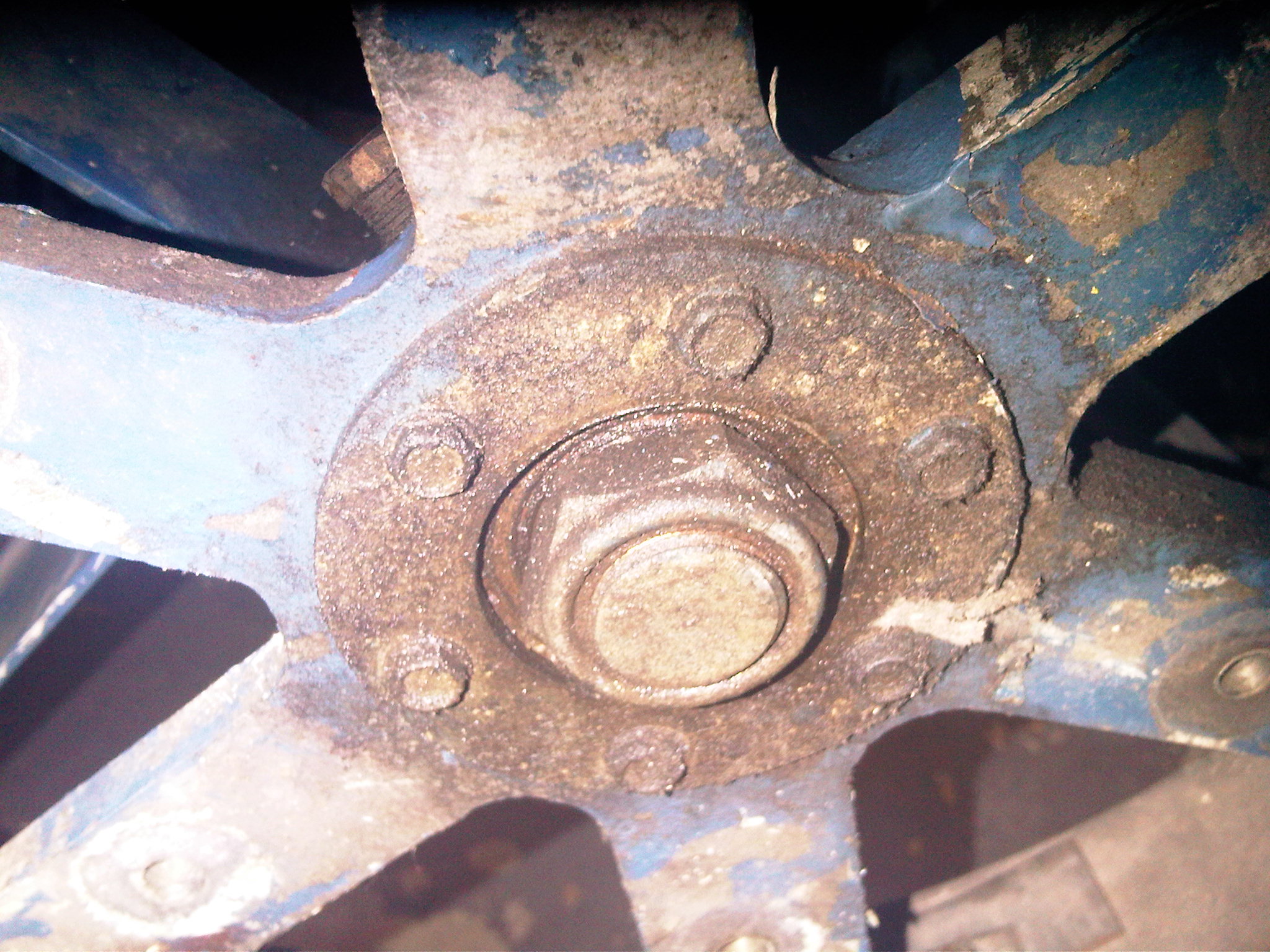

  • Second part of the Machining section of motor done. I took off blades and now I have a nice rotor. The rotor seems to have alot of friction and a little not centered. I need helped of how to clean the rotor and decrease the friction. What is the next step?
    Also, I want to start ordering coils, magnets, and maybe a better bearing/shaft to the back of the rotor to run a large wheel. John, can you pour some of your suggestions?

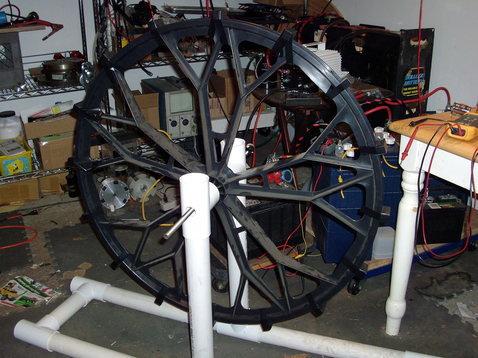

        Was able to get enough shop time in today to put a shaft in a 33inch plastic wheel and attach 16 magnets to it.
        Hope to get time tomorrow to make the timing wheel.
