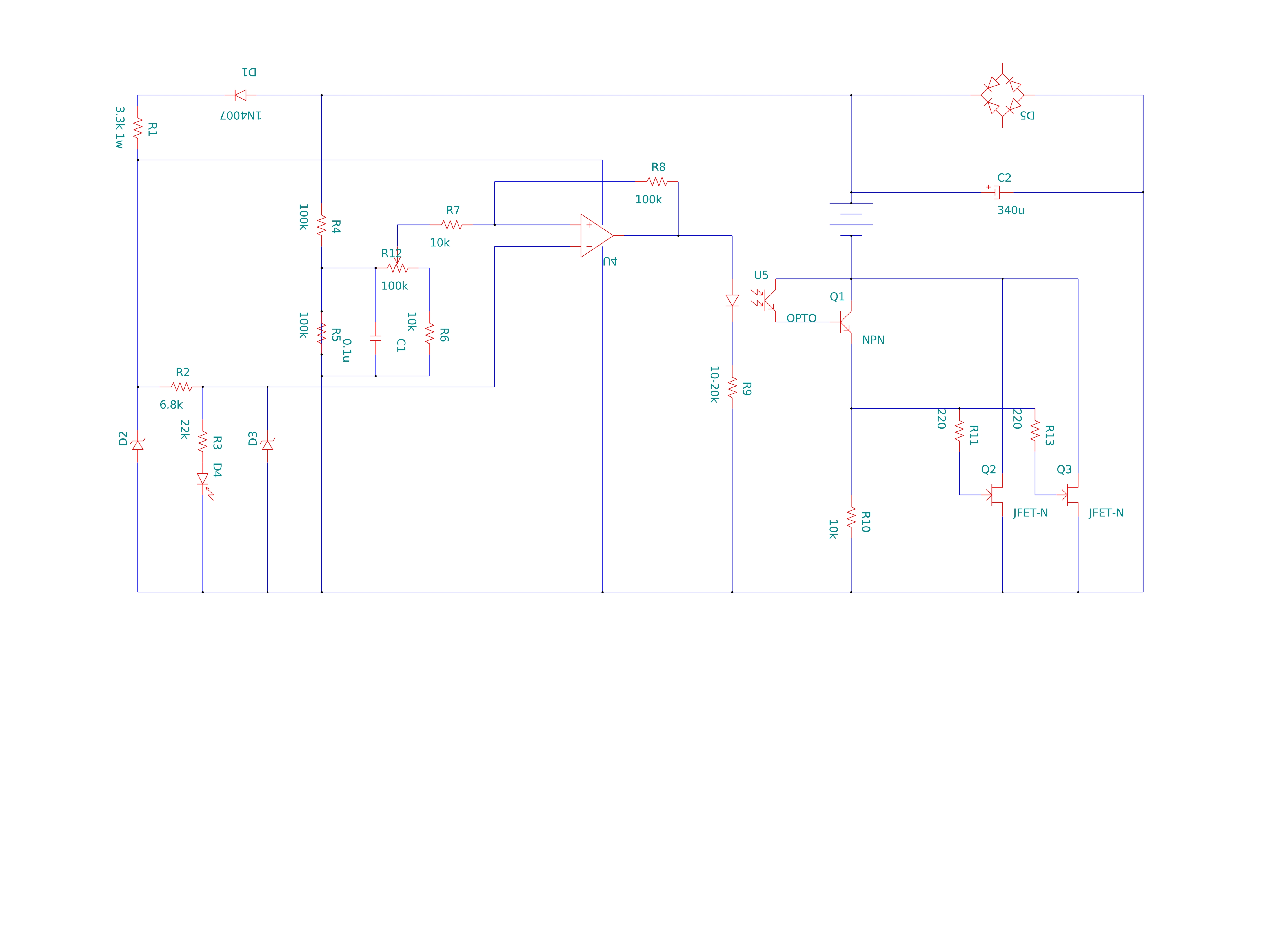

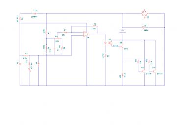

Ok, Got a basic comparator circuit running. Had to go back to the circuit on page 47. Figured out how to change the Transistor and SCR over to fets. I then looked at the h11d1 and discovered it was pulling something like 30ma.
Finally remembered a little electronics back in the old days called darlington pairs.
With a MPSao6 in a darlington with the opto I was able to get the current way way down. I then attacked the Zeners and got them very close to the knee. so I am using a very small amount of power. I was very surprised to find out that I could get a very low current with a larger 3watt 5929 than with a smaller 1 watt zener. Been a long time since I did much analog so it has been a real brain worker.... the circuit is not what I would call stable though. It seems to drift a bit has some misfires and sometimes turns off and starts charging the cap before it is discharged to the battery voltage. Typically about 2 volts of the battery though. Anyway just an update.
