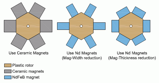

            If are using Neodymium magnets, magnet size do reduce the need for appropriate?
            attachment figure is the introduction of neodymium magnets volume decrease after the hint.

              I can give you a bit of information that might help you decide between the two The weaker the magnets you use, the FASTER the motor will run. The stronger the magnets you use, the SLOWER it will run.
              However torque is the other way around. Stronger magnets will give you more torque at low rpm than weak magnets.
              Think of magnet strength as gears on a bike. Normally a bike has two sets of gears. one on the pedals, and one on the back wheel, right?
              The strength of the magnets on the rotor is one of your gears, the other set of gears is the inductance of your stator coils. The stronger the magnet, (or the more turns you have on the coil) the LOWER the gear. The weaker the magnet (or the lower the turns on the coil), the HIGHER the gear.
              This is one aspect of impedance matching
              ps : if I were to choose between the images you posted, I would go with the last one. You want the poles to be as close together as possible, so I would recommend using flatter magnets with their edges touching. This is for both ceramics and neos with the window motors.
