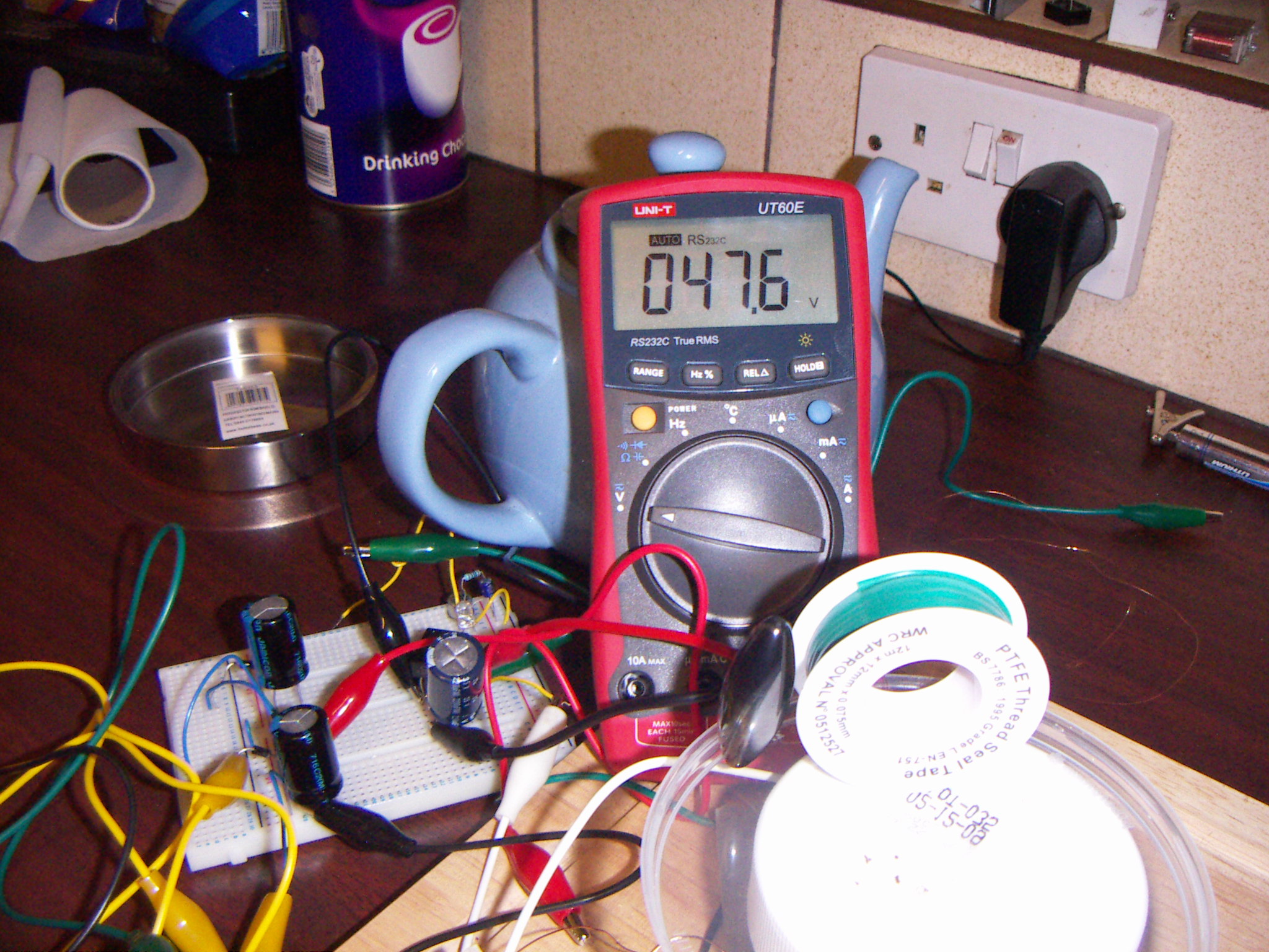

                    @All I have tonight done a test on the 40swg pickup coil at 12v so it will be comparable with the output off Xenomorphs pickup coil and the results were quite surprising.The verticle Magnet is spinning so fast and zooming about at 12v and the output was over 47v and still climbing.At one stage it was over 50v and climbing.There seems to be no effect on the magnets speed from the pickup coil.
                    I did the same test with the angular spinning magnet at that goes up to 48v but the coil has an effect on this magnet and slows it so i think the verticle is the way to go.
                    Here is a pic off the test.Regards jonnydavro

                      @Jonnydavro: Wow the 50 Volt are coming from just 1 pickup-coil?
                      Then it catches more voltage than mine.
                      You are using a much higher capacitance than what i am using.
                      I wanted to keep it low so the caps charge up faster until they can be discharged.
                      What would be your turn count guesstimation on yours?
                      40 SWG wire was that again?
                      Did you abandon the concave Lid? Looks like a flat one on your pic.

                        @Xenomorph.Yes,50v from one pickup coil and it was still climbing.How high it would have gone i don't know as i could not control the magnet it was spinning so fast and it kept flying off so tomorrow i may repeat the experiment with 1 coil and 3 empty spools to contain it.
                        I prefer like you to allow the magnet to bump into the coil as you get a nice voltage jump so i don't use the concave lid.Flat seems better.
                        The cap i used in this test was 2200uf.What size are you using?
                        It seems to charge up quite quickly.
                        Regarding turns on the coil.The answer is i don't know.I wound it with a drill but there are a lot off turns on it.I think if you make one and nearly fill it,you will get similar results if you use 40swg.
                        I Like your cap discharger.It is good that the battery is charging slowly but it is early days,but a step in the right direction. regards jonnydavro
