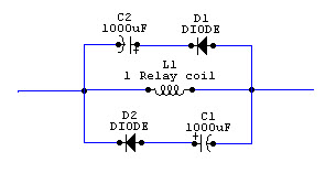

        Hi.I have been collecting bemf from the relay coil in the bedini trigger circuit using a diode and cap and i wondered if you could collect it from both directions and you can.Here is a circuit to show you what i mean.
        Regards jonnydavro

          @jonnydavro
          Have you noticed a slowed down charging rate on the first capacitor when you added the second?
          I have thought about something like that too, but whenever i have tried that before the available radiant energy was evenly distributed over ALL the caps.
          BUT if the charging rate is as fast on both caps as on a single one, then this is a winner hehe.
          Have you tried to parallely connect a pickup coil with a rectifier to the cap too? It was enormously boosting my charging as to be seen in my last vid.
          Do you actually reach a cap voltage higher than the supply battery voltage, because thats where the step charging on my relay coil cap stops at?

            @Xenomorph.The first cap charges at the same rate,no slow down with the second cap connected and reaches voltage's higher than the supply battery.This is why i think you should try running at 4.5v.
            The second cap charges to just under half off the voltage off the first cap.
            The addition off these caps has no effect on the rpm's off the motor.
            I have not tried your paralleling a coil but i will and let you know what happens.
