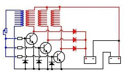

                      • Hi Uusedman....
                        Are you using this circuit?
                        Are we still having fun?
                        Todd
                        • Yes, same circuit however, 1 slave.
                          I am always having fun with this. Had to take a break from the Rotary Attraction Motor. Want to first build a reputable Bedini before moving to the Lindemann Motor.

                              Hi uusedman,
                              You have to adjust the trigger circuit resistor value every time you add another power wind. It's probably been said before, but you sould be aiming for around 250mA per transistor (for MJL21194 type), so that's 750mA total input current for the three.
