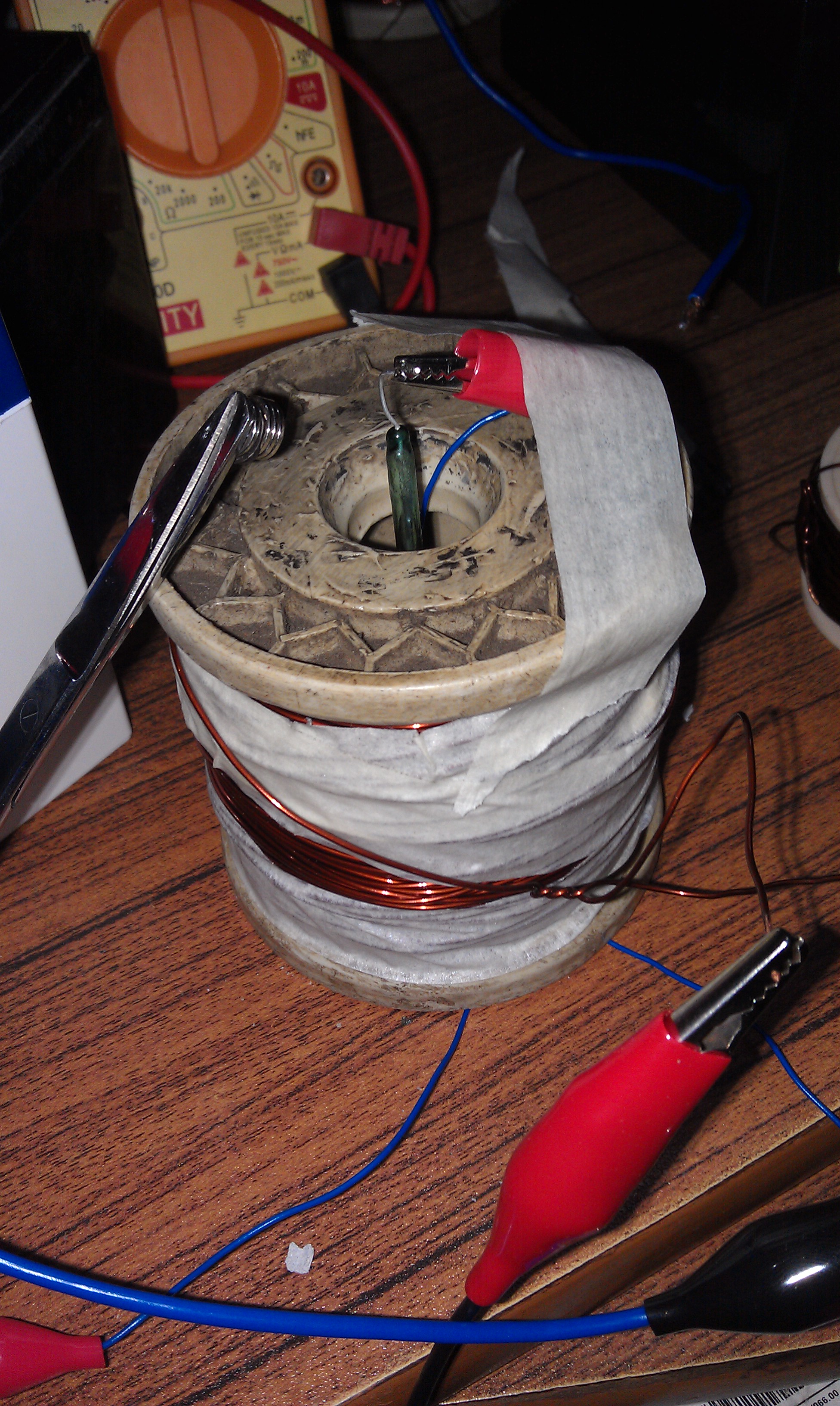

    Today I discovered a new way to do the oscillation the circuit by using just one reed switch and magnet, its giving awesome results and charging battery wayy too fast while current load is still at minimum. I am not sure if someone else have done this too but I am sharing it with you guys anyway.
    I am attaching a rough design of the circuit as well as real pictures of my setup.
    Here are the steps to explain what is happening.
    1. I am using a Single core with air core. I tried with iron rods/welding rod but results are better with air core coil. (Using #20, ~600 turns)
    2. Circuit is same as SSG one, http://rpmgt.org/Schematic2.jpg
    3. I take out the trigger coil part and join reed switch with transistor base via a resistor. the 2nd end of reed switch is attached to +ve since I need a positive trigger to activate transistor.
    4. Put reed switch within the coil so that its vertically half way inside the coil while its top (40% part) is still out of the coil.
    5. Now take ceramic magnets or small nyodium magnets and move them nead the top of read switch. Find the position where you get a constant beep, this is the location where ossicalltion will start. You can move the magnet near/far to control the input current and oscillation frequency.
    Here is whats happening with reed switch
    1. Strength of magnet is very low, just to activate the reed switch. Once its activated, the circuit is in ON state hence transistor charges up the coil.
    2. When coil is charged up, it creates a magnetic field, which is opposite to the magnet pole that is facing towards reed switch, And this electromagnetic field is way more strong than magnet. Hence its turns off the reed switch by pulling it opposite side.
    3. When reed switch is OFF, the circuit is OFF, hence coil collapse and radiant is captured in battery, but at the same time the magnetic field of magnet is now stronger because there is no electromagnetic field here any more, SO the reed switch is ON again and Coil turns it off once charged
    **Note, You must place the magnet facing opposite pole towards the coil, you have to find out the exact pole that activate oscillation, e.g if coil is charging up as South pole, the magnet should be facing North towards reed switch
    Above three steps are repeating again and again with a very high frequency, probably automatically adjusted. It gives very sharp pulses and very much strong voltage output. I can get purple light on reed switch all the time but this may blow out the transistor within seconds
    I hope it'll help others, I've tested it successfully and its working great more better than mechanical and Pulsed solid state circuits..
    /Imran

      @ewizard,
      I did the tests whole day and my reed switch did not go bad, If reed switch is good as compared to input current then it will last longer, if it goes bad it will stop giving you beed sound (tick tick tick but very high rate so it looks like beep sound..
      Yes I did not use any wheel or any kind of other mechanical parts.. its just the coil and reed switch sitting in between coil core.. the magnet position is very critical, you have to find where it make contact to reed switch and it should be far enough from reed switch because when coil is turned on, magnet and coil's poles are different so they'll attract each other.. it should be far enough to just turn on reed switch..
      I am using MJ13009 transistor, i could use 2n3055 but its not for that high frequency i guess, 13009 giving me good results
      transistor will blow up only if you keep the output connections OFF from battery (so neon is keep glowing).. this will heat up transitor..
      when Connections are made with output battery, the transistor is cooler than room temp so the coil and battery are
      the reed switch turn on/off on/off with frequency that circuit build automatically with coil.. high number wire may have low frequency because electromagnetic field is low, while low number wire(thick) may have higher frequency and more output..
      I am charging a 12v 10ah battery with input current of 12v at only 130 milli amps and it charges up within an hour while when I do a load test i can run it longer for load > 200 milli amps..
      I dont know if it goes overunity yet but i'll have to perform more tests

          As I said, I am using exactly the same circuit that this page have (http://rpmgt.org/Schematic2.jpg i.e orignal Bedini SSG) but instead of trigger coil and mechanical wheel, I am using a reed switch..
          It'll still work if you put reed switch out of the coil but close to the core.. the working of this method is in strength of REAL magnet and the distance of it from reed switch..
          I am using 100 ohm resistance from +ve to first pin of reed switch and then 100 ohm from 2nd pin of reed to base of transistor.. so in total transistor gets 200 ohms + resistance of reed contacts.. because it varies depending on magnet position..
          If you directly use a reed switch instead of transistor it'll not last more than few hours due to high current passing from contacts.. I tried this method too but it just burned out reed switch..
          with Reed switch inside coil and having a small strength ceramic or very tiny nyodium magnet, I could switch it for hours without any flickering in input current, the spike voltages are 300+ and neon is glowing bright purple when I take off output battery
          /Imran

                @Bob Smith,
                No Wrong, I did never say that I am generating radiant from coil core, and in the video ufopolitics have used a Pulse generator..which I did not..
                I am just using reed switch as a pulse generator rest of the circuit is exact copy of bedini oscillator with a transitor,resistor,diode,neon,coil... it works 100% same as Bedini said but instead of trigger mechanical mechanisim, I using coil's electro magnetic force+REAL Magnetic force combination to make reed switch on/off on/off at higher level to turn on/off transistor, thats it.

                  I am still running the circuit since 2 days and Reed switch is still vibrating without any damage on it.. and batteries charge rate is awesome..
                  I am trying it with multi coil now to achieve better results since the triggering is automatically done all timing is done by coil itself..
                  if anyone else have did this experiment please share results
                    Resistance will not vary depending on the position magnet but duty cycle and frequency will. The nice thing with this setup is that you dont kill the reed switch and you also produce very sharp square waves which are essential for high voltage spikes. I am wondering if this could be done with a low rds on mosfet.

                      Yes you are correct, the dutty cycle and frequency changes on magnet movment, but there are two points when it does not work, one is far away from reed and 2nd is too close to reed switch..
                      I dont have scope yet but i'll do tests on waves later, right now i am getting good results, charging 10ah battery with 300+volts and current drawn is only 100 to 200 milli amps..
                      I can charge a 1000uf 100v capacitor to 120volts within a fraction of second,
                      i dont think there will be any problem with mosfets as you have to trigger it the same way as bipolar transistors? the reed will give a continues pulse triggering same as you achieve with 555 but with reed you can except whatever current you require to switch on transistor and with minimal parts

                              Thanks for replicating my way, now I know it really works..
                              I am not sure about the frequency but higher/lower frequency can be obtained by moving magnet close/far from the reed switch.
                              I did tried few steps,
                              1. One coil, one reed switch one circuit, Anotehr circuit and coil is using same trigger, so two coils one trigger.. energy output is good
                              2. Two coils, two separate circuits with two reeds one in each coil.. it produces way more energy than #1, I recovered a totally dead battery in two days (12v50AH) and can charge up batteries quickly..
                              current reading of my setup was around 200-500 milli amps because I am using a higher AWG wire (#20)
                              So this method giving higher output with lowest current usage..
                              You seems to be using a tiny reed switch, it may not last longer, I have a double sized reed switch than yours which is running constantly from last couple of days..
