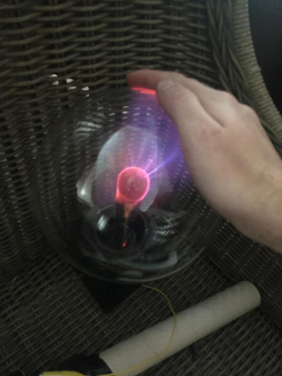

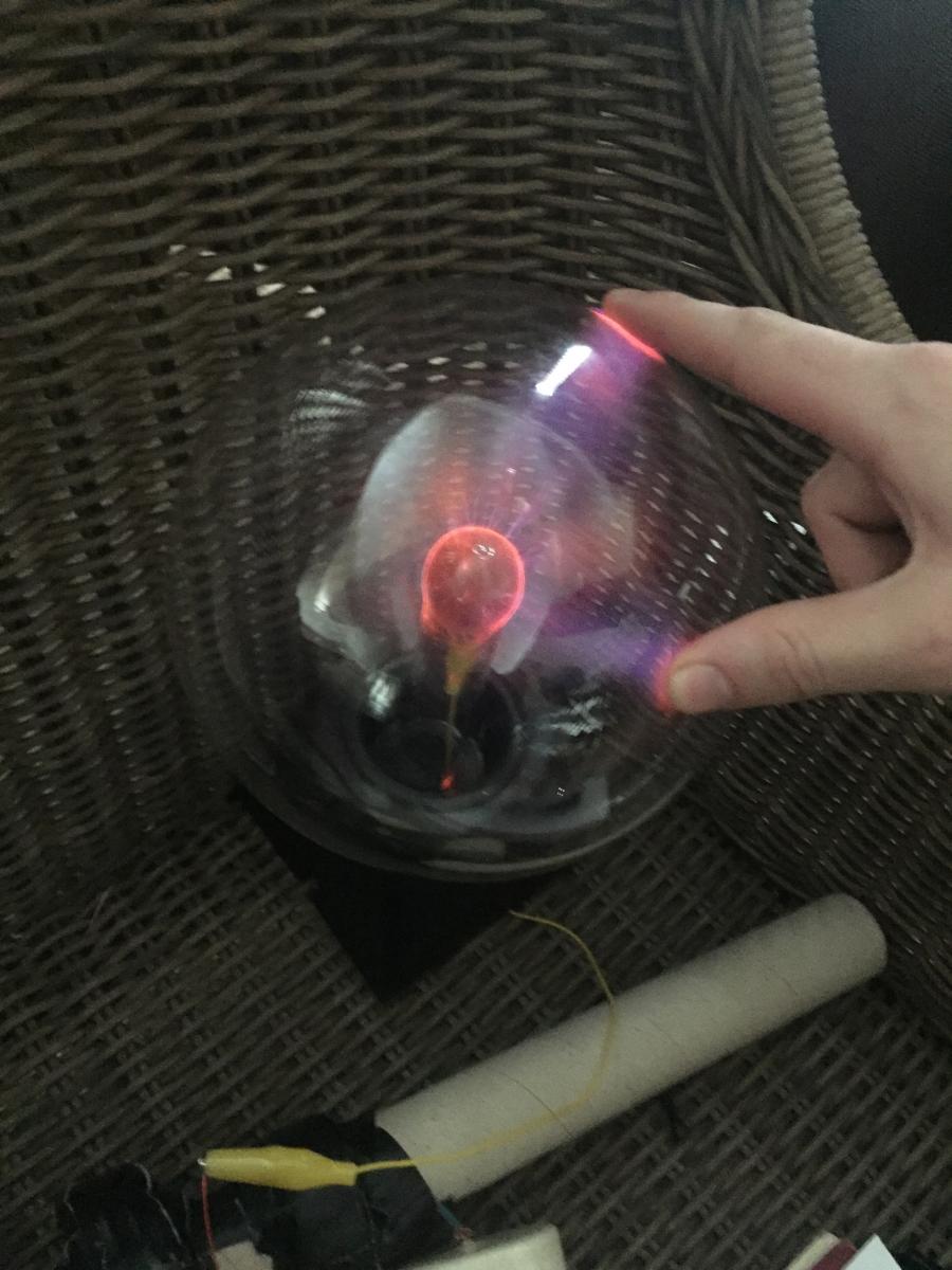

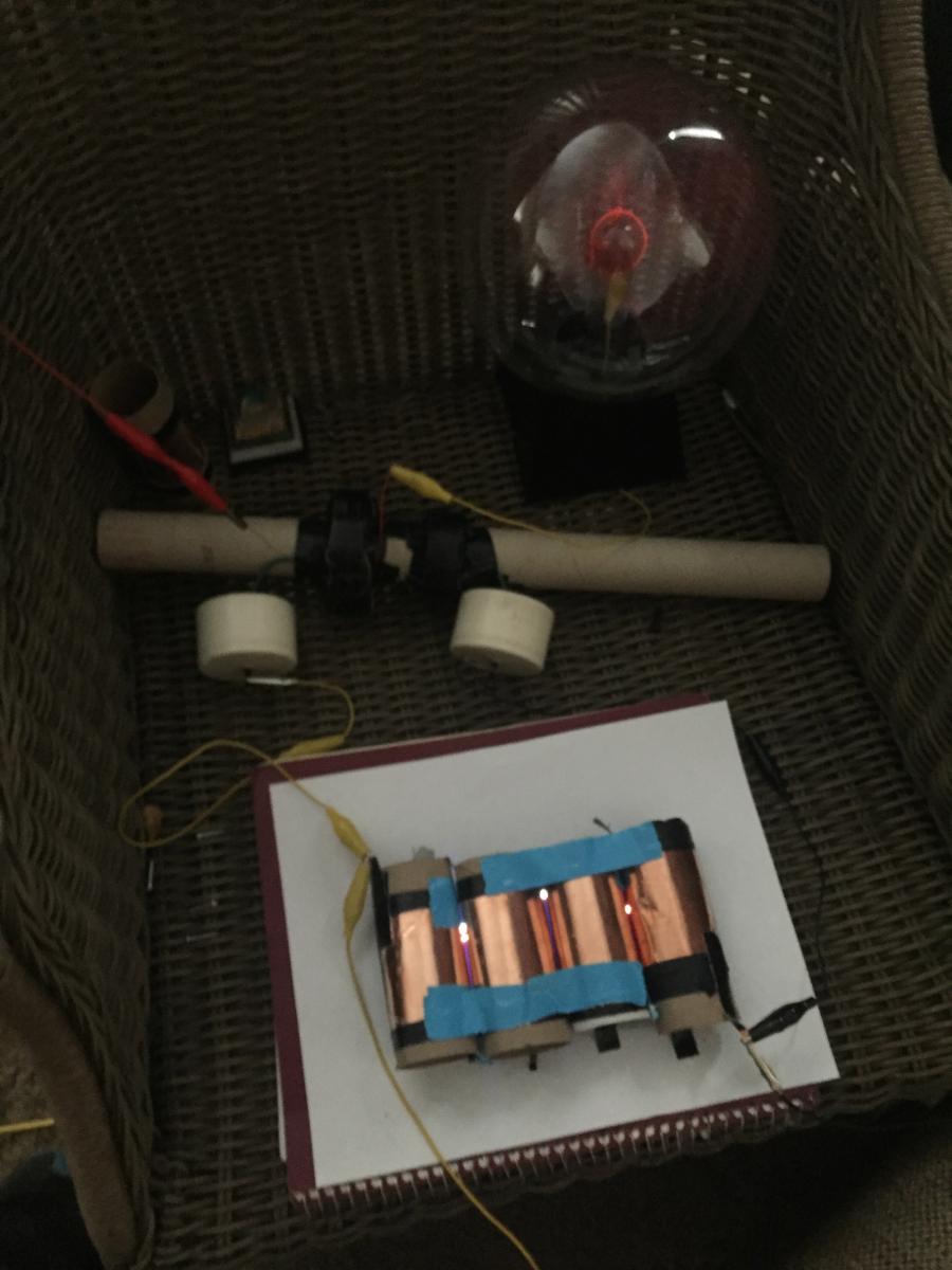

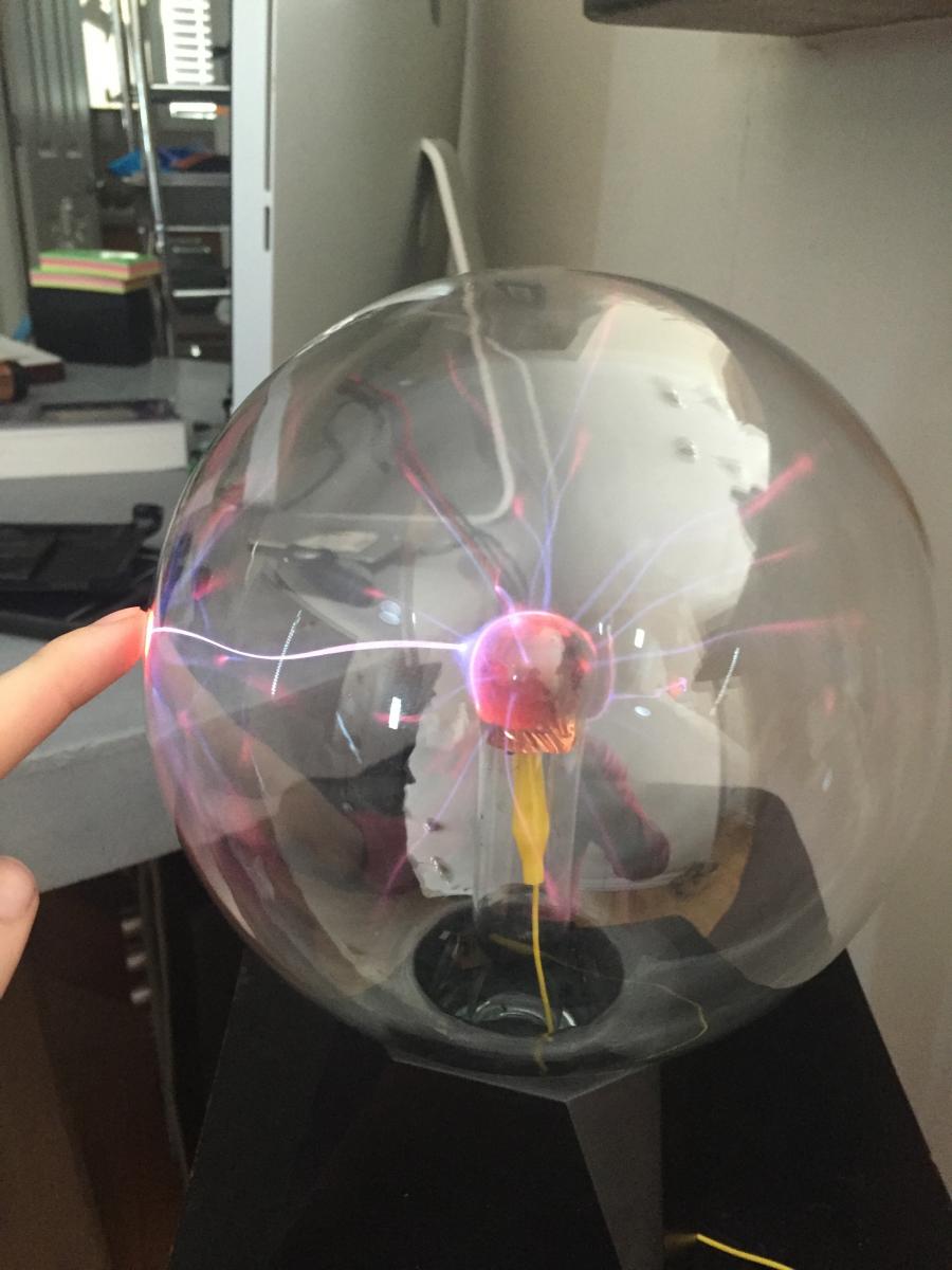

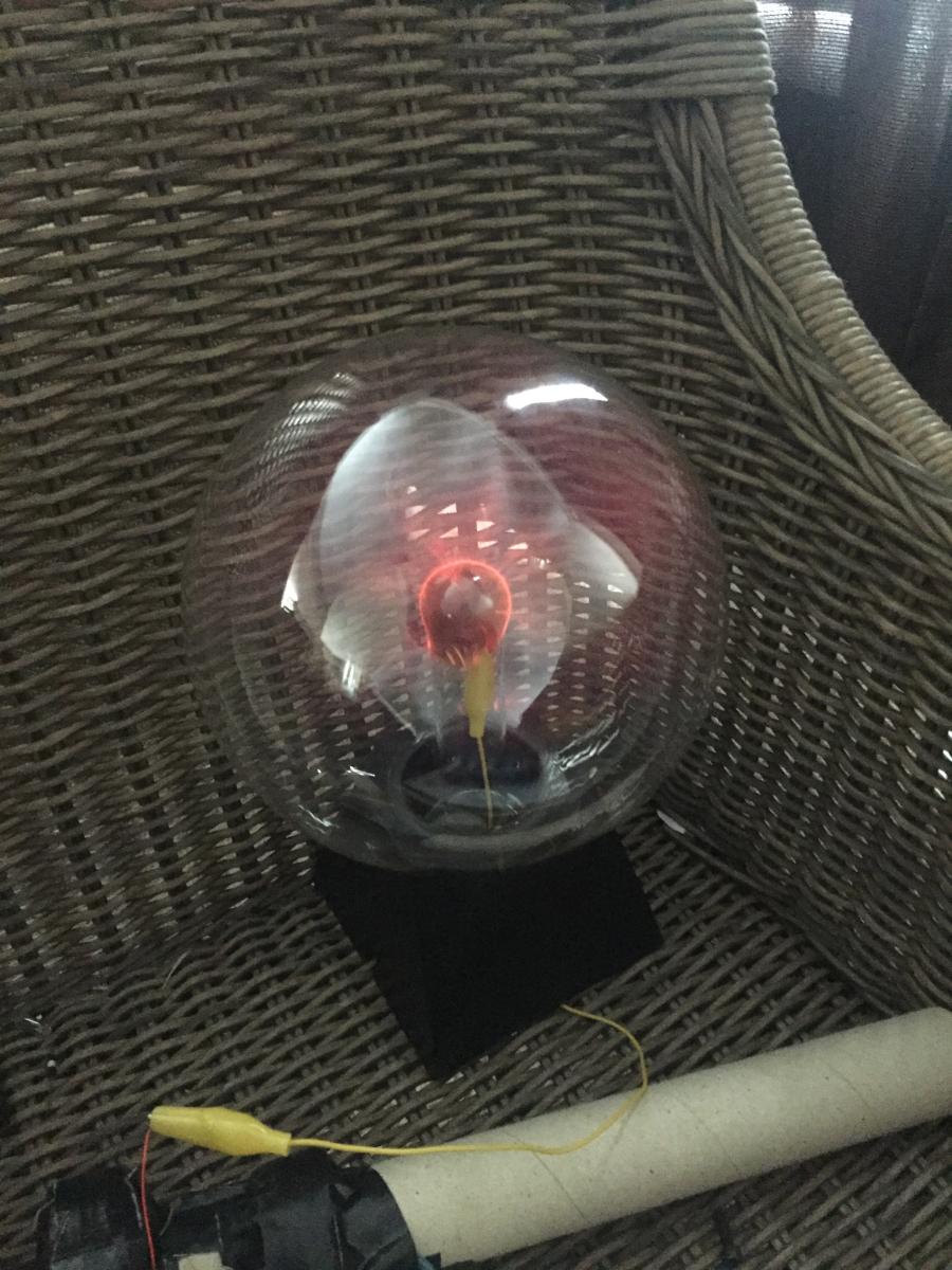

              Hello again,
              I am in the process of rewinding my secondary and I decided to stop halfway and test the insulation and to determine the terminal voltage of the secondary windings. I am getting several kv out of it (as one might expect from a 50kv induction coil). I decided to see how the plasma from a dielectric barrier discharge would look in comparison to a solid state plasma globe driver in which the secondary is grounded to one side. I grounded my secondary (which is about 106 turns which makes it a 1:5 air core transformer) on one side and connected the plasma ball to the other. Here you can see the photos from the plasma. One of the photos was taken with the solid state driver for comparison. That is the one with the thin streamers like a regular plasma ball.
              In another photo you can see the multiple spark gap I am using. Using the distance of the air gap as an indication, I would say the induction coil is operating at less than 20kv.
              One note which I found interesting is that my finger got much more hot when I touched the tesla coil powered plasma ball.
              It is also interesting that the presence of defined streamers practically disappears in the tesla coil operated globe.
              I would love to see some other people try this out with their coils so we can catalog the plasma effects and perhaps determine the plasma indicators for proper 1/4 resonance. I think the whole globe will light up brilliantly white with a properly tuned coil.
              BTW, I bought this 7 inch globe for $30. Worth every penny.

              • Here is another couple of photos of the Tesla coil operated globe with me touching it. The more brilliant colored one is with me touching the ground simultaneously.
                Please note that the plasma is much more luminous in person.
